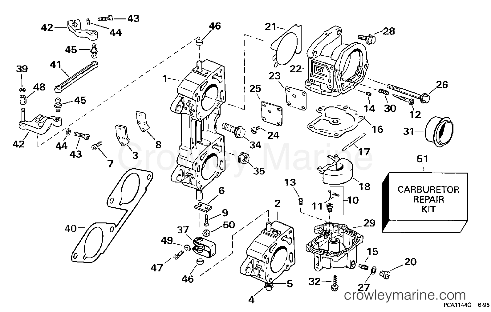

Im rebuilding a set of carbs, the old needle set doesn't have the white seal, but the kit includes it. I just readjusted the float. Does it matter as long as the is set?

The nylon washer under the seat is OEM Evinrude. Included in float valve and seat assembly- 0396522
While you could probably get away without them, personally I would go back and install the washers as intended. It only takes a couple of seconds to adjust a float and it gives me the piece of mine that the carbs are assembled as designed. No second guessing yourself down the road

Leave the plastic washer out on the plastic carburetor.----And the washer is NOT shown in the parts diagram !
Is it not part of item #10 assembly?

??----Look at some other typical carburetor parts pages.----Metal carburetors and see the nylon washer CLEARLY shown.

I used them, set the floats, the float has plenty of travel up and down,
