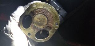

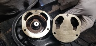

I have read through everything I could find on here about the VP raw water pump issues people have dealt with on the SX-M platform and I think i have exhuasted all options save for replacing the entire pump. The only thing i can think of prior to that is to "face" the inlet/outlet plate as i has a tiny amount of wear. When I replaced the impeller i didn't think that small amount of wear would stop it from working at all? I put clear tubing before and after the pump and can clearly see it is not sucking water and pushing through the pump. I connected garden hose to inlet side to lower unit and it flows freely so no blockage, and I just replaced the seals for the copper tube which was perfect as well. Anyone else run into this issue with a new impeller?20210402_191016.jpg20210402_190714.jpg20210402_190740.jpg20210402_190925.jpg

Dress the face and the cover

I also faced both sides of the pump with no change, I even clocked the pump on the bracket so the inlet/outlet were at the top instead of bottom.

We just replaced impellers on the same type pump and we had much more wear than you show. We were going to re-face both sides, but we weren't sure about tolerances and didn't, we just put in the new impellers and they seem to pump just fine. I did use a little sealant on the back plate as I was worried about air getting in. We are in a wet slip and water constantly flowed out of the hose when off, so it was primed with water up to the pump once I put the hose back on. Here is an album of pix that shows the wear we had: https://photos.app.goo.gl/fa4ScoXhvASQwhCJ8
Good to know i appreciate your response. I was wondering if i used the wrong seal as it came with two white seals and one paper seal. I will try some sealant to see if it is a sealing issue. If not im going to bite the bullet and buy a new one.

Well i swapped the gaskets and put some aviation sealant on either side of it and slapped it back on the boat. I put both ends of the hoses into a bucket of water and poored some water in the hoses to prime the pump. I fired it up and immediately got some movement of water! After about 10 seconds it was really moving the water at idle. Now i am going to hook everything back up and see what happens.
