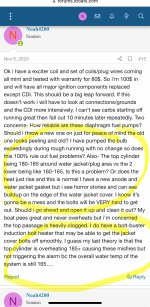

OMG!!!! I tested the thermo switch for the heck of it today and it was not working on the panel, so I confirmed that signal was getting up to the helm and ground and it was and it got me thinking about the CDI again so I decided to go ahead and pull it off and test it. IT FAILED EVERY SINGLE TEST miserably like we’re talking 5000 to 8000 ohms when it was supposed to be 10 to 500 some of the legs didn’t even have continuity. I’m surprised the boat ran at all. When warm i bet the measurements were off the charts! I guess because of the unavailability and cost I avoided testing it (also thought it would only show bad when hot) because I was also told from a lot of pros that they’re very durable and rarely fail, but this one is absolutely trashed. CASE CLOSED. Thank you so much MATT! A year of hell is over. My intuition this whole time has been CDI. I’m going to source one and get back on the water. I did see a place that looked to have a new one for like 550$. OUCH 🤕
Noah4200
Oct 17, 2022
90
I bet my the old flywheel magnet delamination contributed to the CDI failing. Sending junk pulses into the circuit with each strike. So if you have magnets hitting better address it ASAP

Just for clarity…ALL my measurements on the CDI are showing 4-5 MEGA OHMS. The honda specs call for 5-500 kilo ohms. So we are out of spec by a factor of 10X!!! A few legs don’t even have continuity! These legs look to go to the front helm control and I believe this is why the warning buzzer doesn’t work as well as intermittent overtemp. I jumped 12v and buzzer is fine and shorted temp temp sensor and NO red light even tho signal and ground are good at the light plugs.
Hoping that it runs better than ever and warning system functions. With the 10x resistance at room temp on the Power control circuits i bet it’s gonna feel much better :)

CDI will be here friday. Paid 250$ but got the nicest one on ebay and from a 100% seller. I put the new fuel pump on today. After testing old one with less than 5 psi like on danger marine it developed slight leak near the corner security bolt so i’m glad i swapped it too -probably was close to failing. If i ever wanted to manually clean out my head passages to get 100% original cooling back do you think the head bolts would be as bad as the water jacket bolts? :) Or are they more stout and less prone to corrosion?
