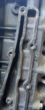

Got it back on! It’s just a hair more to the left bc of a few holes drifting but not enough to cause issues. If you didn’t see it before you would never know. The oring has plenty of wiggle room on the mating surface. That whole ordeal sucked but have a fresh anode and jacket is cleaned out
