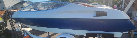

Well, still atter. Painted, floor is done, just bulk heads, seats, sides and front seats to do, glass it in 1000021218.jpg1000021219.jpgand fill with foam then foam flooring.1000021221.jpg1000021222.jpg1000021220.jpg
