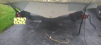

Keep in mind that the back and sides of the transom were glassed before I installed it. I left the face out unglassed so I could glass it to the hull, that's why it is bare plywood. Underneath and the top were also glassed before I applied peanut butter. I have the before glassing and after pics.

Baylinerchuck
Jul 29, 2016
2,740
Yep, you really need smooth fillets for the glass to conform. I assume that you have the naked plywood a drink of resin before glassing.
You can grind out those bubbles with a dremel tool or small grinding wheel and fill like you said. Ive also seen folks drill a small hole and fill the void with resin from a syringe.
You’re making great progress.

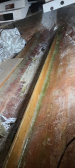

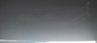

Transom done. Boat sanded, so much sanding wow, weeks of sanding! Almost ready to get these on. Just waiting for some cooler weather.20210818_173400.jpg

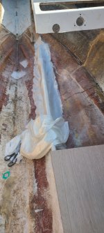

GongshowBayliner92
Oct 15, 2018
43
Finally got resin. And started the stringers. Peanut buttered'em in and added a layer of chop then 1708 then chop thus is midway through. Too hot to do anything during the day the resin hardens too fast.
