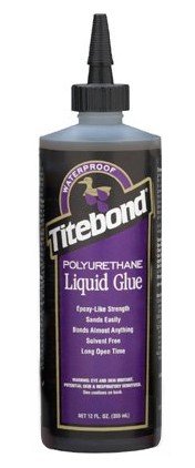

Another option to the TB III is what I use, the TB poly.
