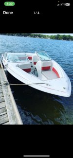

Hey everyone I’m new to boating. I bought a 1991 Chris craft concept 167 with an inboard 3.0 cobra. When I turn the key the engine doesn’t crank over. I have to take a screwdriver to the starter to get her started. After I do that I can turn the engine off with the key and start it with the key ? Some days I can just start it with the key some day no. I checked for loose wires at the ignition and the engine and everything seams tight. Any ideas what may be happening. Feed back is appreciated.

BTW nice-looking boat, good catch and welcome to the world of boating! Please consider taking a boating safety course if not already done and have all the appropriate safety gear.
