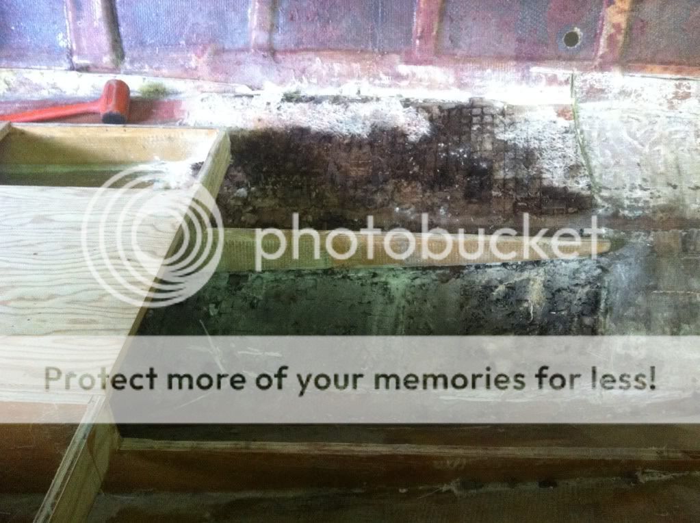

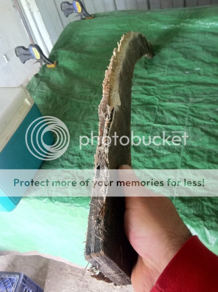

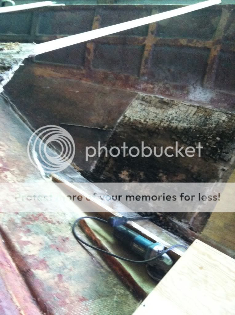

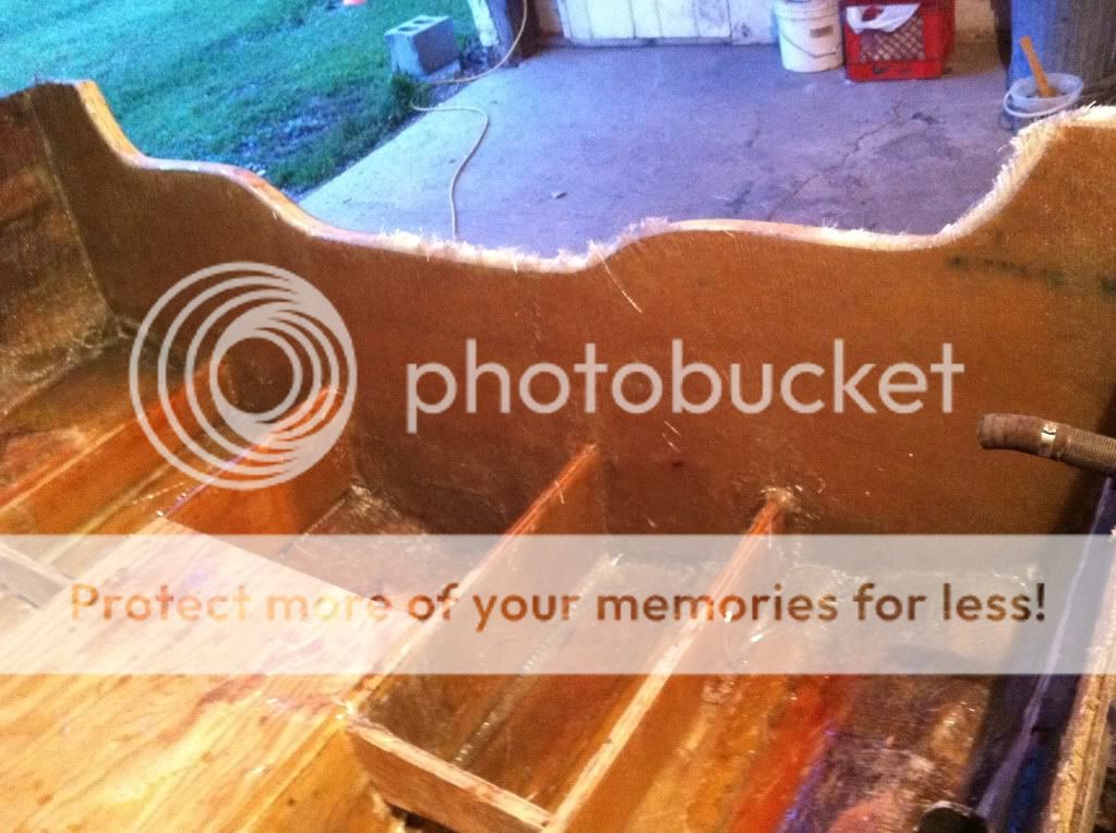

Finally getting the balsa replaced in the bow of the boat, feels nice to get sprayed by water squeezing out of the nasty balsa @ 95degrees out. I was grinding around the keel eye bolt wooden block and had water run out from under when I broke the seal. Ripped the wedge out and it appears to be pine? It was starting to rot and was wet but the major issue found was a 3/8" gap between the keel and the very tip of the block. I don't think there's supposed be a gap correct? Prob why its cracking the gelcoat and moving around. And what type of wood should I replace this with? Stronger the better or keep the rot resistant thing in mind? TY for helping! Oh yea, look at the eye bolts nuts, the decayed one was on the keel. Gotta love factory hardware, its bs.

It's not so much the wood as it is the encapsulation methods. If it's properly sealed where water can't get to it pine is ok. Douglass Fir would be better. Make sure you fabricate the new block to conform to the shape of the hull as best as you can and then coat it with epoxy and then bed it in thickened resin and chopped fibers when you reinstall it. Make sure to coat the holes and the bolts with epoxy or 3M 5200 sealant as well. If you do this, you're pretty much guaranteed that it will last 40+ years.

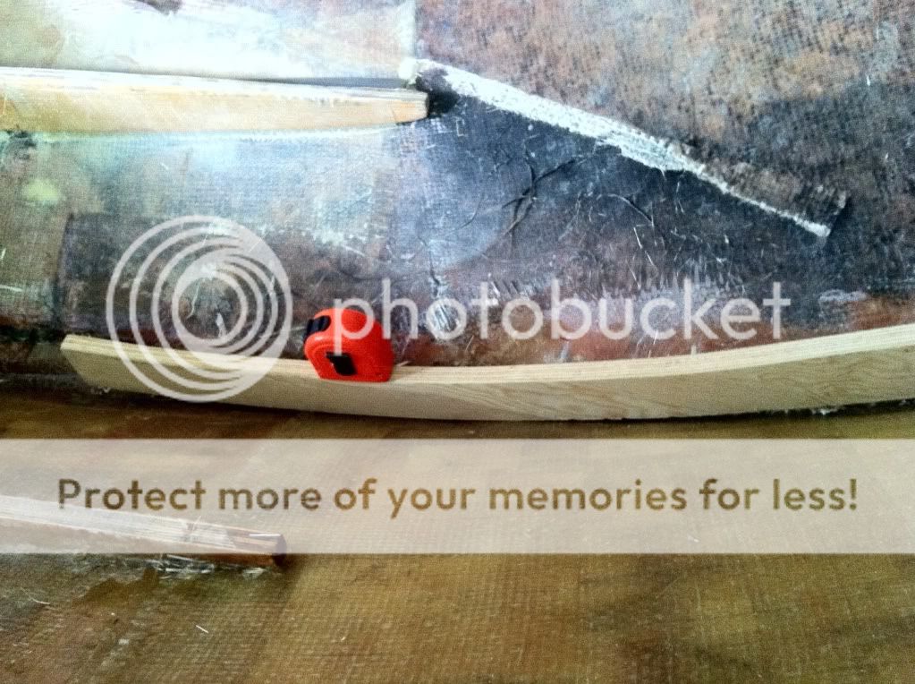

How should I install the front keel stringer? Originally it was tabbed off the hull in several areas and on the ends while other area where bedded to the hull in 3/4" resin glass due to being closer to the hull, in those areas the glass and resin built up and resin ran underneath it to connect it to the hull directly. I had to grind 3/4" resin/glass in the keel to get the balsa core material flush up to so I could lay glass with no step there. I could not tell if the roven woven originally on the balsa core went under the keel stringer or was lay'd onto it, there are two layers on the lower of the keel stringer but hat could be from the balsa or a first tabbing then a second wrapping the keel stringer completely in one piece of glass. I'd put pics on but it will not let me.

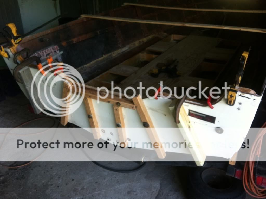

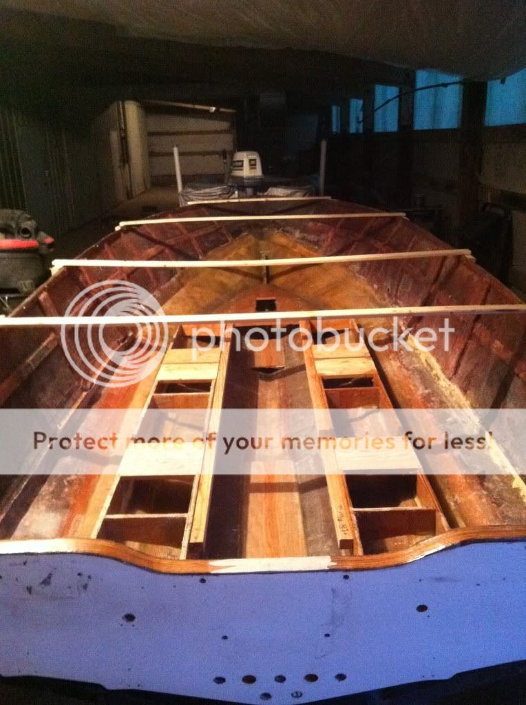

I'm doing the balsa core on the other side of the boat before I put the stringer back in just incase you noticed the black in the pic

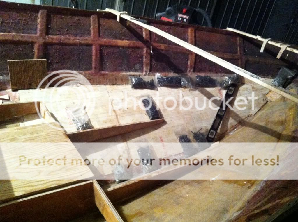

Getting close to putting the top back on.
3 layers of 18oz 1708 to duplicate original thickness.

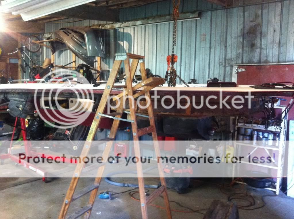

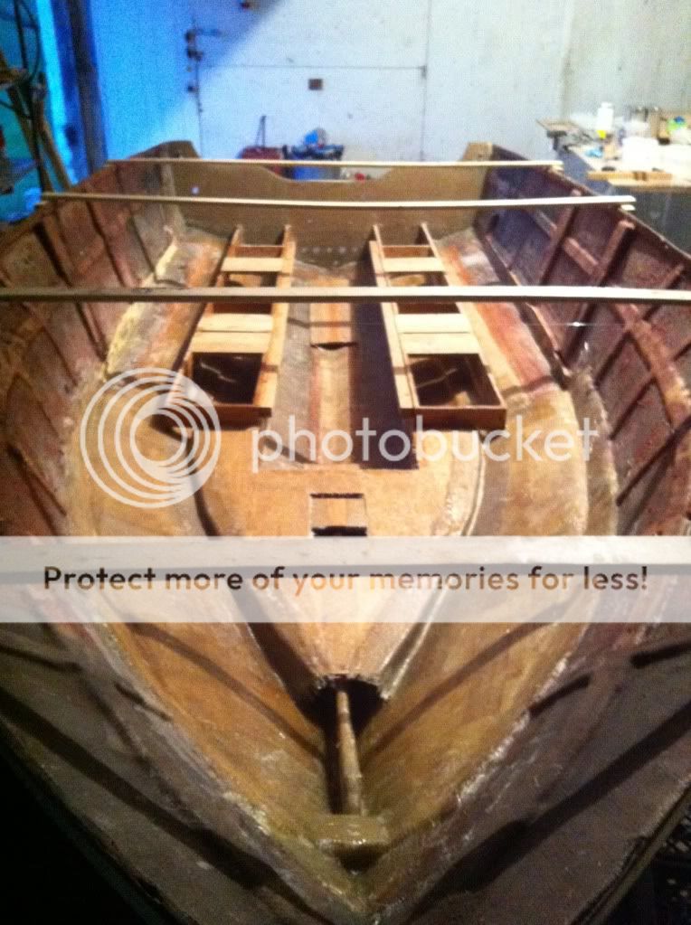

Getting close to carpeting the interior now! Foam will be fun tomorrow.

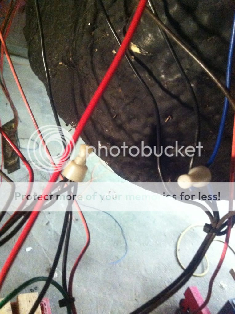

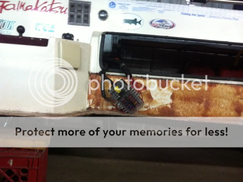

Ended up re-wiring a lot of the electrical on the top half while I have a good position to work.
Found 17 ground wires in three different crimp style wire nuts that all fed back to the battery via one 16 awg ground wire.
I added 47 feet of new ground wire individualizing grounds/replacing black burnt grounds, and re wired all new green strapping wire to the filler neck-tank-gas gauge-ground which I found cut inspecting everything.
Updated the fuse box and individualized a lot of the 12v + wires as I also found those in groups of three or four in a crimp wire nut powering multiple items off one fuse.
