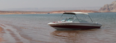

Hey y'all.
Been learning a ton from this forum. We've owned our 1990 Four Winns 190 Freedom for 3 years now, and have loved every minute of it. My mechanic recently replaced the fuel pump, and we want to replace the deck before this season starts.
The only thing I am having trouble understanding is how to attach the new deck to the stringers. My understanding is that any hole in the stringers presents a risk of them being exposed to water. That said, can a new deck just be glued down as opposed to secured with glue and screws?
Thanks for any advice in advance. Hoping to do this project right, and have a deck that will last for many years.
Pictured is our beloved boat at Lake Powell (lucky we got to experience it before it started drying up). I'll be sure to add pictures as we begin the deck restoration process!
