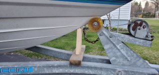

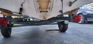

One question I have at this point, my boat sits on a roller trailer. I understand that I shouldn’t redo the stringers while on the trailer due to deforming the hull. How should I block it up and assure the hull is in proper shape before installing new stringers?

I didn't have the space to build a cradle so I supported the hull where I assumed it wouldn't flex but, in my rebuild I didn't remove the cap so I'm not sure it would be suitable for you.
I can say that it had been said take measurements on everything and possibly bracing so your sides don't splay when cap is removed.
