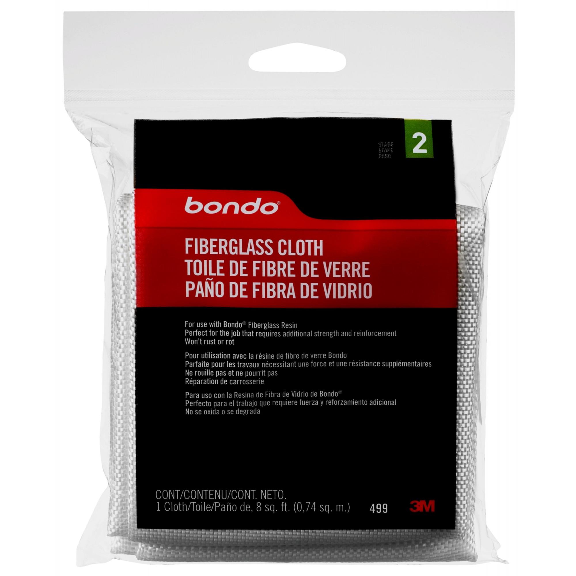

csm blows to work with try out the HD stuff just for fun. Its a no brainer.

HD has the auto glass from bondo like 6 oz. draps right on. CSM is a pia to me.
