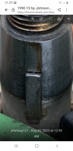

Pitting at the top of the crank and is this top part of this a part of the key look at the picture of your flywheel you have a misshapen sharp point
