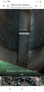

I still think the woodruff key is not meeting the flywheel properly on this image I can see a gap between the flywheel to the key

39,256
???----You will always see that " gap "----Was there from the day it left the factory !!
