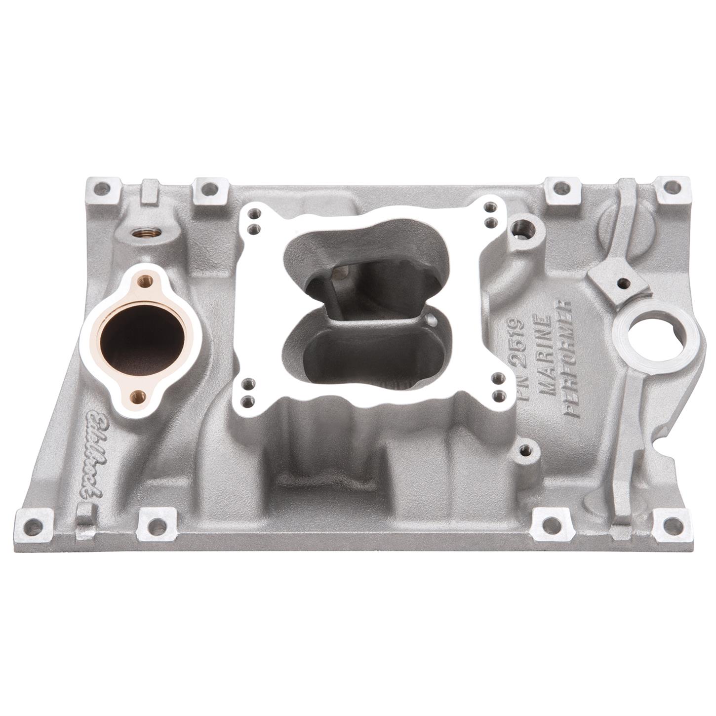

Looking at their site in the parts section I can see that is true for the V8s, but for the V6 which is what I have the only option is the original GM style intake unless you go to an Edelbrock alu intake.
I am still thinking of replacing the old Quadrajet with a brand new Edelbrock 1409 I have in the garage so this is something I'm researching now. I looked on their site under the section where they sell turn key engines and all the 4.3s I saw, seemed to use that thin Edelbrock plate. Probably because there is no dual pattern cast iron intake for these as far as I know.

About the intake yes it is a Pre-Vortec engine (1988) 12 bolt intake, there is an Edelbrock intake that would have worked similar to that one but it won't fit with the OMC/Volvo high mounted alternator. So I am limited to the old style cast iron spread bore intakes.
If I switch to the 1409 I have to use a bracket to move the OMC shift linkage bracket which bolts to the 2 last manifold bolts on the starboard side. The Q Jet fits fine and even the Holley 4160 will fit but the Edelbrock is just too wide. I tried that Holley 4160 a few years ago but it gave me fits too.
