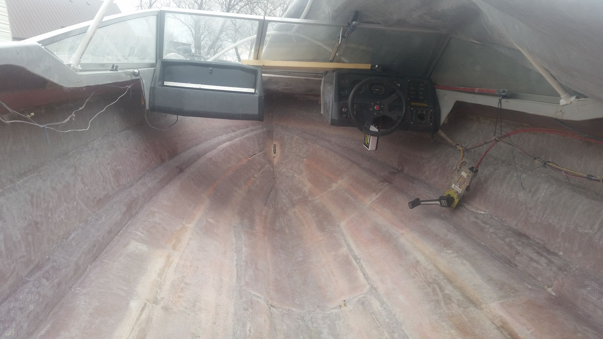

This Wyoming weather has has tossed a wrench into things. Didn't have a cover on it and it filled with snow. Got the snow out and got snow the next 2 days.
Worked on it yesterday and today some. Got all the rough stuff sanded down up front and got the rear cut up and most of the floor sanded down. Still need to remove some gel coat and scuff the rest of the hull where I will be laying glass down. The Transom will be cut out next week and hopefully the rest of the inside will be completed, or near completed and ready for reassembly.
Got materials showing up this week to start putting it back together. Just need to wait till it warms up a little more since were still barely hitting 50 degrees.

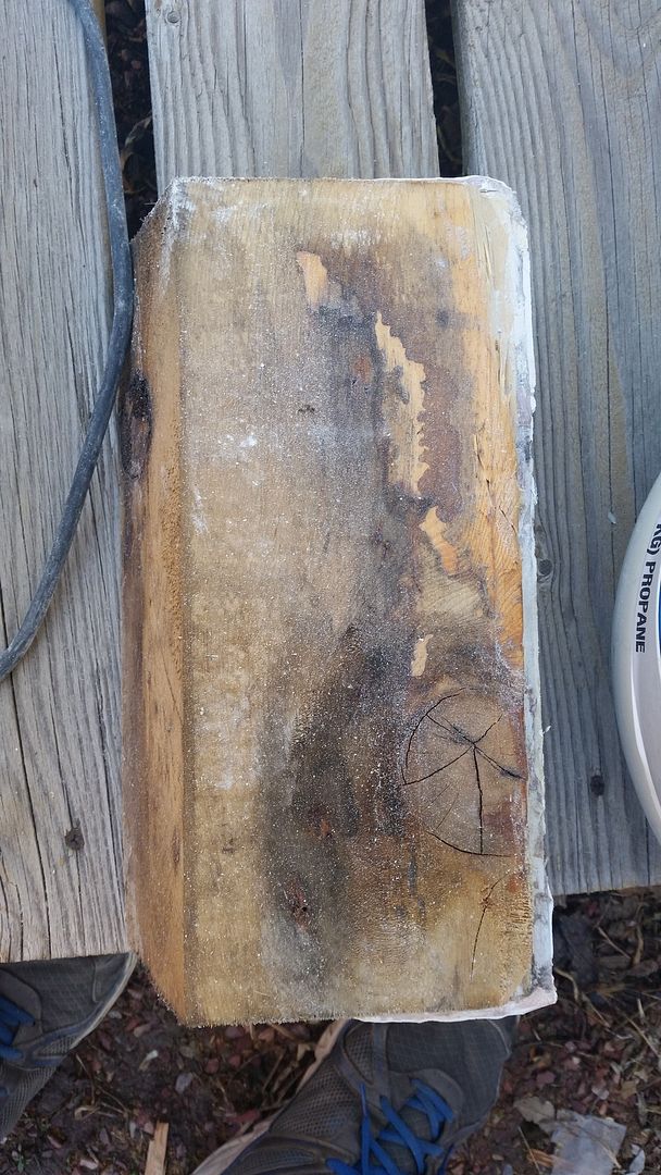

Motor mounts were soaked with water and the runners towards the rear were also soaked and started rotting but not too bad yet. Be interesting to see how the transom is since it looked pretty sofa at the bottom when I pushed a screw driver in it.

The lower 1/4-1/3 of the transom was rotted out. I'm glad I decided to pull it and redo that as well.

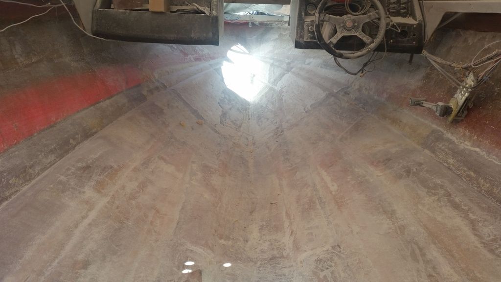

Finished the sanding and grinding. I hope to never see another grinder again in my life time. That was by far the hardest part of the whole job so far. I have the inside vacuumed out. Tomorrow I am going to go out and take a few measurements because I want to bring the floor up 1-2 inches to be flat all the way across instead of having the last 4 inches of the floor by the gun wells a little higher.

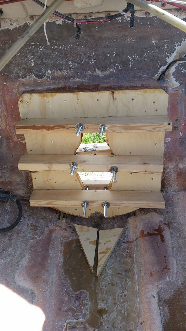

Cut 2 pieces of 3/4" plywood for the transom. Glued them and held it together with stainless wood screws. Then traced out the hole for the gimble housing to pass through. Mixed up some thinned resin and painted the plywood so it would soak in. Then made some thickened resin to stick the transom to the boat hull. Made some 2x4 clamps to put a ton of pressure on the 2 pieces so they stick together. It will sit with the clamps on till Sunday or Monday when I have my next set of days off. I hope to get a bunch done next week because it's going to be in the 70's.
