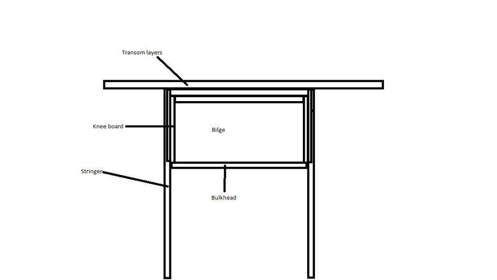

further, I did not take the cap off at all. What I did was cut the cap directly above the wooden part of the transom. If you look at a couple of the top view pics of the splashwell, I cut about to where the points are coming off the rear of the splashwell. My actual transom is only 24" wide, so it was fairly easy to slide the new wood in from the top and work with it that way. It is definitely not the easiest to work under the splashwell on the inside, but it is doable. I debated that cut for a long time also. What I finally decided was that having a solid stern was more important than the ease of construction. I have recently had a friend actually sink a boat("fish-n-ski" bass boat) several times before he was able to find a leak at the stern between the cap and hull. Luckily his foam floated the boat with the cap several inches above the water! I am hoping my modifications will give me a fairly solid stern so that no leaks occur. Current plans are to use pb on the seam up to the rub rail, then use 5200 on the inside across the rear and coming up the sides a foot or two. I should have more pics this weekend if you would like some from other angles.
