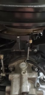

I have picked up a new project.
1988 25HP Evinrude E25RCCA
The guy I bought it from said he cleaned carb, fuel pump replaced, and new water pump.
This is pull start. I pull it and get nothing. On 3rd or so pull it backfires and seems a bit harder to pull but still no start tho.

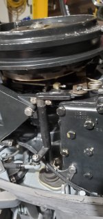

I saw the link and sync was way off. I adjusted that, I am not too familiar with this year. I adjusted according to a older model. Lowest throttle position, got the cam roller set right before the 2 marks on armature plate. Turn throttle and cam hits and starts to open carb right in the middle of the marks. Test and still no start.
I read a thread from racerone talking about the link from the carb to back of motor and this collar needs to be set correctly. I am unsure of where it should be and bet guy adjusted this.
Attached are pics. Let me know if I need better pics. Thanks for any advice.

easy old carb style...
suggest you clean yourself.
check the idle channel to the top needle ... open it ccw .5 turn retry
blow some fuel mix in the carb see what happens
make certain you have sparks on plugs
seems to have an electric primer... make certain it works ( at least click)
E25RCCA is it strickly manual ? check manual primer if no electric primer

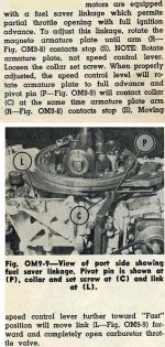

This, while for an older engine still applies when checking/adjusting the Fuel Saver Linkage

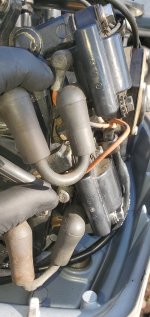

Seems you never checked the ignition coil to power pack connections. Swap plug wires to check as Mr Racer has suggested.

Swapped the wires referenced and it started up!!! Damn you guys are good!!! Just fine tuning from here.

Race nailed it...I just reminded you.
Wires coming from power pack are orange with blue or green strips.
Blue (sky), goes to upper coil...green (grass) goes to lower. Or leave it now that you swapped leads. (Not)
Other wires like trim and tilt are the same.

When I look at your link and sync closely, and unless you've changed it, it does not appear to be done correctly. I believe when on a boat and when you give it throttle it will most likely fall on its face somewhat.
I believe your motor has a service bulletin on the l&s but your even under that. Maybe your pictures are off.
Re-examin that procedure if you think I'm right otherwise go test.
