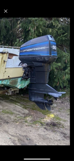

I am looking to either swap motors or swap power heads. I have a 1987 force 85 and one of the motors that I am looking at is a force 90. I’m not sure on the year but the pictures make it look like a Chrysler lower unit. Can someone go through what is different on a force 90 vs 85? Is it just a different carb or is the motor different? Are the controls the same? I attached a picture of the potential motor I would purchase.

I had a '92 powerhead that already had the Merc. controls and had change the bottom plate/Timing tower to make at work on my '90 set-up. the one in the picture shows the water intake higher up (the version before it became a complete Merc. LU & inner changeable with any 2 shaft models)

True, picture from under the Cowl would be helpful to see the ignition etc. etc. would be helpful :)
