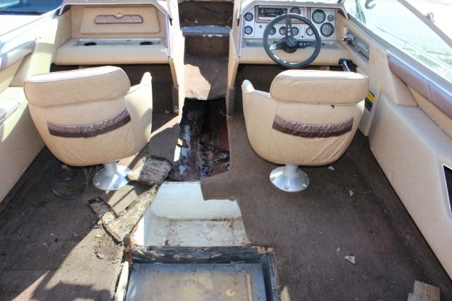

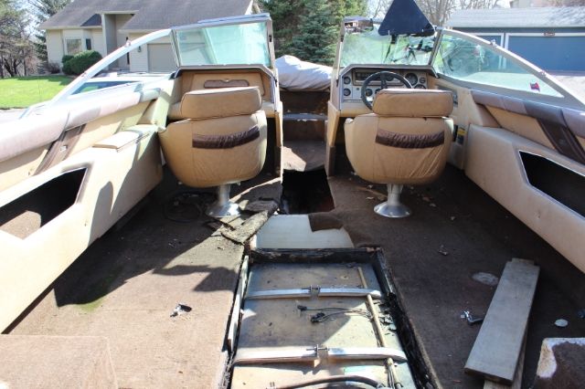

Hello to all. I have finally decided to embark on my project boat. I've owned it since 1995 and due to poor care and feeding, (and it's age) I now need to completely rebuild it. Floor, upholstery, engine.
Here are a few pics before I begin ripping the floor apart.
Thanks to all in advance for the advice I'll need for a successful outcome.

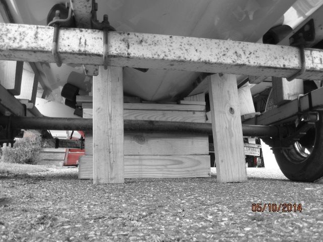

Here are a few pics I took today. I've finished building some support structure under the hull. Please let me know if you think this is adequate or not. I'l post a few more of the support structure in another post. Thanks all.

Here are a few more pics of the support under the hull. Since it's a roller trailer, I was advised to add more support. Again, let me know if anyone thinks this is adequate or not. If more pictures or a video are necessary to determine if this is adequate or not, let me know. Thanks
All depends it the support boards and posts have taken the weight off of the rollers . . . if they have then you should be all set.

Thanks tpenfield. I may just have to get my hands on a moisture meter. And for the support under the boat, I didn't lift the boat off the rollers per se, but the supports are solidly jammed in so-as-to relieve some of the pressure the rollers had been handling. I'm thinking of my approach like a bed or nail: ore pressure points = less pressure per point. Hopefully I can watch carefully this week to see if the hull shape changes or any other symptoms of not enough support as I demo the existing wood. If anyone has any additional advice regarding what I should look for regarding not enough support, I'm all ears. Thanks all.

If you notice the hull flexing you can always use nylon straps to help hold her shape in addition to the additional bracing. I think what you have added is pretty good actually.;)
