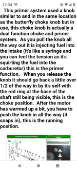

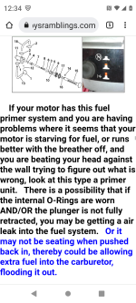

You have a fuel primer instead of a choke. Read leroysrambilings on how that can cause a rich and or lean situation when it goes bad.

Here is the explanation from Leroy and he says it can go both ways.

Just pulled plunger and housing for primer apart. Cleaned both fitting nipples. Some crap in smaller one. Was missing o ring on shaft behind plunger handle. Put one back. Ran to the river quick. Ran same. Did notice it would wind up more when I held the plunger out just a crack. Any ideas with that?

If I’m not mistaken there is a detent on the primer valve and having the primer valve pulled out just a bit would let a bit of extra fuel in. Kinda of like having a choke plate partially closed on a very cold start sorta of day. If the extra fuel helps I would still be looking for blockage somewhere in the carb.
