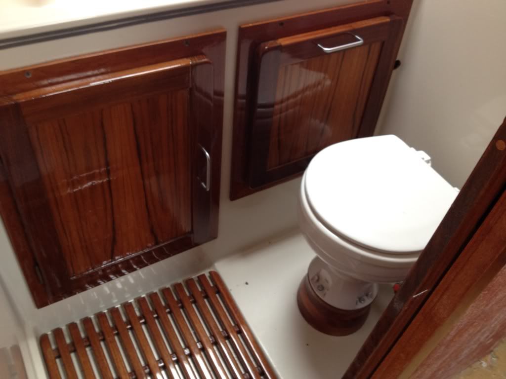

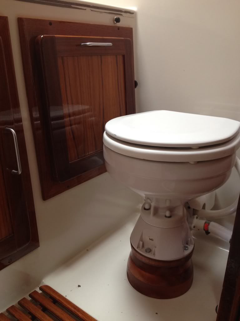

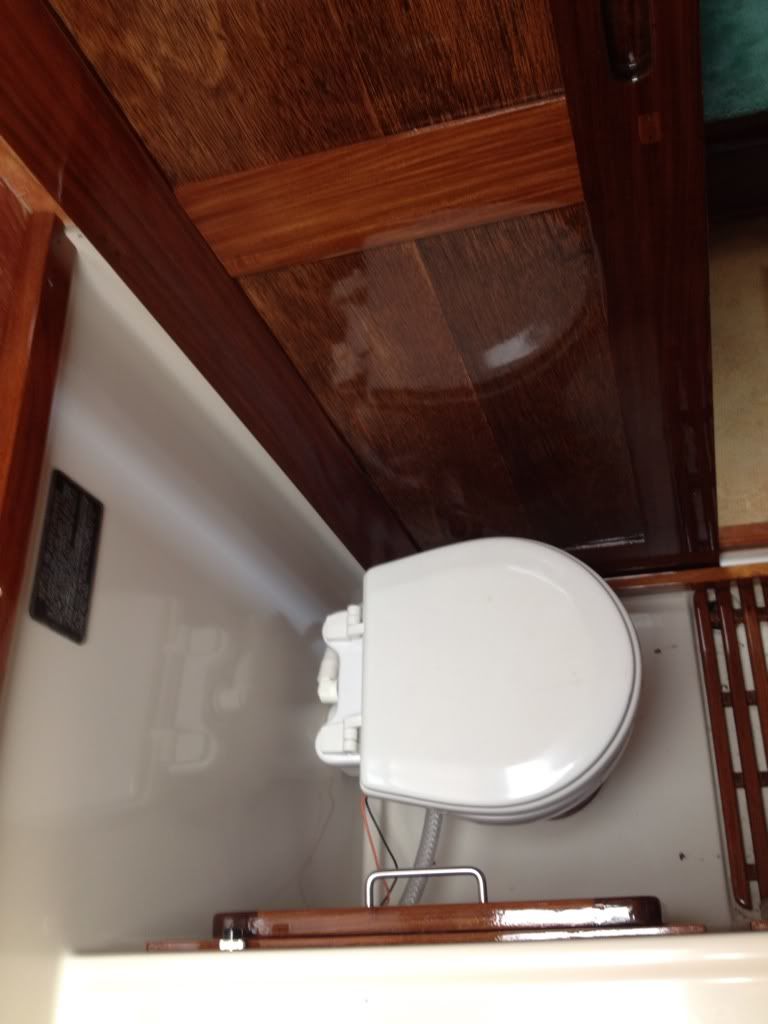

Electric head and holding tank are in. Toilets mounted on a mahogany platform due to the height difference. It's fresh water fed and will get two vent lines in and out. The head is close, just needs the laminate cut for the walls and some additional trim.

Congratulations on your Marriage!!
Good luck tweaking those engines. I have no doubt you'll get them lined out before too long.
I am constantly amazed by the quality of your work. The woodwork in the Head is amazing too.

Nice work, I like the thrown pedestal,lol Looking sharp!:)

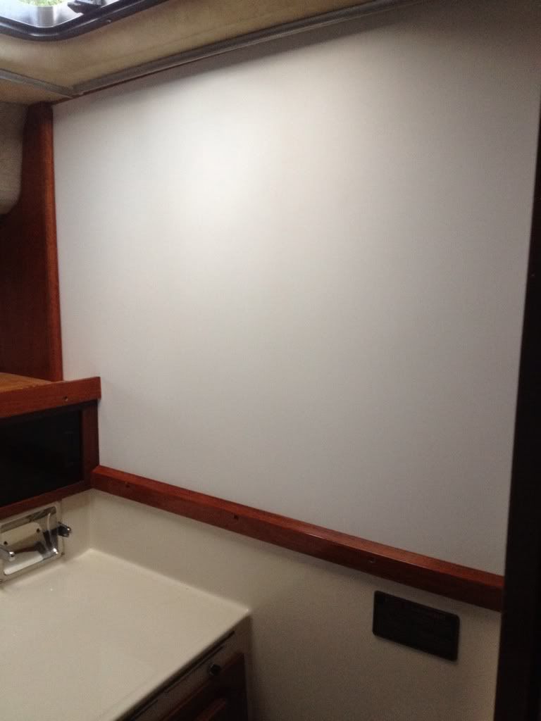

Head wall covering was wallpaper. Half the owner before me did (or one of them) the other half original. It was removed and a white Formica is being cut and installed. The edges will be sealed, the trim work covers most of it, but the seams will be water tight. Once the walls are in I can finish the wood trim work, and the heads set!

The laminate was cut this past week, and tonight it was installed. There is still more trim work to do, but it looks much better than bare wood walls. Slowely but surely.
Before:
After:

I had visions of doing wood Vaneesha walls soaked in varnish, but decided against it. It works on the old Chris crafts and egg harbors but just wouldn't fit right in the Silverton. I think the white laminate looks great. It's clean, bright and actually feels like a larger head. There will be more trim and a custom made mirror as we get things done.

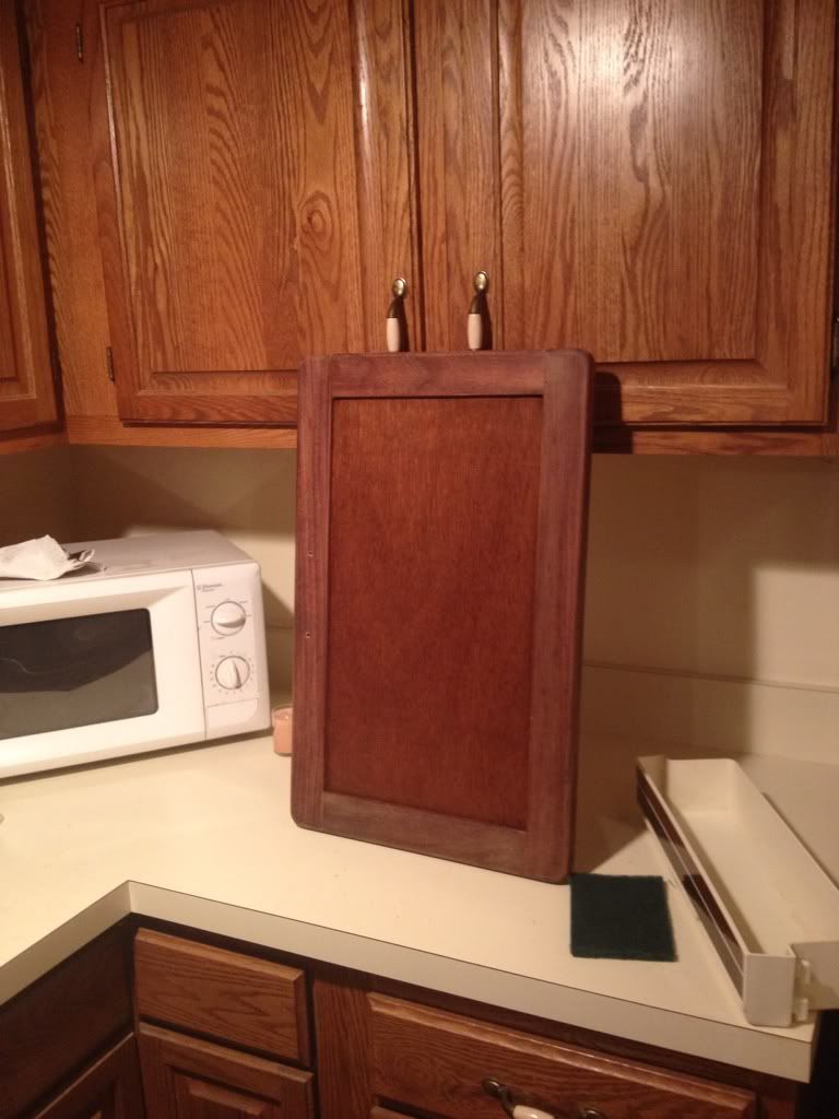

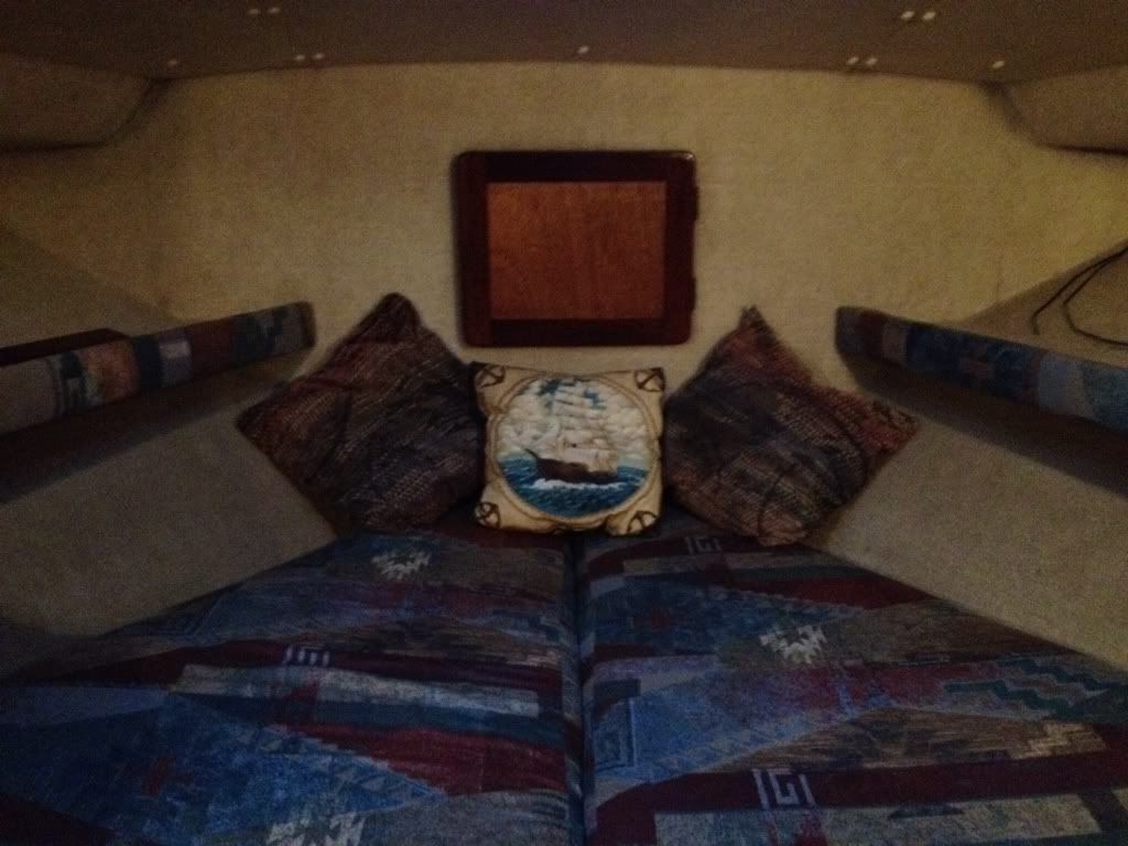

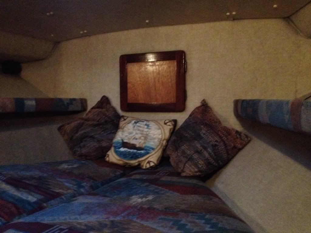

I'm also working on some of the cabinet doors. They are currently laminated and if you recall I used a veneer to cover the laminate. On the vberth door, I took her apart and decided to simply try flipping the center section. It's a wood panel and although the wood coloring is a bit lighter, it's not a bad look. That door has two coats of poly now and will get a few more before a sanding and varnish.
I took the galley cabinet door home to try and stain the center to match. If I get it close, the rest of the cabin wood work may get redone sooner than I thought.

Just realized I had photos of this.
Before:
After being flipped and two coats of poly:
You can see why I'm going to stain it to match. It's not bad, but a bit orange looking.

Matching the stain. It's close enough for me.
