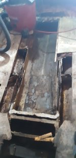

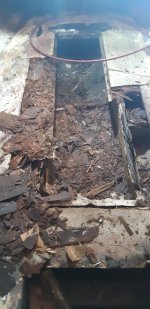

Ok, so thanks to yalls help I started stripping everything and noticed the back of boat floor was soft and had a 8x8 hole in floor up against transom. So attached is what I found. Is this even worth fixing?
welcome to the older boat owners club. we all have been there, we all had a boat with rot (or we are lying about it).
we all have had to ask the question to ourselves.
for me, the restorations had sentimental value or because I could
for others its the satisfaction of the cathartic project.
only you can answer your own question if it is even worth fixing.
expect to spend $2500-$3500 in the hull for materials, resin, cloth, incidentals and PPE
expect to spend $2-$2500 for the interior
expect to spend a bit on the motor, wiring, controls, etc.
at the end of the day, if you dump all that into a 43 year old tri-hull, you still have a 43 year old tri-hull

Thanks, for me it was a cool looking boat, a father son project and first one. Luckily I know how to do fiberglass. Watch some really good videos and plan on going ahead with cutting out the floor, replacing the transom and going to use Coosa board to keep weight down. Found a great 90 hp motor complete with all controls. Will keep posting pics along the process. I'm glad I found this forum, great info and help!
