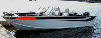

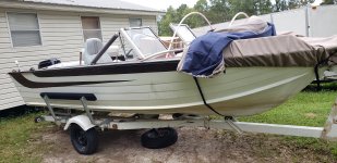

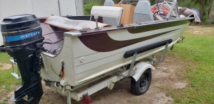

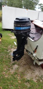

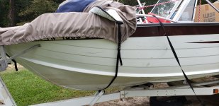

Good morning!!! New to the forum and looking forward to learning what y'all have to offer. We were just given my father-in-law's 1978 supersport 18. It was last in the water in 2009 and has been kept in a climate controlled basement/garage since. It has a 1980 mercury 800. He also has new captain's chairs, new carpet, new trolling motor and new radio (with auto reverse cassette player 🤣) all new and in the box waiting to be installed. We won't have the boat in hand until the 11th as it's in Tennessee and we're in Mississippi. Plus we have to dig it out of the garage lol. I've had a few boats in my lifetime but never an aluminum. Other than taking my time lubing the internals on the engine and cleaning the carbs (injectors?) And checking the rivets is there anything else I should be looking at? I've NEVER gotten a boat from a climate controlled environment lol. Also... while I'm concerning myself with will it run and float, my wife is concerned with the color. Is there a site where I can get new hull stripe decals? So far searching has turned up nothing. More pictures will come when I have the boat in hand 😁

Welcome! I'd strongly recommend changing the impeller, new gear case oil, flushing old fuel out of the system, and a basic visual inspection of the hull (i.e. no missing/damaged rivets etc). Aside from that, I'd say it's really up to you how far you'd like to go before taking it out on the water.
Maybe avoid the Gulf for the first few trips :D

Welcome! Congrats on what appears to be a turn-key boat...with the desirable "swoosh" stripe!
Did your FIL do a restoration on it? If not, be sure to have a working bilge pump since she may take on some water; often times these old tinnies have a few leaky rivets, corrosion and/or fatigue cracks that get addressed after being gutted.

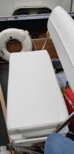

Thank you!!! As far as I know the boat has never been restored. My FIL got the boat in 1981 in trade for a motorcycle. The motor was gone so he added the 80 mercury 800. The only thing that raises questions in my mind is that he said when he got it the seats (the ones in the pic) are van seats on boxes. He isn't sure why they did that but bought the pedestal seats and never got them in. I haven't been able to find a pic of an original interior so I don't know if those seats are standard. I plan on removing the floor so I can put some back up plates on the new seats and put in the new carpet so I plan on going over the whole thing with a fine tooth comb. Bilge pump is a must no matter what lol 😆 😂
Man, that is some out of the "boat" thinking (couldn't resist Dad joke). lol
That being said, that isn't a bad idea, you probably can get a used van seat cheap and it would be sturdier then low end seating.

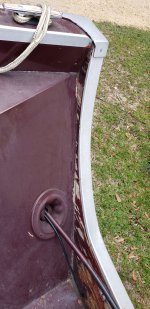

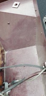

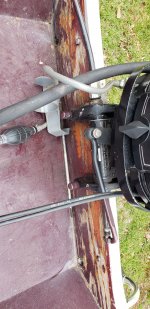

Started going through stuff and it's going to take awhile to figure out what's what. I've got two wiring harnesses, three trolling motors, two brackets (plus the homemade one mounted on the bow), various lights, trim pieces, and extra bits (tape player, horn, switch blocks, etc) and three coolers packed with other assorted pieces. The transom was replaced with marine grade plywood right before she got put up and looks solid except for some varnish peeling. I started today with organizing some of the stuff, fogging the motor, and getting the batteries charging. All before the lightning started lol. I guess I'm in it now!!! Here's some better pics.

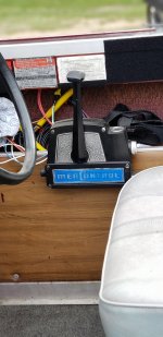

I know it needs a new wiring harness. FIL added the switch block to the dash but nothing is hooked up to it. Everything electrical (except the bilge pump) has to plugged in to use. Included with it was new pedestal seating and new carpet, new trolling motor and bracket (which I'll have to rig up a way to mount it due to the angle of the bow deck), and a bunch of other stuff. I think once I make sure everything is safe as is we're going to run it as is for the rest of the season (one of the few good things about Mississippi is a really short winter lol). Then I'll get it in the barn and start pulling the interior out. I'll pull the decking up and check the structure then. That'll give me time to talk with the four star (wife.. no admirals here lol) and let her pick what she wants done as far as color and throw pillows. I'D like a newer motor. We're also going to take it off the trailer and redo the paint and overhaul the trailer. Unless it takes in half the lake when we put her in I think that's the plan.
