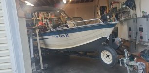

I am about start my first restoration. I have a 1978 StarCraft that I put a 75hp 93 merc on the original Evinrude 70hp was ran without oil.
Lots of rivit heads popping off so my first step will be to gut it and replace most of all the rivits below the waterline. Then she's will get gluvit inside and gatorglide on the outside bottom. A new transom and once the floor is back in pour foam 2 part foam. I am open to pointers since I have never done this and will be learning as I go

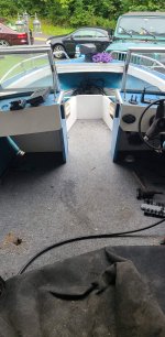

Since everyone likes pics here some of mounting the Merc and removing the dead Evinrude. Well it will start and run on neutral if you keep it over 1500. Don't try to put it in gear or idle it though

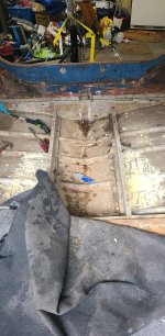

Got the motor off and started tearing the back apart.
There was corrosion and putting behind the wood StarCraft had on the outside. I am going to epoxy a peice of sheet aluminum on the outside.
Thete are a ton of rivits the need replaced but so far just the rivit corroded the skin seems in great shape. Almost have the transom wood out. I wanna get the new one cut and epoxy coated and put it in then I'll finish gutting everything and getting the foam out.
After that it'll be replacing a lot of rivits then I'm gonna hang it from the rafters to do gatorglide on the bottom and gluvit on the inside.
Here's some pics of the progress so far
