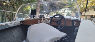

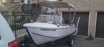

Well I know I said this was a summer project but life has gotten in the way BUT there has been progress made. I wanted to see this through so here's that same boat as it sits today. I will post an update with all has gone on during this process in the upcoming days.
