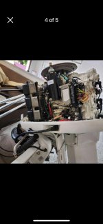

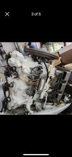

I'm looking to hook up a tach on my 1978 Johnson 150 hp. I keep reading about a grey wire. This is a V6 motor and has two control boxes. Any help is appreciated.
Honorary Supreme Mariner
39,980
There are 2 powerpacks on the motor.-----Look into the control box at the helm.-----Might find a gray wire there.-----The factory tachometer operates with alternator pulses.

That control box may have a feature where you plug in a tachometer.---Post picture of area below the key switch.
39,980
Well ---I can see the " picture " but I can't see whether it has an unmolested plug in for the tachometer.-----If you post a clear picture of below the ignition switch, I could tell you if it has that feature.-----Your boat is too far away for me to examine it.
