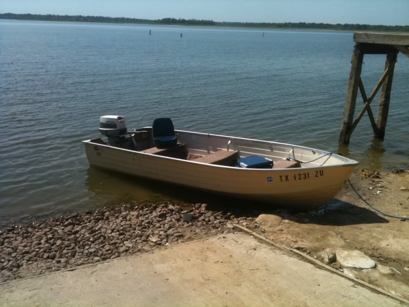

I did it again!!! I was on the CL hunt cause I'm addicted and came home with a 14ft Mirro Craft tinny with a 1985 25hp johnny. Picked up the boat/trailer/motor for the price of what I feel the motor alone is worth. My gf says I need to go to AA for boat buying..I now own 4..but I disagree its just a fun hobby.
Anyways the boat is a good shape for its age had it out for a few hours today and had no leaks and handled some chop very well I was suprissed (this is my first aluminum boat/jon style boat). I have a few questions that you could possibly help me answer. What model of boat could this be? Looks kinda like a deep fisher to me. Also the transom was replaced by the PO but it was not sealed or anything just made with treater plywood. It creeeaks a little bit when you first plane up..Is this normal for a boat like this? or should I look into replacing the transom? Also was wondering how hard it would be to repaint the boat i have never messed with aluminum painting before. Also am thinking about making a deck but that will be farther down the road.
Any input would be helpful, give me your thoughts ill include some pics.

Easy restoration ;) I like bare open hulled tin boats.....easy to work on

That is a SUPER nice hull. My dad and I have a little 14' also but it isn't nearly as high sided as yours and certainly couldn't handle that big of a motor. Really nice boat. As you've probably read on here, the newer (as in like the last 7 years or so) pressure treated eats aluminum. Not knowing when that one was done, I'd probably replace the transom again using exterior ply sealed with epoxy resin and painted, or with poly resin and fiberglass. It doesn't look like he did that great a job on it any and you could probably do better :)

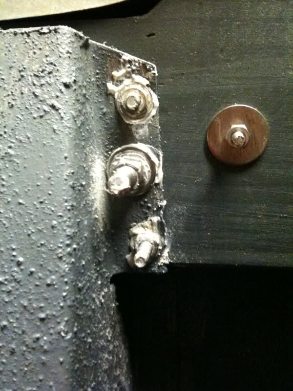

Okay have a small update I pulled the transom off and did not see that much corrosion but I took a sander and wire brush the the part where the board was and cleaned up all the funk. Then had a bright idea to use duraback and coat the transom/supports/bildge area since I had it laying around from another project..I dont know if it was a good idea or not? but it looks and feels good. Then I went and got a non treated 2X10 from home depot and used the old wood as a template and cut a new one and coated that with some water sealer and gave it a coat of exterior grey paint to match the duraback with an ol' rattle can looks good. And I also added 4 more bolts to the support made it a heck of alot more solid..also used sealent in the new holes that I drilled and coated the bolts real good with it before i but it all back together, ill include some after pics. So now seeing how good the new grey looks it has lit a fire under me to go ahead and rip alll the nasty brown carpet out and replace it with some grey that i have some another project and sand and etch primer the whole boat and paint the inside "sides" grey and the out side a nice dark blue to match my truck and then hit it with some clear for some shine. So if all goes well i will have this funky carpet out by the end of the week the stuff is realy glueeeeeeed down and it almost feels like some sort of tile glue the guy used cause its not hard its kinda soft and its 4 years old.
and the 2 new bolts to each support (4 total)
