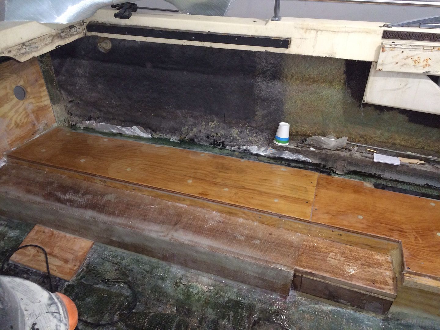

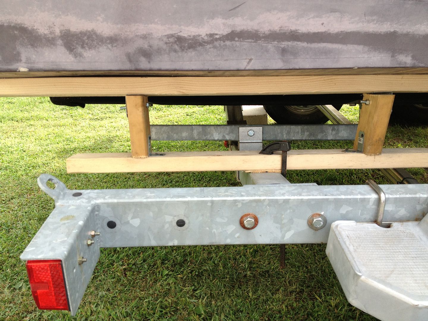

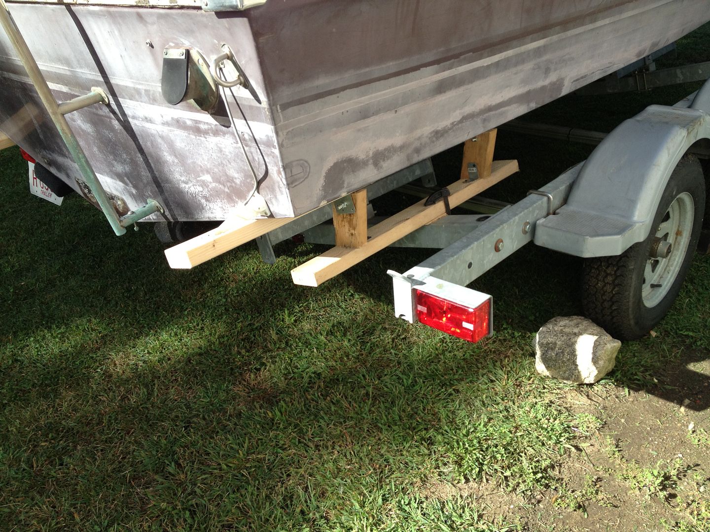

Here are some of the temp bunks i made to give things a little more support.
I will be using epoxy and cloth for re-installation of things and the pour in foam. I was planning on cleaning with acetone first, but do I need to sand any place I plan on using the epoxy of will the foam adhere to the fiberglass hull?

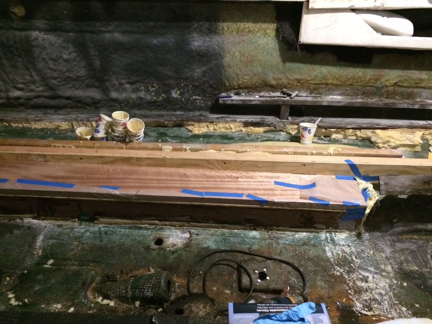

Re: 1975 Century Arabian - Total Restore

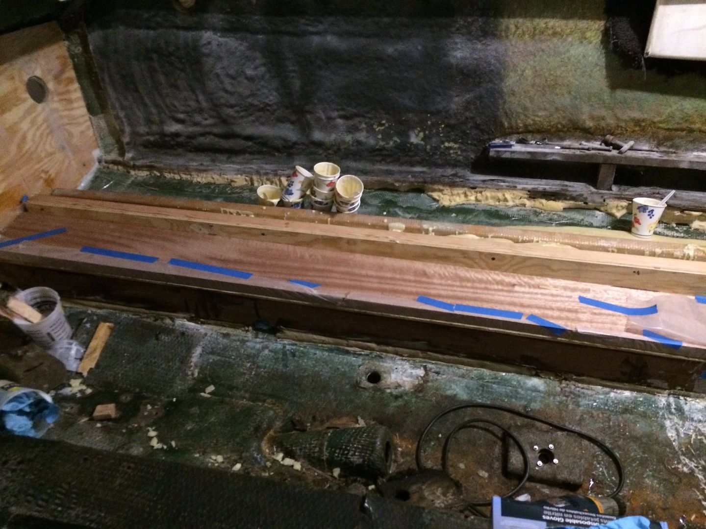

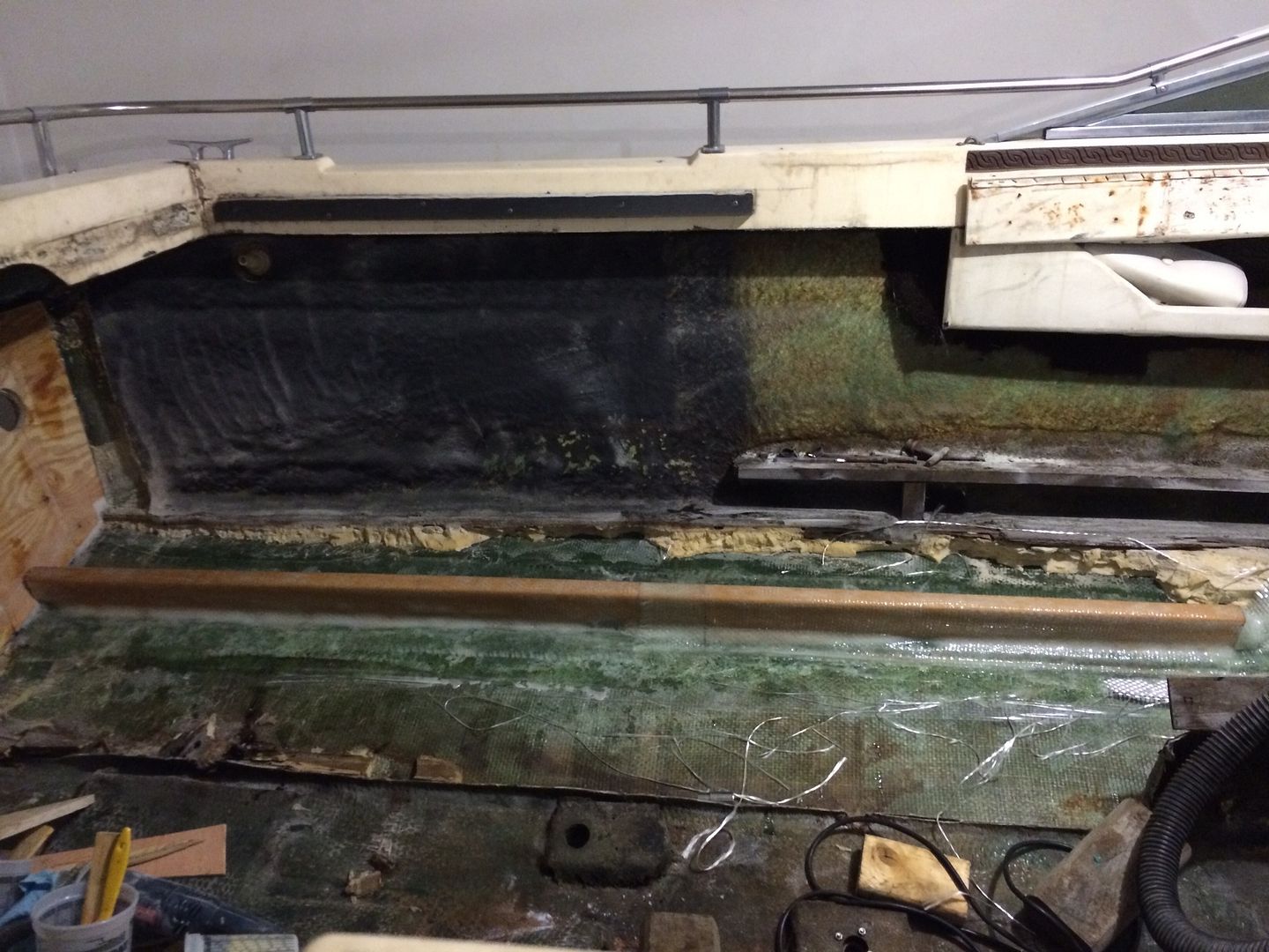

progress update - one of the stringers has been replaced and part of the transom:
Ordered some 4# density foam to start filling back in - coming along nicely. Also installed the first part of the motor stringer and will get pics up later.
Started the foam process. Nothing like I anticipated and messy as hell, but progress none the less
Once the foam is under the motor mounts I will coat everything in epoxy for the final installation.

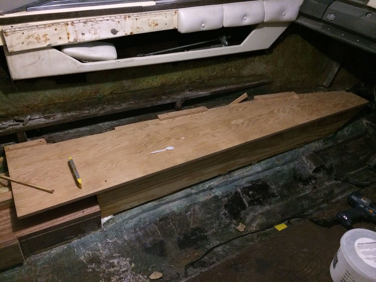

Moving along. Have the deck mocked in and the deck support epoxied in place

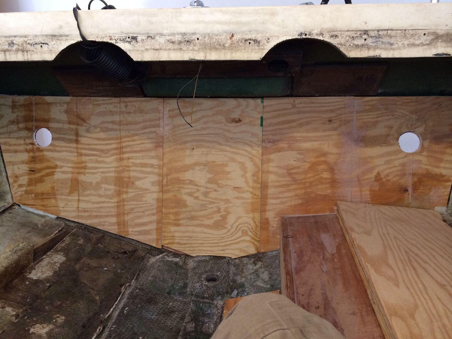

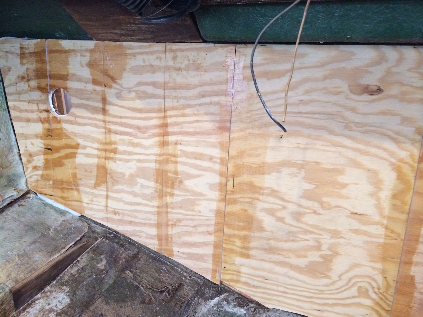

Finally got some warmer weather and got the transom in. Looks good

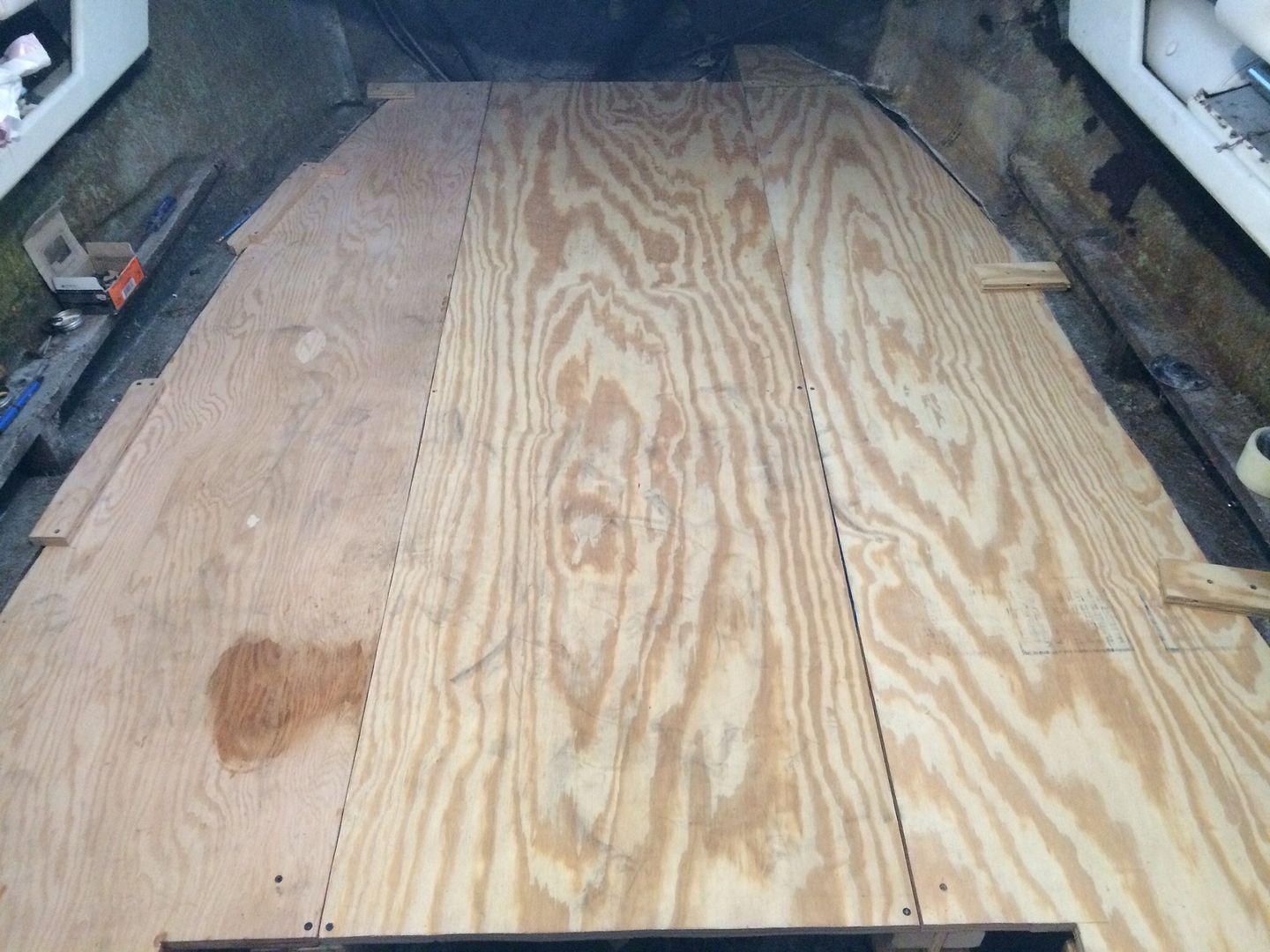

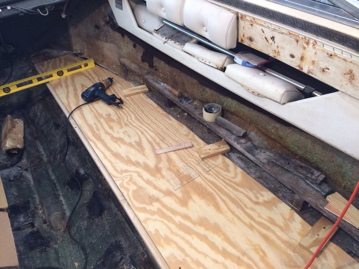

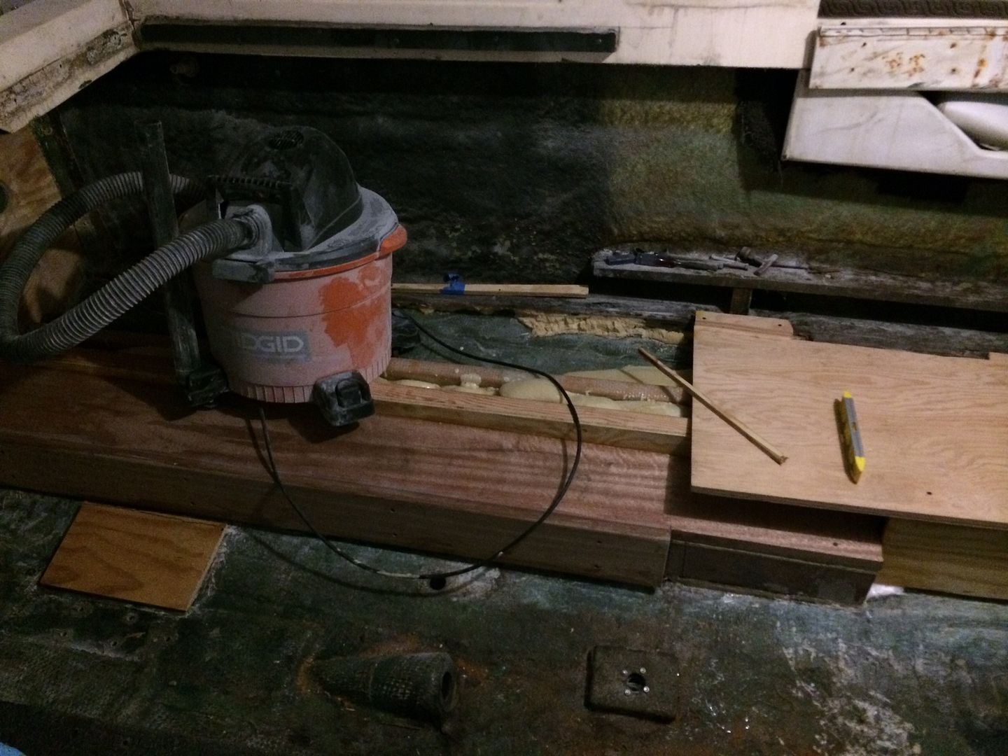

Starboard deck all mocked in. Looking good
