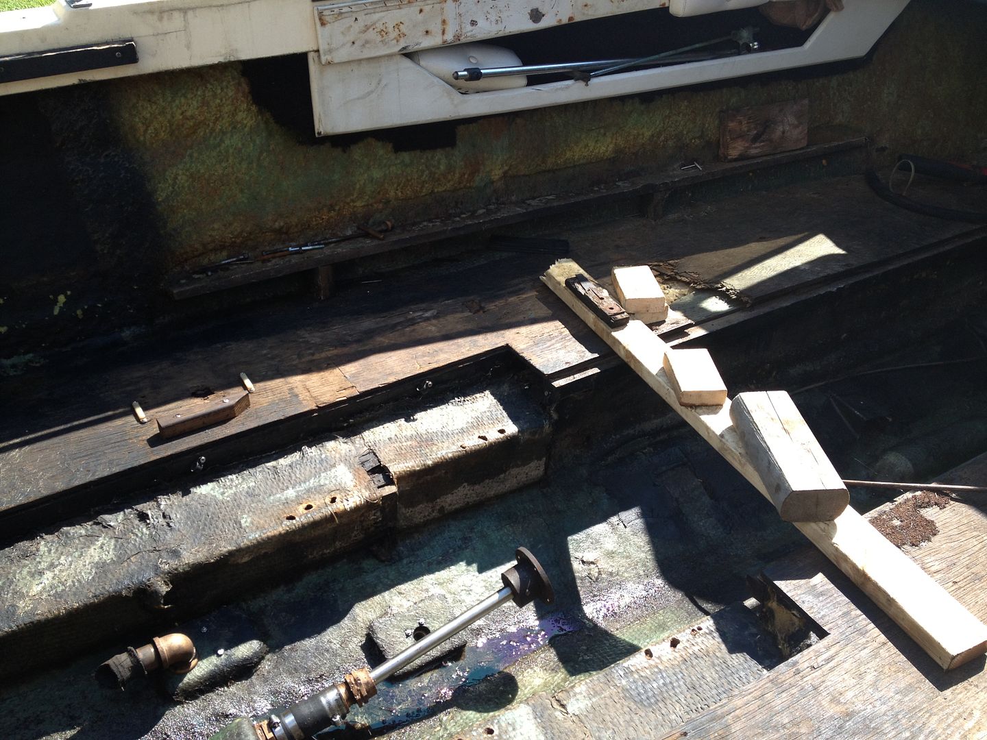

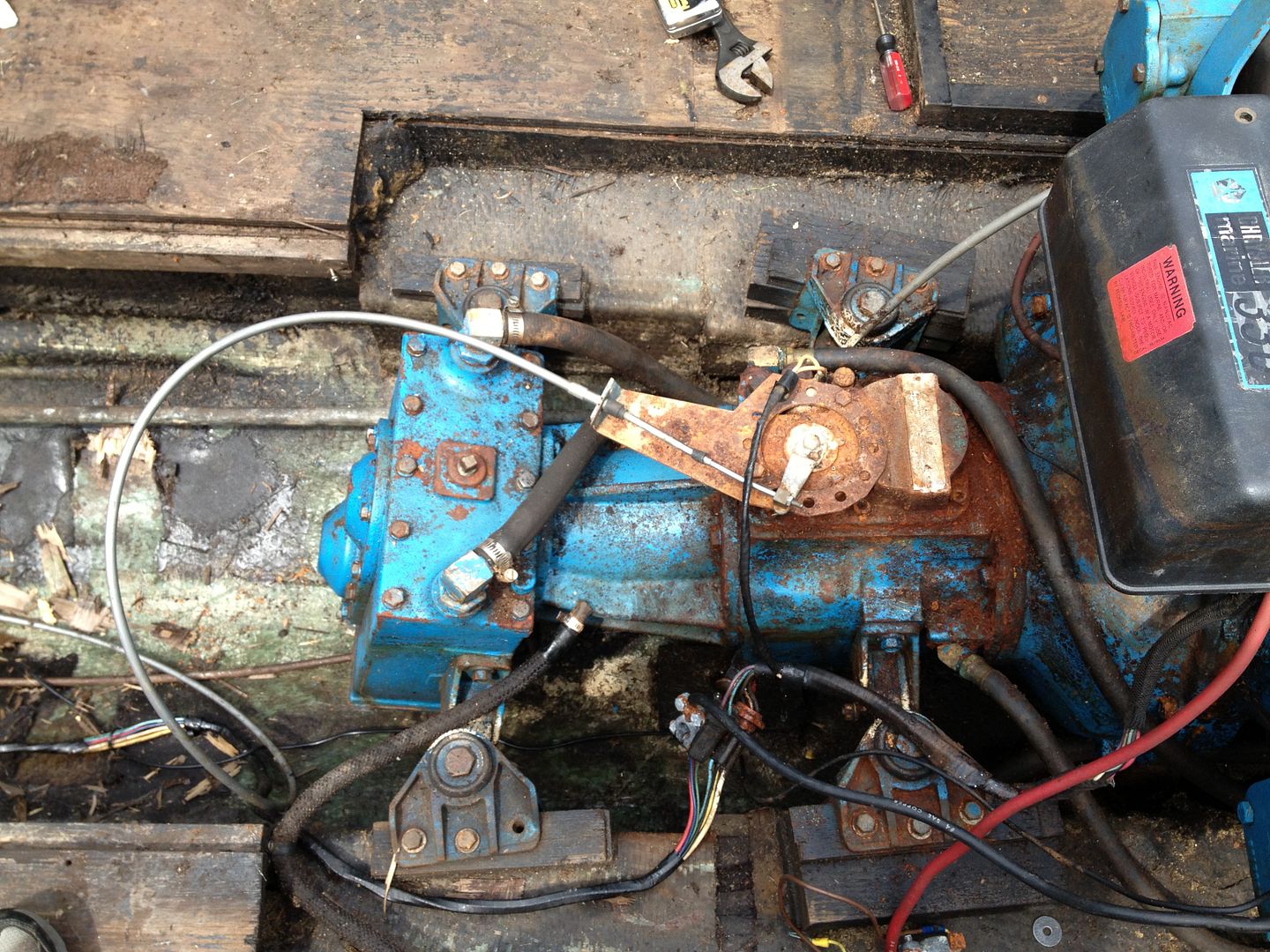

Deconstruction begins... made some good progress, interior is out and the gas tank is out. There is rot everywhere.

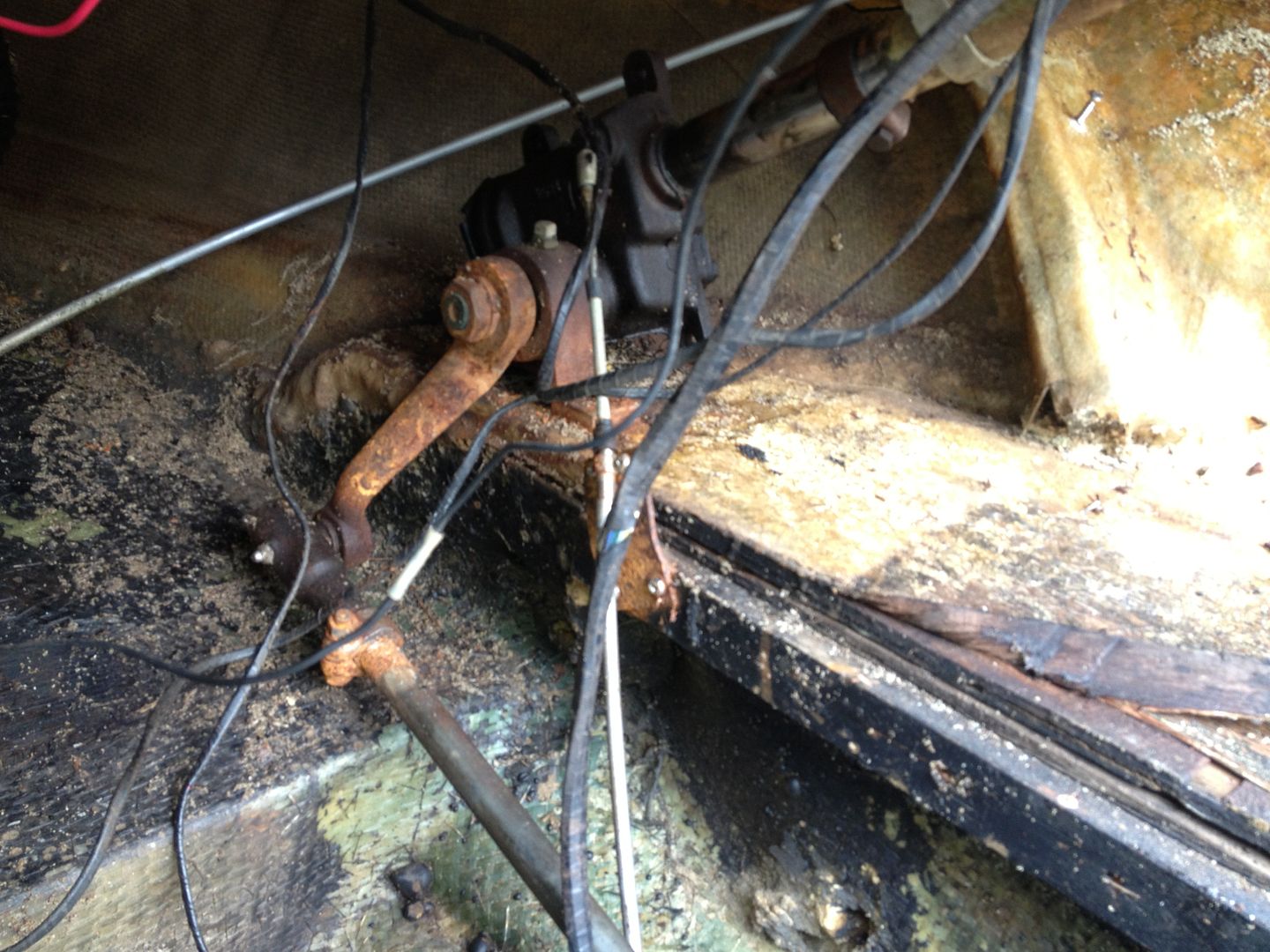

I really like how they "built" things back in the day. The rudder is controlled by a 1" rod that is connected to the steering wheel by a mechanical lever:
More pics to follow:

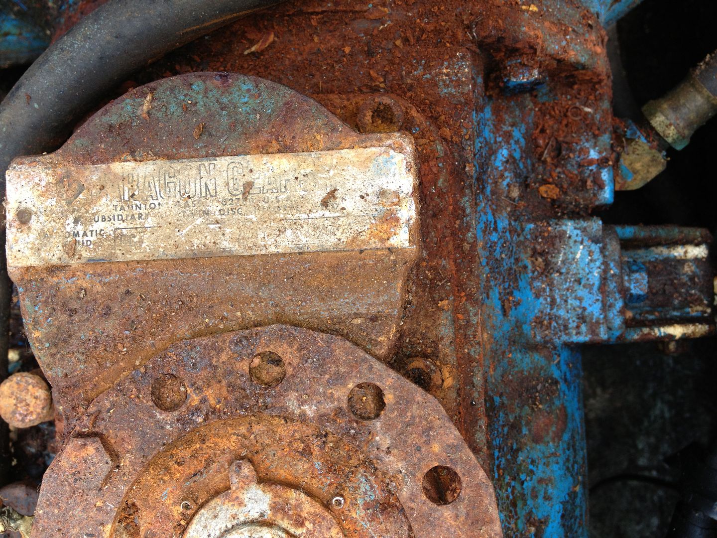

The boat was partially submerged for a while. There is no water in any of the oils, but the starter and pulleys are covered in rust... The motor is a total mystery at this point.

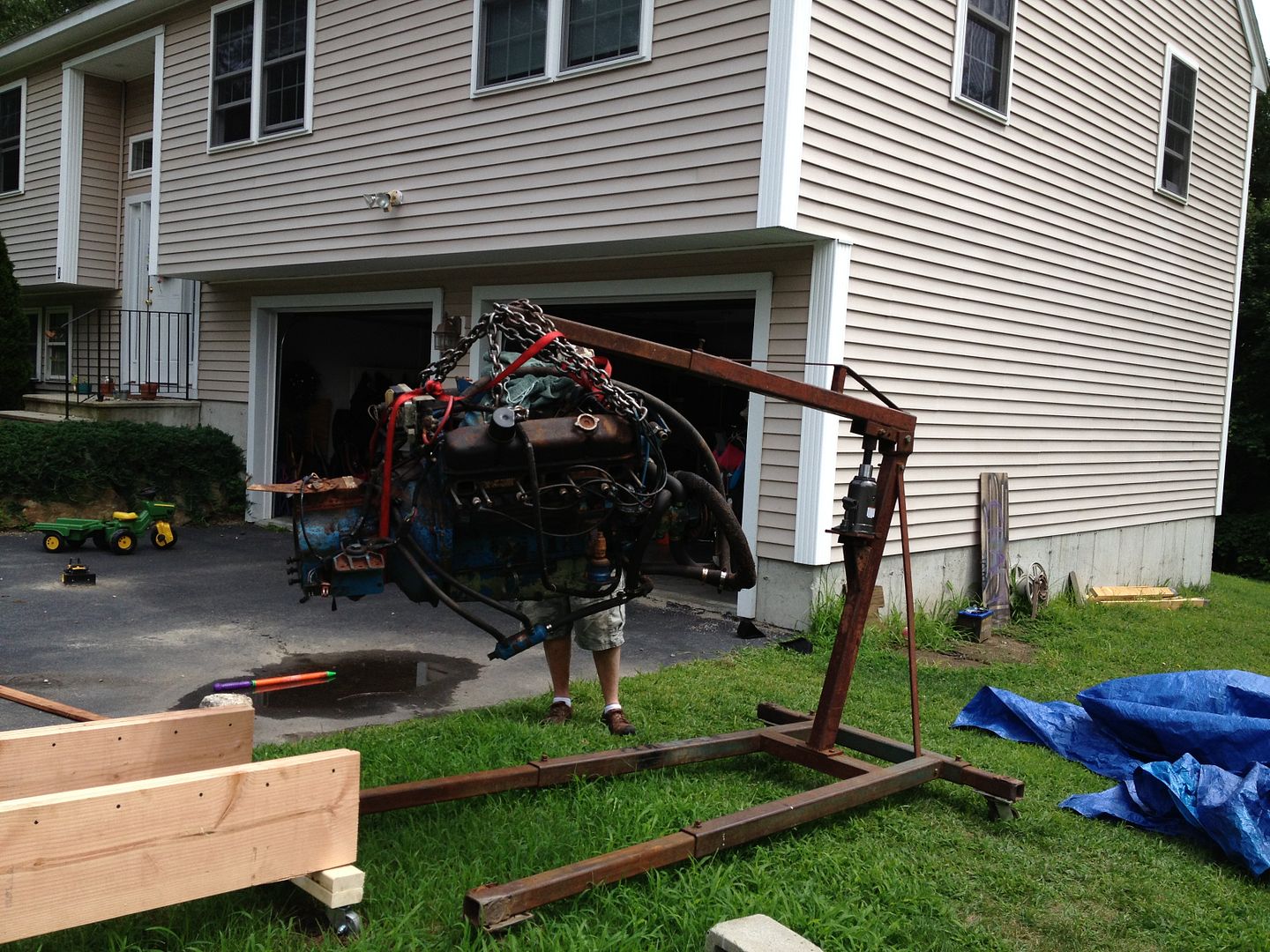

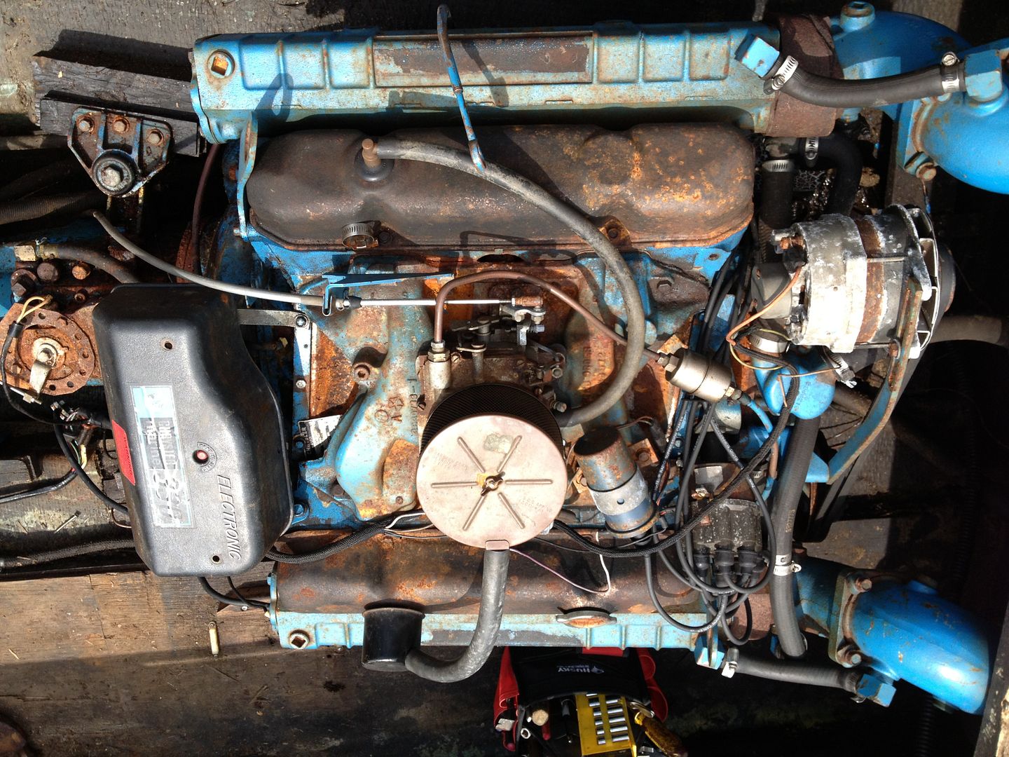

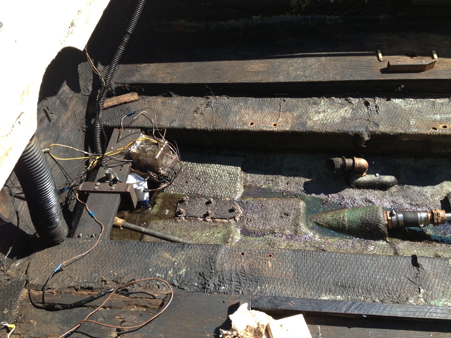

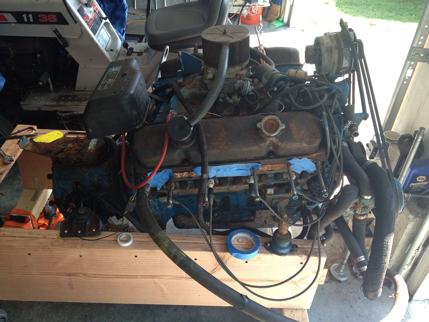

Update - We got the motor pulled this weekend!!! Was pretty easy, but having 800 pounds 8 feet in the air was a bit nerve racking.
Good news is that the motor is not seized. Started to clean out the junk that has collected on the bottom
Found the drain plug too..

Wow, how nice to have an engine hoist it is... Now I'm watching this... Looks like this is about to get good.
An inboard boat is a much trickier restore than most dare here (at least from what I've seen). Good fiberglass work is a necessity here. Looks like there has been quite a bit of work done in the past.
Good luck

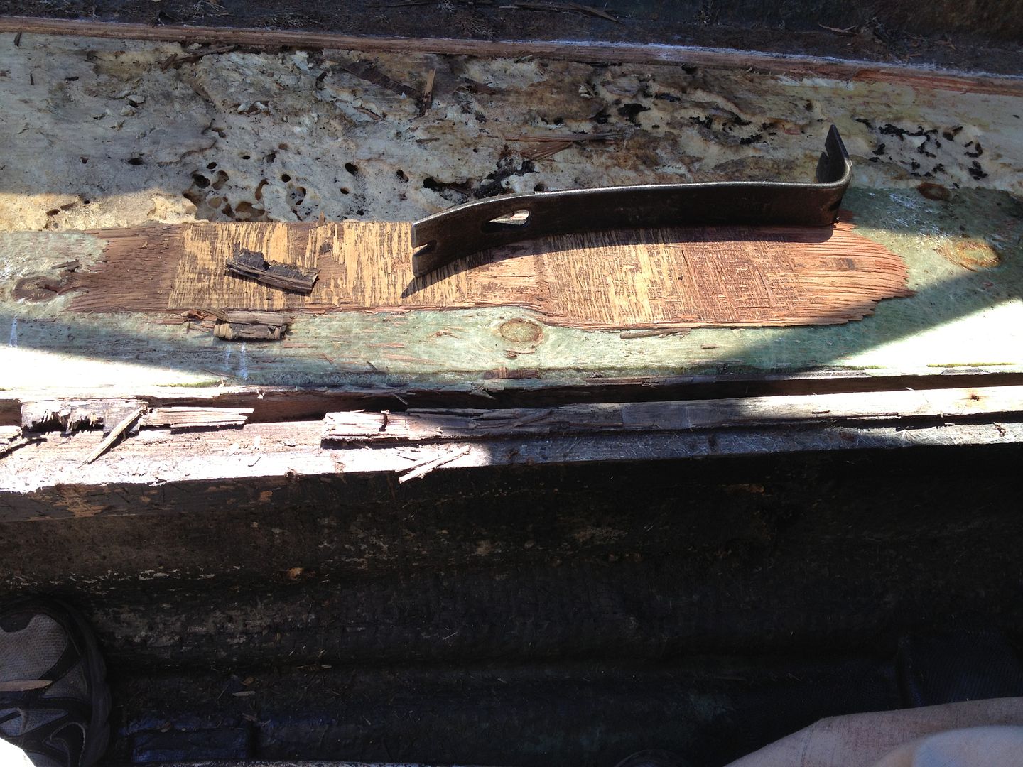

Demolition continues with good progress.... Rudder is out, water pickup is out, steering rod is out and port side deck is out. No surprise the foam is soaked and the wood is mush. While I'm not surprised at the amount of water damage, the transom is completely rotten from top to bottom, would think the top of the transom would be in decent condition but it isn't..
Found two separate colonies of bugs, fortunately they are all dead and it looks like they removed some of the foam for me!!
So far it looks like the wood is mahogany and it was bedded to the hull into the flotation foam which is a surprise. Was it common to do this in the mid 70's - I had planned to bed the stringers into some thickened epoxy, would it be better to use some flotation foam instead?
Pmccraney
Jul 26, 2011
1,734
Re: 1975 Century Arabian - Total Restore
In my 70s chris craft, the stringers had longitudinal arches between a few contact points on the hull and when they poured the foam it ran underneath the stringers. You can bed with pl glue or pb (thickened resin).

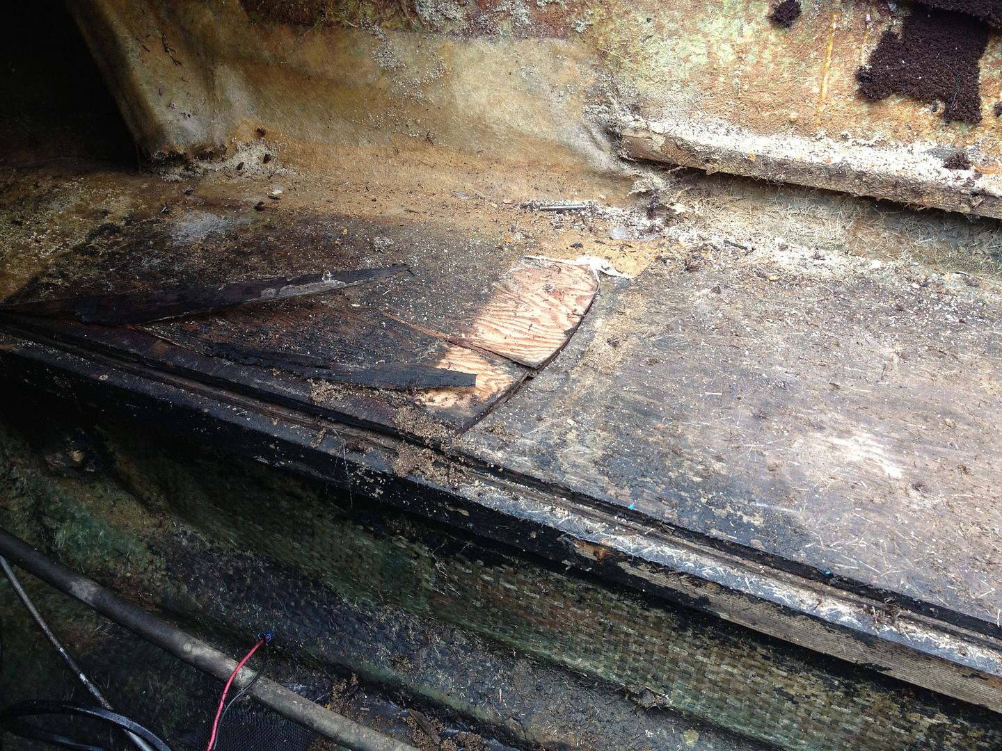

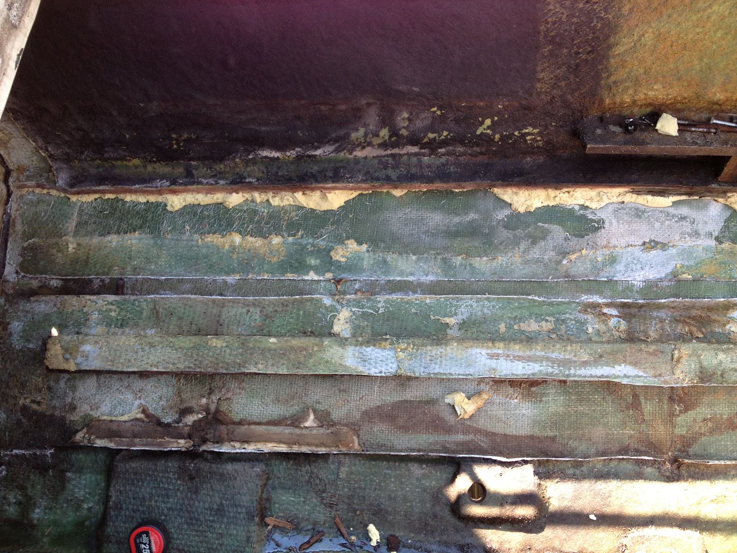

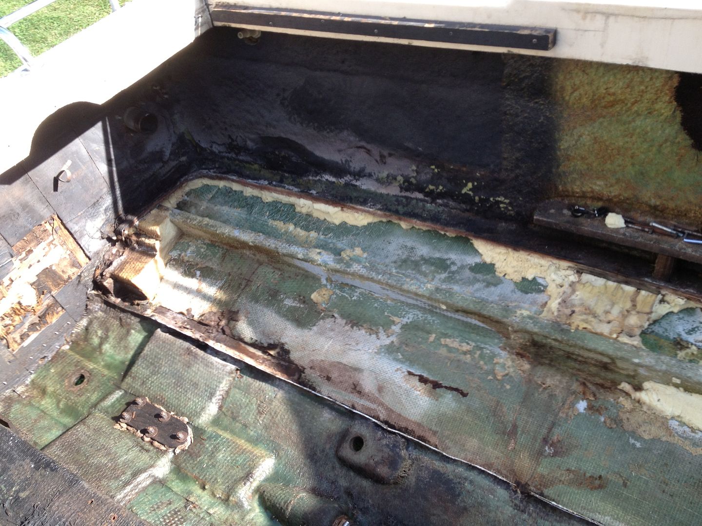

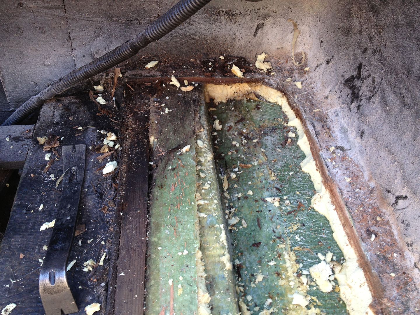

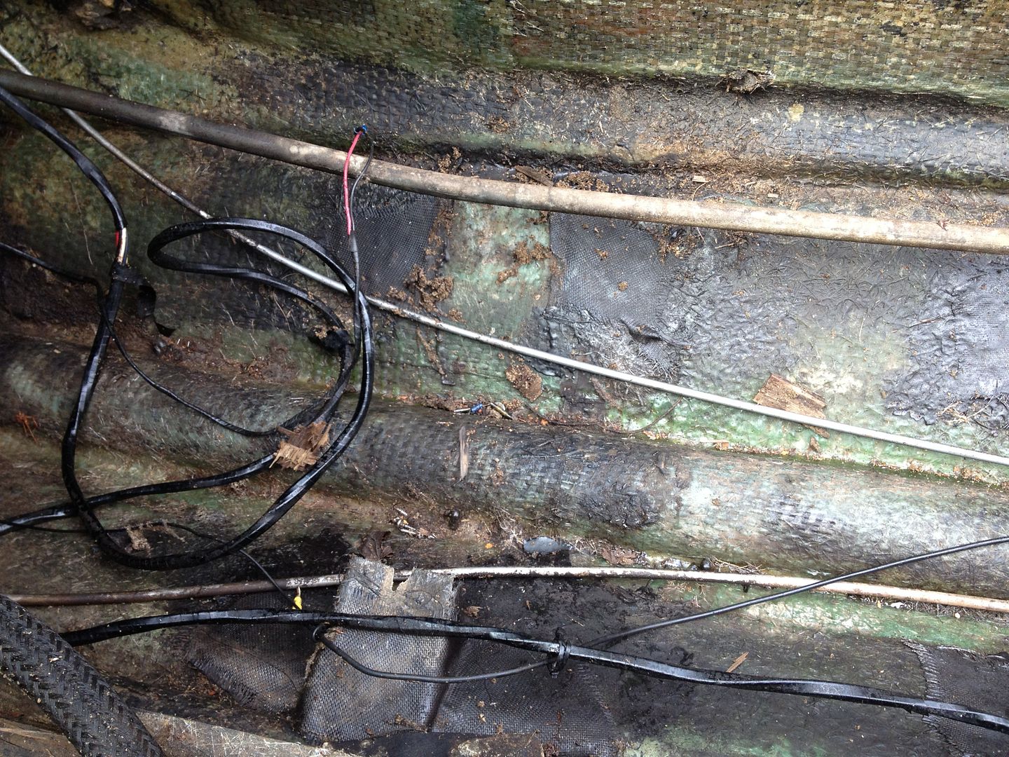

Deconstruction continues --- Was thinking the foam was going to be painful to remove but it comes right out in giant junks.

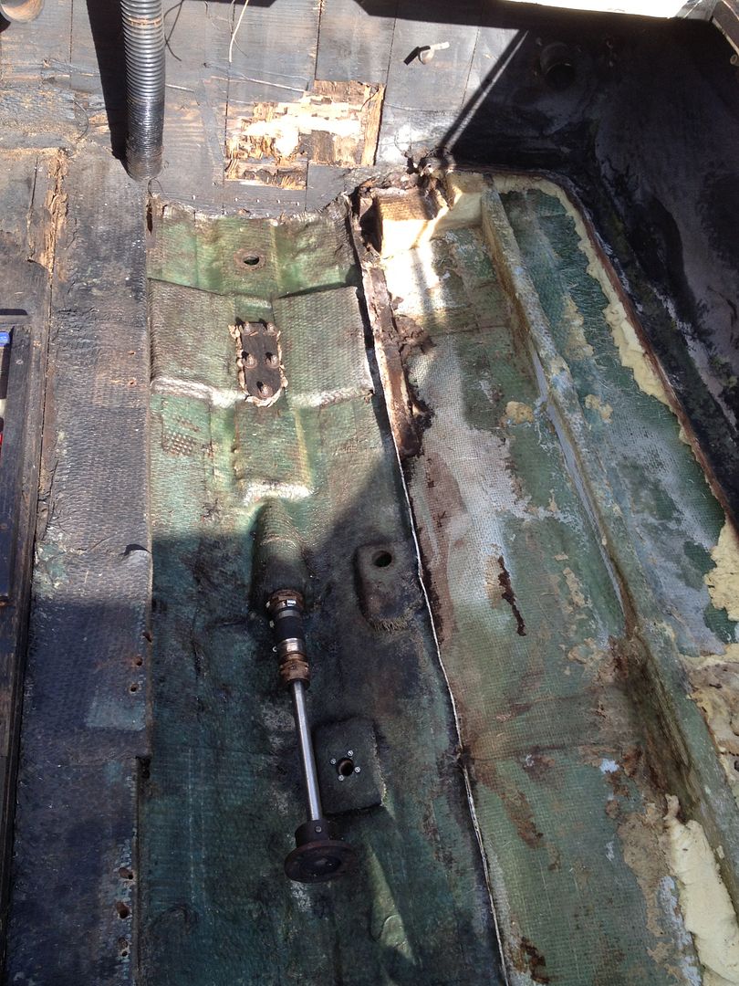

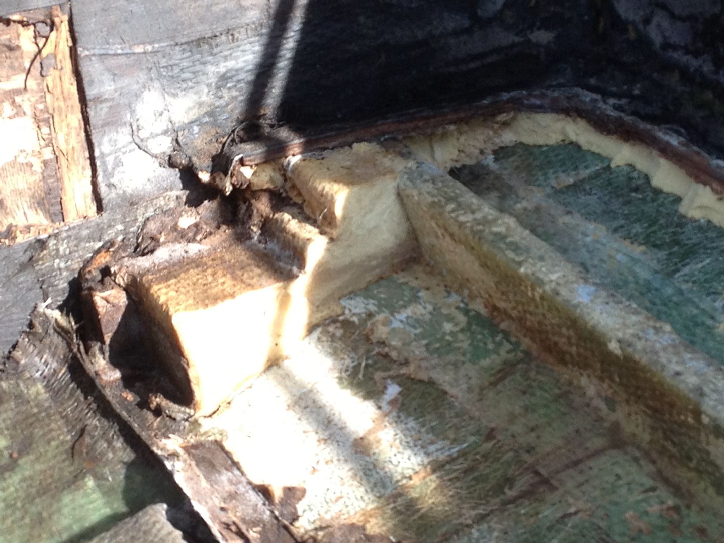

Need some advice here. It looks like there are two main stringers on each side, easy enough - but the bottom of the hull is covered in foam and it was shaped. Once shaped they applied a roving over it and on top of the roving they mounted the mahogany for the engine/drivetrain mounting surface. see pics:
in the above pic, i left a small section - how did they get this shape. There is no wood structure underneath and the wood sat on top of the foam????
Some other pics:
I really need some advice on how to reproduce what the factory did - will epoxy/cloth adhere to the foam properly or should I reproduce the original shape out of wood and then fill with foam. It is interesting to note that the foam while wet, is not as wet as I would expect. Also, the water ended up taking most of the adhesion away, allowing for things to pull apart fairly easily.
When I originally brought the boat home there was a pretty noticeable dip in the port stern that looks like it has straightened itself out.

Marksa, our boats look like about the same construction. Around my engine mount (mine is an I/O) I had a solid beam (4x6) running several feet stern to bow - completely rotted. You can see on approximately page 3 of my thread what interpretation I had of the original construction for my rebuild. If you cut just a bit closer to the gunwale you will be able to pop that last little bit of ply out. The gunwales are full of foam also, and I would leave this in place. I took mine out only because the previous owner had so much carpet adhesive on it that could not be removed. If you need more specifics on other aspects, I might be able to elaborate further. Hope this helps.
chconger
Jul 3, 2012
315
For these;
....I know that epoxy will adhere to foam fine.
There is another century on this site that is active now. You both have these things.

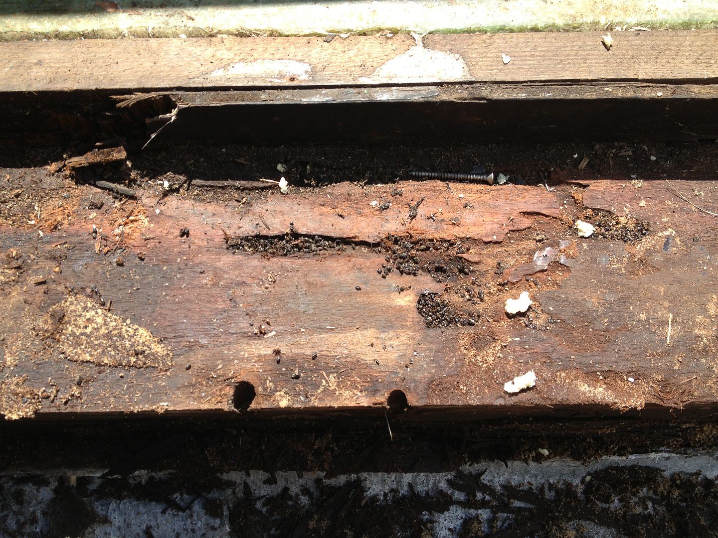

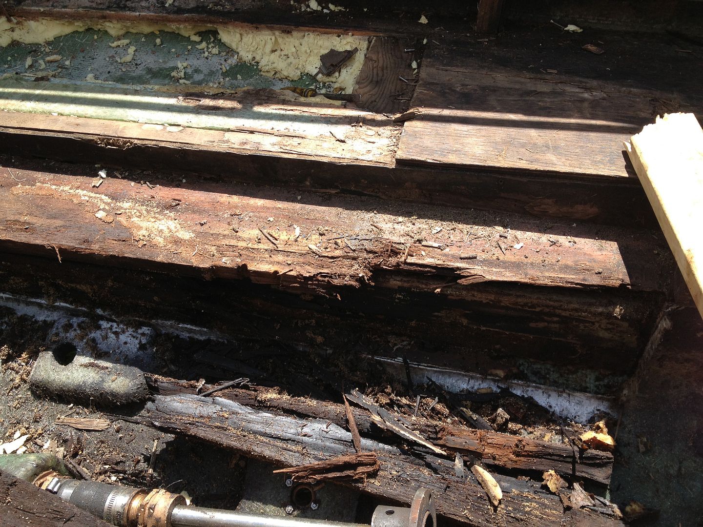

More Deconstruction Photos - was able to get the last port stringer out. It was in surprisingly good shape with just some moisture on the bottom. It wasn't glued to the hull, but held in place by the roving. My thought was that while I was here, it was little effort to replace it:

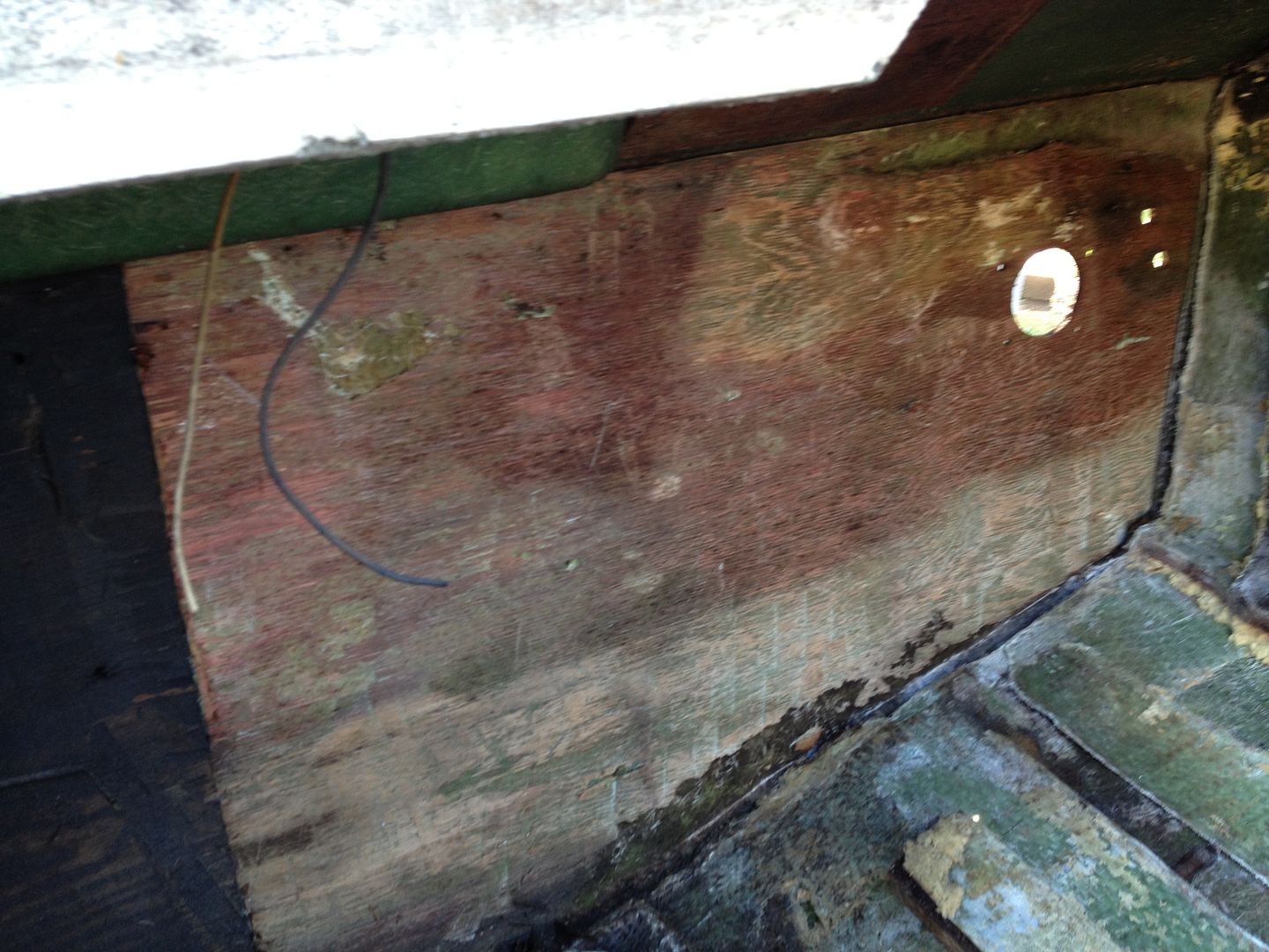

Also removed the port side Transom - Looks like they used a thin sheet of Mahogany/Luan ply with a sectioned plywood face glued. The plywood was severely rotted:
