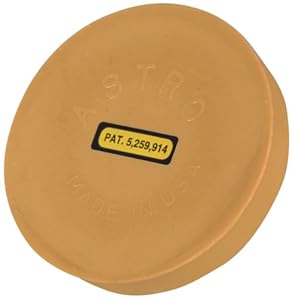

How are you removing the pinstripe?
If you're not using a pinstripping removal wheel:
You can find it w/ a google search
perhaps it's the removal method that's causing chipping. Because the method could chip either gelcoat or paint, easily........
