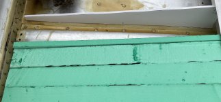

Well, if you insist! 😄. One thing to point out, too, is that some of the floatation foam pieces appear, in the photos, to be standing proud vertically and look to not present a uniform flat surface for the flooring. This is caused by the back surface mating tightly to the inside of the flooring rails. When the knife blade exits the foam it sometimes wants to wonder and leave a small “lip” on top of the foam pieces. It all presses down uniformly though and creates a nice flat surface top for the new flooring. If needed, I can always cut the foam interference down as required. 🙂

Working on the boat with the Admiral today and she said she was enjoying it. Can’t beat that! We are cutting/adding more floatation foam. One tip: when cutting the actual floatation foam pieces from the foam board, mark a “B” on the bottom edge so that you can install the individual foam pieces correctly. And onward we go!

Beautiful afternoon with mild temperature and plenty of sunshine so we took the opportunity to put more floatation foam into the boat. Have to pay attention to the bottom rib curvatures now as part of the task. Glad I started placing the floatation foam at the stern first, and am working towards the bow, as I have the confidence now to continue the task.

Had one of those palm slap to the forehead moments this afternoon while adding more floatation foam into the boat. Instead of cutting the foam edge off at an angle (which didn’t always turn out so good on the first knife pass 😲), where the foam piece sits against the riveted rib flange, I decided to just right-angle cut the edge off the foam. A 5/8” horizontal cut on the bottom side and a 3/8” vertical intersecting cut does the trick. Quick to do and the foam piece sits correctly and neatly on the hull. Just a little tip for those who are interested. 🙂
