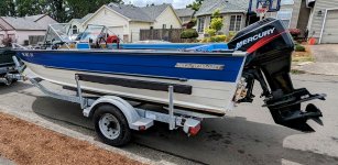

Well it floats! Not a drop of moisture in the bottom! Not registered for this year yet so took her for a spin real quick for about 3 minutes half throttle. Working really good no hiccups! More pics to come....

well been a few since last post, pics of boat the water and some cosmetic changes to the bow area..... carpeted and framed out the seating area, also sanded down the rust along the molded area up top, then painted which the kid said was a good and cheap decision. runs like a top floats without intrusion of water, goin fishing in the a.m. hopefully put a 'nook on the boat!!
