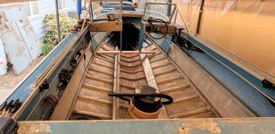

Boat was donated by my neighbor who didnt have time to restore or make seaworthy so the beginning starts here .. lots of work and $$.. as it was given to me .... Thanks Randall!

Future endeavors include transom replacement, 75hp merc runs well low hours, needs a tune up im sure, some minor hull damage ive already started tackling, as well as new floors, these were toast! Its a 2 year project im sure

We should get you moved over to the Starcraft boat section. Bunch of tinheads there to help you out who are very familiar with these boats.
Overall she is in great shape! The strake being the worst, does the hole go all the way through the hull?? Either way its patchable. The strakes are not water-tight anyway.
The 75 merc should be a great motor for it. I see all the trim is there, and minimal scars of people poking holes for stuff. You have yourself a great canvas to start with!

Welcome aboard 1978 stabler. I had a 1973 that looked very much like yours. You are very fortunate to have such a great gift.
Good luck with the restore, will be watching your thread closely. Anything I can spot to help you with I will.

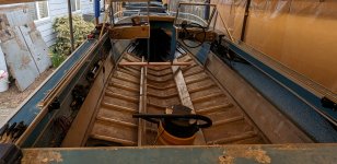

another cooler overcast day, tore out most of the rotted floor and styrofoam, another 4 ft to go..... also put up a complete cover so entire boat out of the direct elements.... bought a gajillion dollars worth of Gluvit and spot filler for the hull after a good scrubbing and minor patching we will seal her up!

Can see you are moving along very well. Love your shelter, going to start shopping for one.

got the last 4 ft of flooring/deck out from under the consoles. wire brushing all the seams and rivets then applying 2 gallons of Gluvit.... should be more than plenty to seal up and lil sucker holes and cracks...

got the last 4 ft of flooring/deck out from under the consoles. wire brushing all the seams and rivets then applying 2 gallons of Gluvit.... should be more than plenty to seal up and lil sucker holes and cracks... cleaned up and brushed .... all spiffy... sorta

Thats a lot of gluvit! Are you coating the whole bottom? Think I only used 2 pints of coat-it, same thing, and still had some leftover just hitting each rivet with a splotch, plus seams.
Just keep the can covered with some plastic wrap or it will start to thicken on you as you work.
