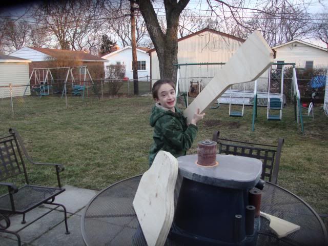

New transoms.
The oscillating spindle sander from Harbor Freight is awesome. It made short work of any edge sanding.

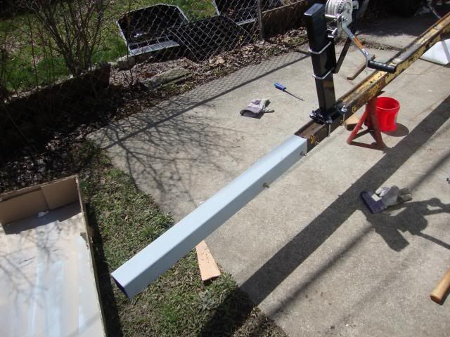

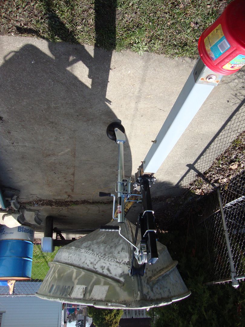

Rain, snow high winds, torrential downpours. This weather is not good, it snowed Friday night here. Well I finally went back to working on the boat. I worked some Saturday and all day Sunday. Got a bit accomplished.
Trailer is officially 3' longer!
Here I scabbed some steel on the outside of the tube so it would just slip inside the current tube.
Then I slipped a 3" square tube over the inner tube and bolted it all in place. Primered it too. This summer it'll get painted Sun burst yellow. I'll redo the whole trailer and pretty it up.
A new trailer jack from HF, $20.00.
I also removed the end caps. Previous owner used all steel fasteners. It was a hoot to get them out. Grinder and drill and punch until my ears rang. Hey it's over now. Zach and I loaded the boat ourselves, just winched it on the trailer. Nah it didn't tear up the wet lawn...a lot. Don't tell SWMBO.

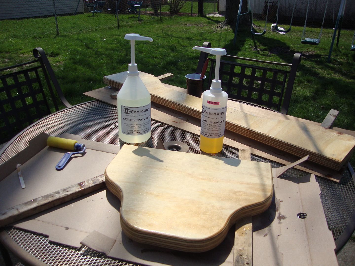

Well it was 37 degrees out this morning. It's warmed to 55 by 10:30 so it's epoxy time. I've got one coat on all edges and one face. Both inner and outer pieces. Looks to be a nice day. Catch and release for smallmouth opens today on St. Clair. Bummer I'm not out there.

Hey GA the extension is just a tube bolted on. It doesn't look stock but it looks sturdy. Once it's painted it won't look half bad. Check it off the list and on to the next item.
Second coat of epoxy is down. All edges and one face. The bottom is still plain wood. Tomorrow two coats on it.
Question;
I'm going to paint over the epoxy. Any special prep for this? Primer I suppose, but just plain Rusto primer? It feels good to not have snow in the old outdoor workshop.

I am scuff sanding my epoxy, wipe with acetone to clean and prime with rusto primer. good luck and getr done.
