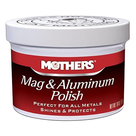

Get some Mother's Mag and Aluminum polish. It works great on all the SHINY Stuff!!!!
