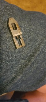

Hello every1 new here I'm trying too find out if anyone could help me find points for my 1947 sea king it's a montgomery ward 2 stroke 5hp model 74gg9012 serial # 152352 had it running till a point bracket broke

This is the point broke

That was made by Johnson / Evinrude.------Visit ----aomci----Lots of folks will have these breaker sets.-----Should be easy to find.

Johnson for gale what I'm trying too do is get the points set so I can get it back 2 running again I'm trying to find the specs too set them
