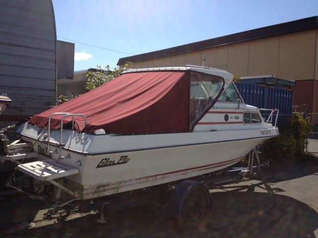

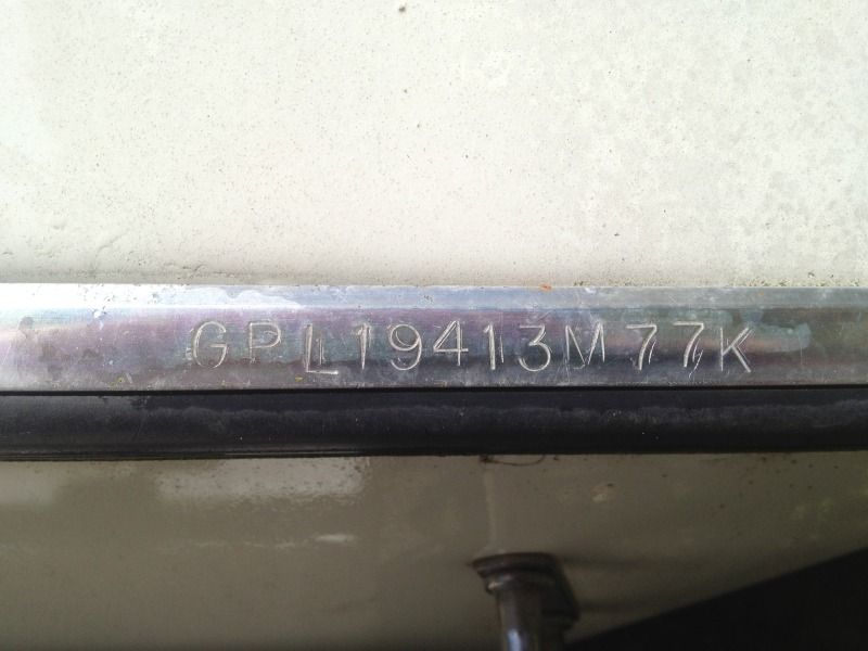

So i was running my 17.5' K&C thremoglas and it's served me well. But i always dreamed of something bigger. We all have our dream boat in our minds but all I really wanted was an 80's hull. Maybe 20+ feet and new outboard power. I would restore it and it would be awesome. So I started browsing the local online classifieds. I found a couple really good hauls but nothing was right. I made a few offers on other boats but nothing felt right. Then I found this beauty. I went to go see it and the price was right in my budget. A 19.5' glasply. It was beautiful. Big and spacious. Far bigger than I was used to. But she was big. And heavy. Wasn't going to be towing it with my jeep tj. And my 1990 f-150 was a POS. So. What to do? Well the excitement got the best of me and I made an offer and was the proud owner of a new to me boat.

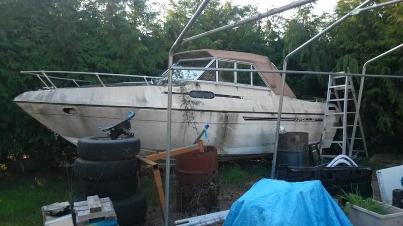

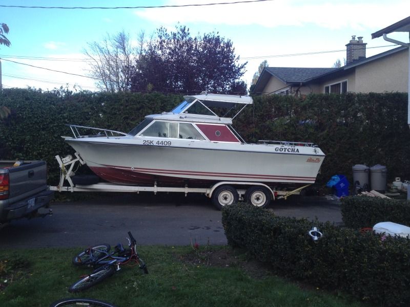

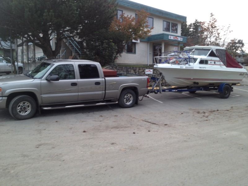

So this was how it sat at the storage place. I dragged it home with the ford and it was very apearant that the axle was bent and damaged. Leg was off. Needed a new shift cable. Motor hadn't run in a little while. Interior was rough. Hull Needed to be cleaned and buffed. Trailer lights were kinda working. But had agreat honda 4 stroke kicker. Newish SS prop. Stereo. Came with down riggers and the canvas was in good shape. Again. I was in love. But I needed a vehicle to tow this mammer jammer. So picked up an 03 GMC 1500 HD. Which cut into my budget for boat repair.
My current goals for this is to be able to hit the coho derby in port renfrew, BC oct 5,6. Past that. It will be a new interior, upgrade the wiring and a repower when the 470 goes.

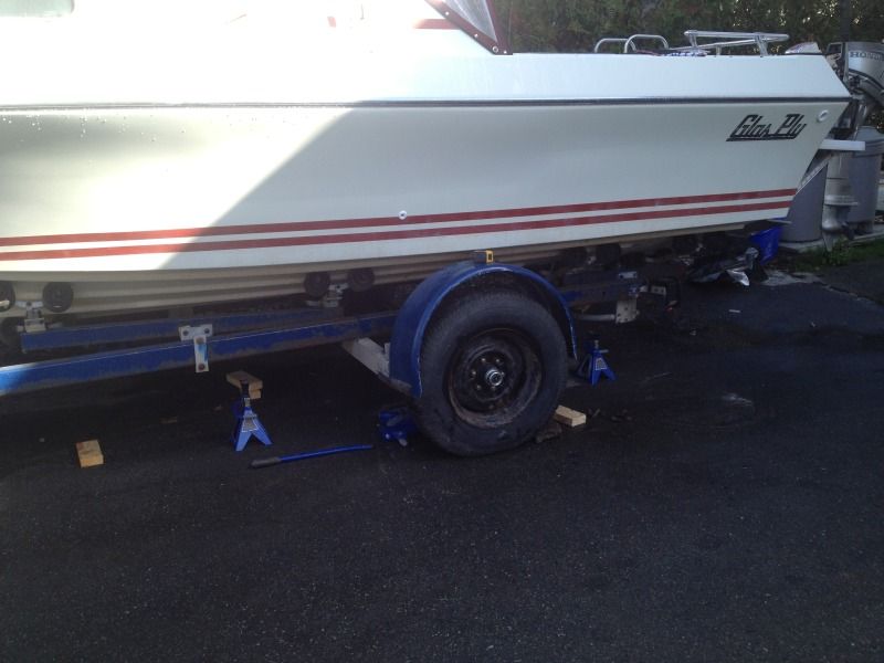

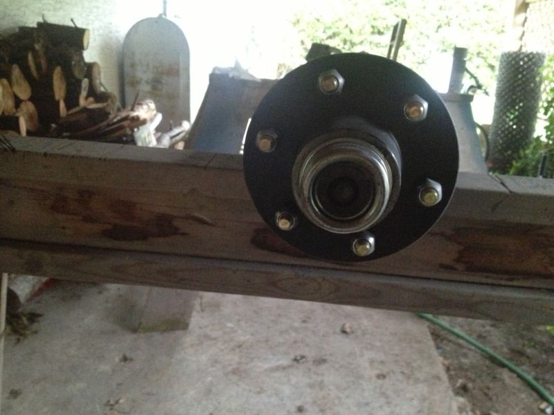

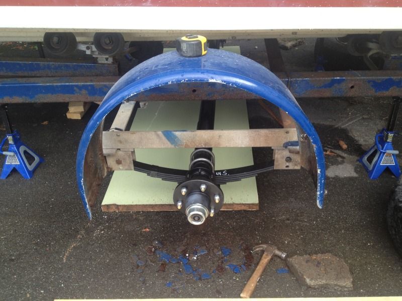

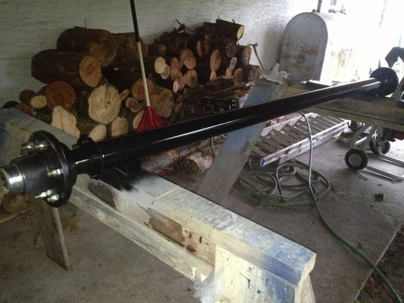

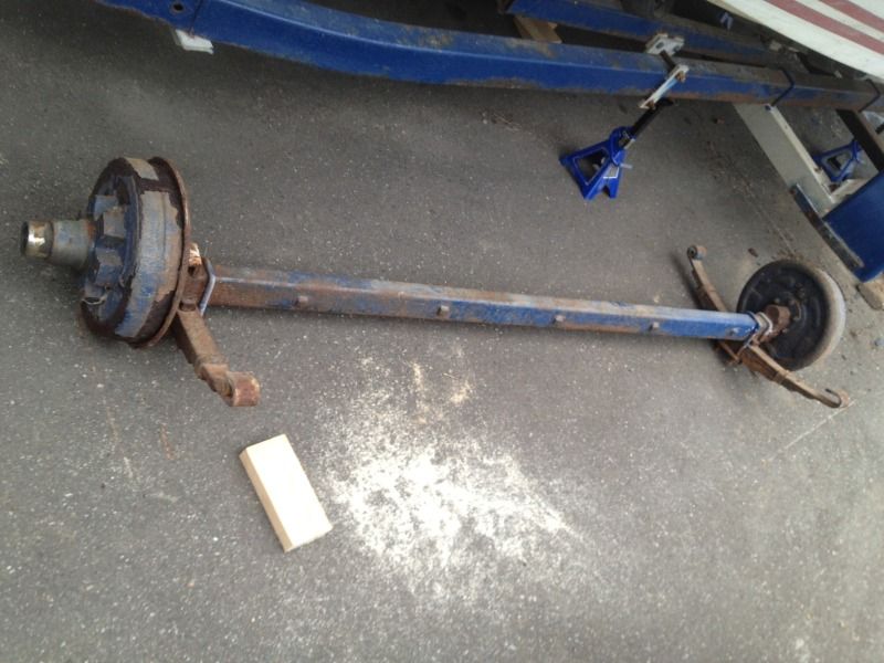

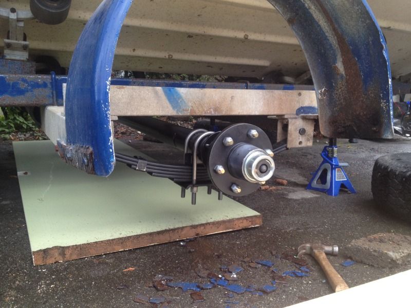

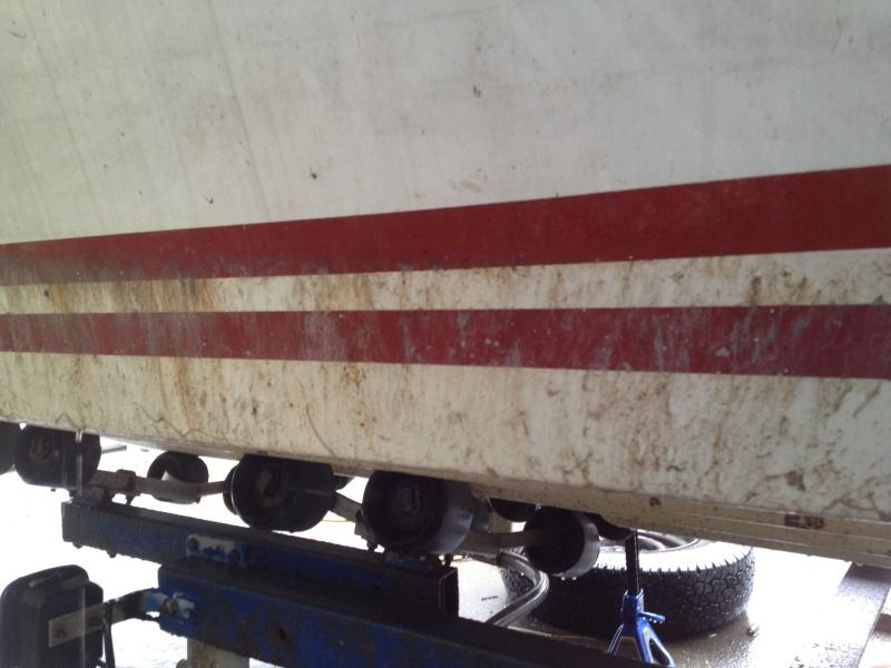

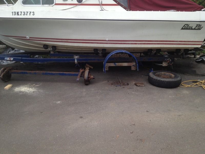

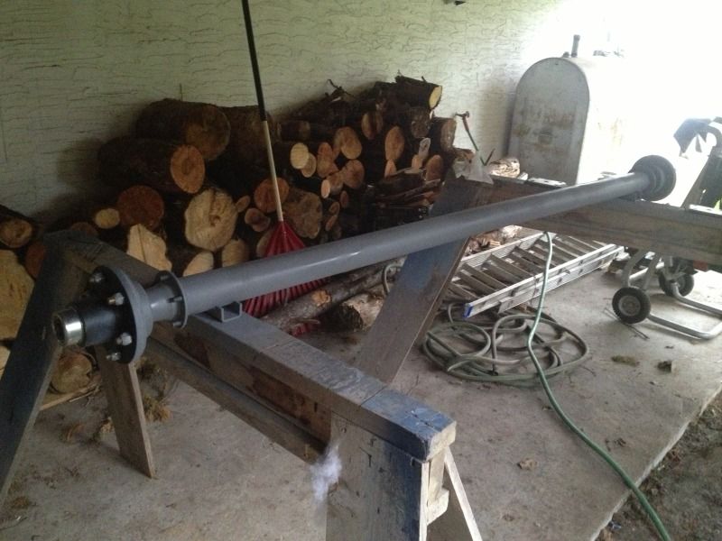

First on the list was dealing with the axle. So the trailer went up on stands and cut the axle out. It was a drop axle and the spindle had a good 5-8* bend in it. Someone had tried to weld a peice of metal to support it but to me is irresponsible concidering the size of boat. If that busted on the highway?
Buddy of mine owns a local suspension shop so I ordered a new 6000 lb axle and 3500lb springs. Figured the boat was around 3000-4000 lbs. might as well get a beefy axle with strong big bearings.
The old axle was only a 3500 with old corroded drums someone had taken out of service. Surge brakes will also be on the menu.

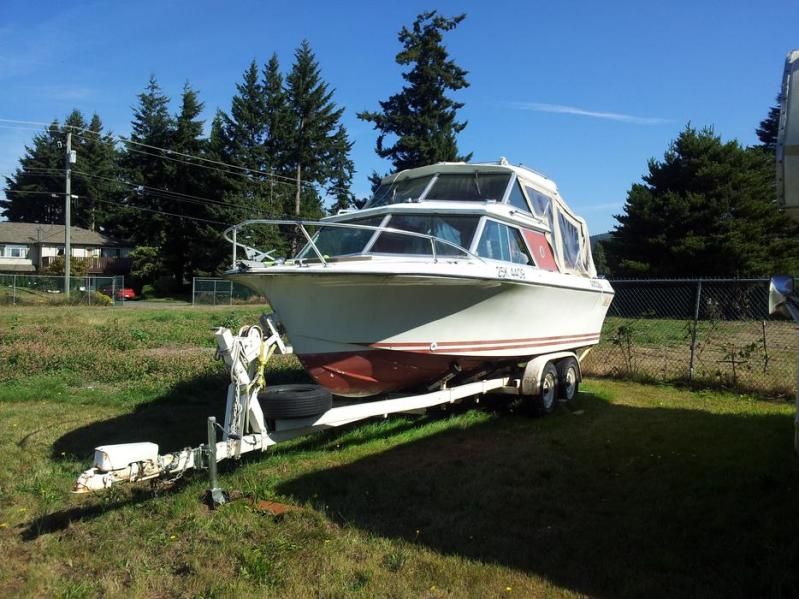

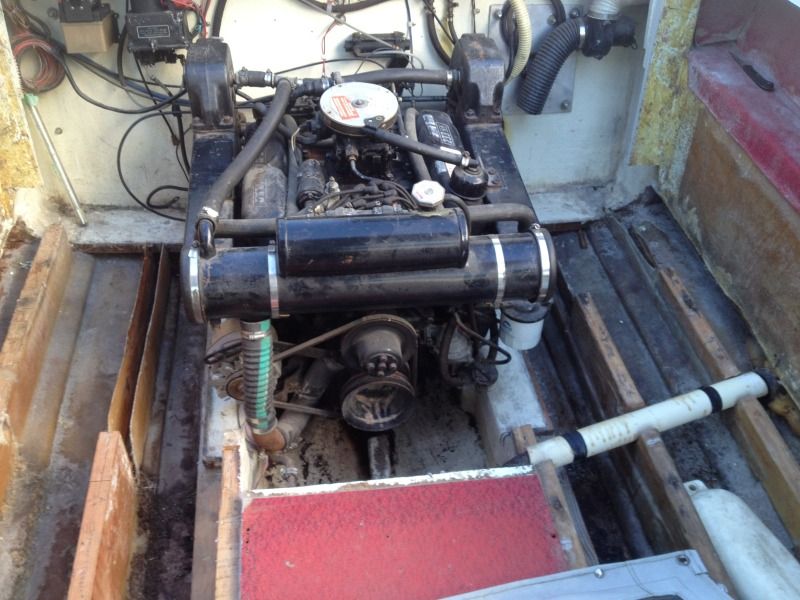

The axle would take 2 weeks so in the mean time I had to become more familiar with the boat. Found a manual online for $15

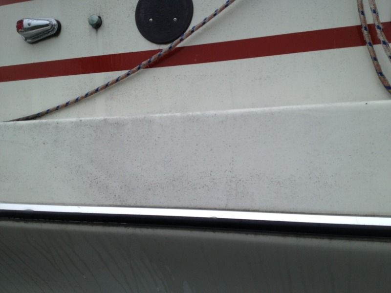

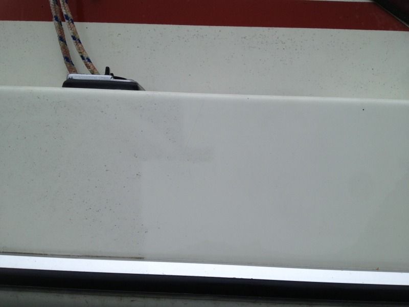

And took to washing and polishing the boat.
Pre wash
After some pressure wash fun
Used some 3M boat compound. Took off all the oxidation and grime. Still have to wax.

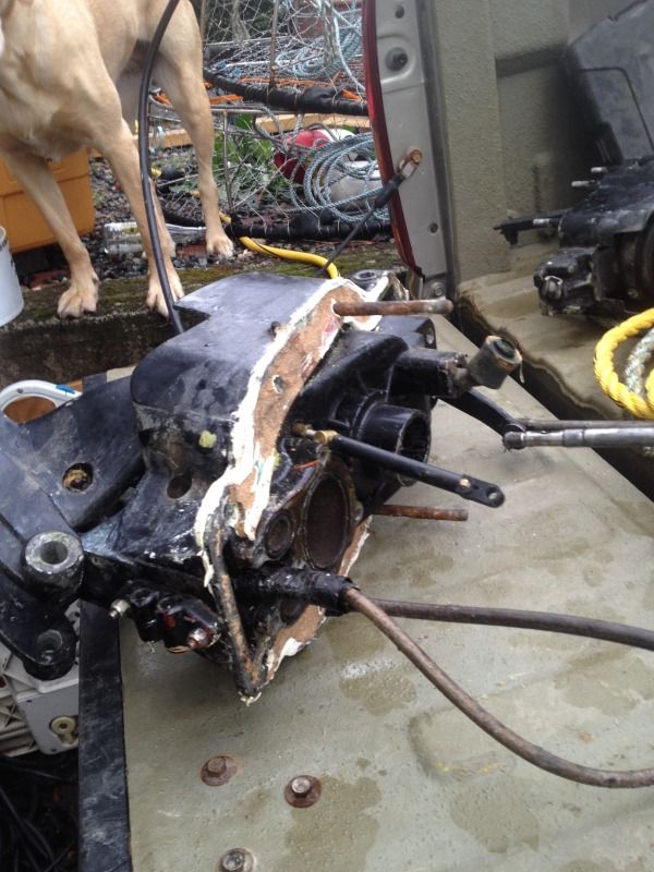

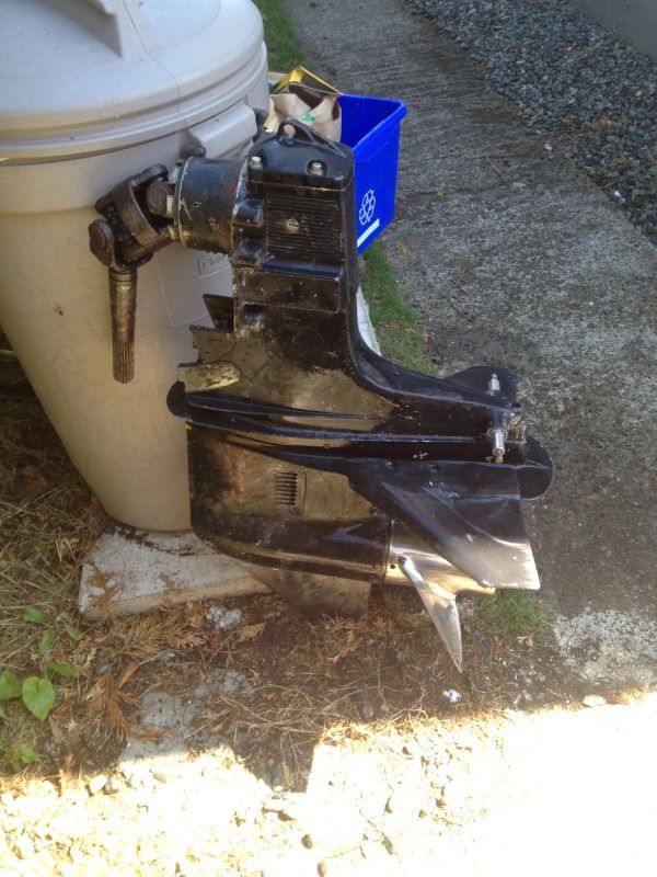

I have been a little apprehensive in repairing the leg and reattaching. Only because I don't want to pay for all new seals just to find out something else is rotten and needs replacing. But after much research and youtube watching I'll be doing it. So Monday I'll order up some parts but today I managed to get the trailer back on its own tires.

Axle came bare steel so some self etching primer and a coat of paint.
Put the leg on just so I could see if I could duplicate the problem and run the engine.
After a little maintainence she fired right up.

Well it kills me to pay someone to work on my stuff but with the amount of work I was doing and the daylight getting shorter and shorter and the derby being next weekend I was seriously running out of time. So on Tuesday I bit the bullet and took it to my buddies mechanic. He is the lead mechanic at a local marine shop and just moonlights on the side. After talking to him for like 40 min he seemed like a really good honest guy. So I was happy to give him the business. I'm also glad I did because he found some things that I wouldn't have and said other things were ok that I thought weren't. So I dropped the boat off at his place and left feeling better. Till I went back the next day and was told the leg was shot. And repairing it would out me over my $800-$1000 repair budget. I was a little bummed and in most situations probably would had just took a step back and reevaluated things but I really wanted to go to this derby any had 4 other buddies that were supposed to go with me. Luckily all my obsessive late night online classified searching has paid off and saw a used alpha 1 leg for $500 on a local site. Got it for $300 and it looked to be in good shape. Ujoints we solid. Was told it had a new impeller. The oil was new so was unable to see if it has flakes and metal chunks like mine in it. Being this was only my second boat purchase I am now more familiar at what to look for in a purchase. Live and learn. So he's replacing the shift cable and shift cable bellow. Gimbel bearing and exhaust bellow are in good shape. He fixed some electrical issues and just gave the boat a good once over. Said spite these extra costs he still believes I got a good boat for the price I paid. So that's always good to hear. Probably could have paid less knowing what I know now but here we are. I am back on track for a schedual. Hoping to get the boat back by Tuesday.

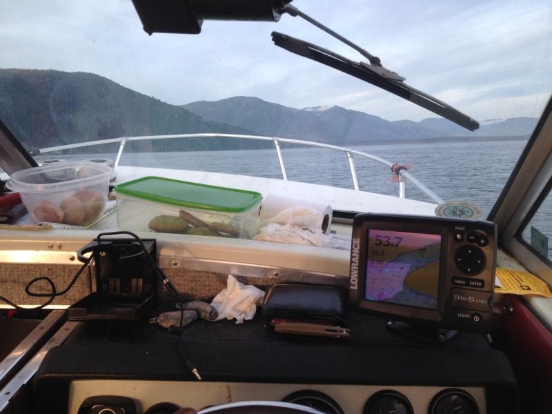

Even made grilled cheese on the alcohol boat stove. Great day. But then The kicker keeps stalling to the point I can't keep it running. So I decide to troll on the main motor. She ran great all day. 700rpm at about 2-3 mph. And we were slayn' fish. Hit after hit after hit. The motor happy temp in 160 on the gauge. It started to climb a few times up to 175 and once to 180. So we'd pull up gear stop and add some fluid. Temp would lower and we would be all good. Spent about 10 hours out on the water total. Amazing day. But we had to get in because the lower tide would not allow us to enter the mouth of the marina.
So we grab our traps.
And head on in

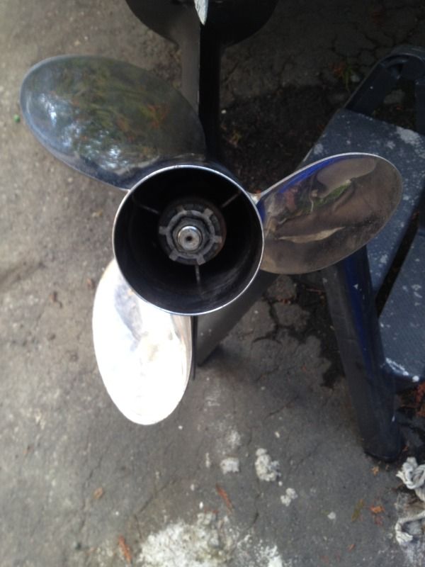

I was really confused why we couldn't get up on plane earlier but after some time to think about it and feel the boat out and is it ran I figured we were just too heavy. I weighed the boat at the truck scale on the way home today and it was 2300kg. Thats just over 5000lbs. So minus 800lb ish for the trailer that puts the boat around 4500lbs. Add 600lb of man another 200 for gear and a lot more for fuel (filled all three tanks) she must have been well over 6500lbs. On the way home after burning a bunch of fuel she would get up to around 15.8 mph. So a re prop is in order. For an immediate fix.
Jasonfast
Seaman Apprentice
Jun 21, 2015
34
There is a sand bar at the mouth of the entrance to the river to the marina and at low tide it Leaves about 2' of water at low tide. So we cross and this big mofo of a bay liner (28' ish) comes in and was too far to the right and they hits bottom. They were stranded. We turn around head back behind them to pull them backwards. And I guess in all the excitement I wasn't watching the temp gauge because while I was trying to pull them out the motor over just cuts out. And won't turn over anymore. Now we are stranded. We set anchor. The guys in the bay liner jump out of there boat and start rocking it and with that and some waves coming it the get it free and use their kicker to troll away. Leaving us stranded now and take our rope as well. Didn't say thanks or nothing. Wasn't impressed. Another boat behind us tows us in and we make it back after waiting an hour or two for the tide to come up a bit.

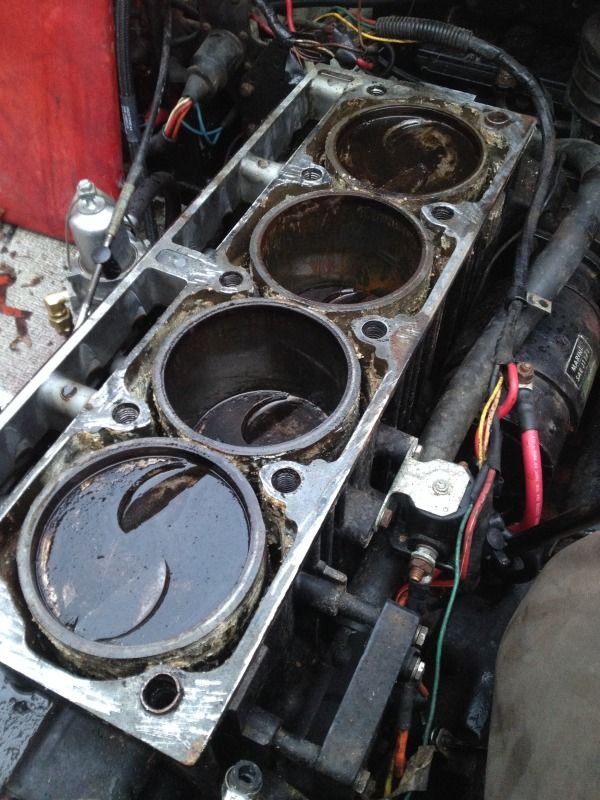

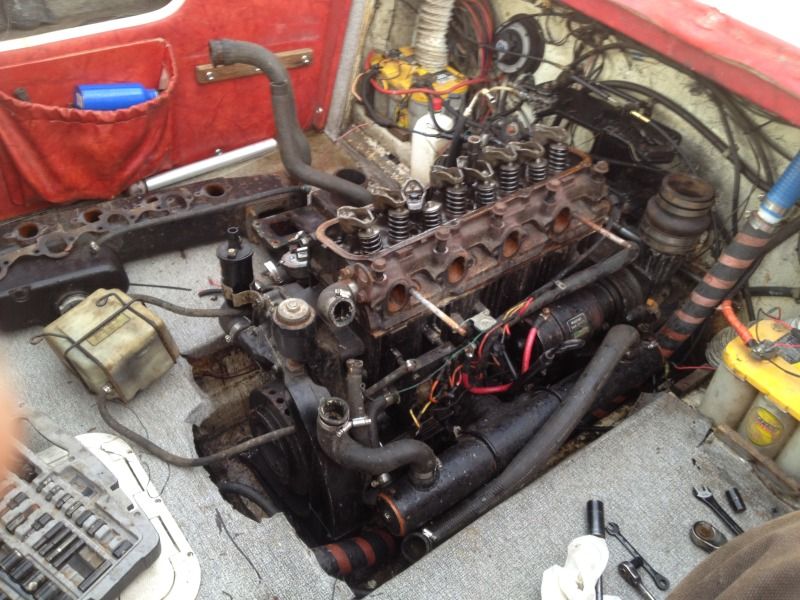

So we pull the boat out of the water and go feast on crab. Didn't get to fish today (2 day derby) but with all the excitement we were pretty pooped anyways. So I get the boat home and I pull the plugs. Back two cylinders are full of water. So I'm assuming head gasket. So I dig on in since it was a nice day out. With the plugs out I crank the engine to push out most of the water and listen for any mechanical damage. It all sounds ok. No busted internals.

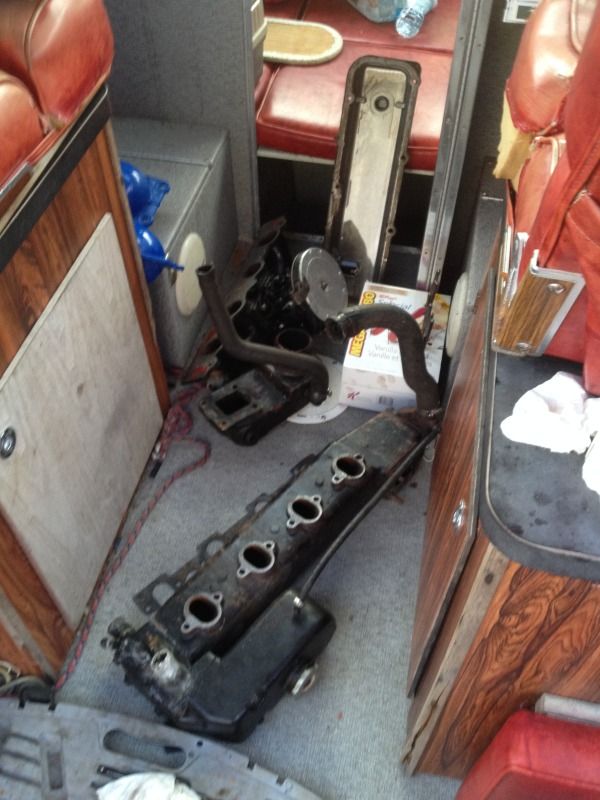

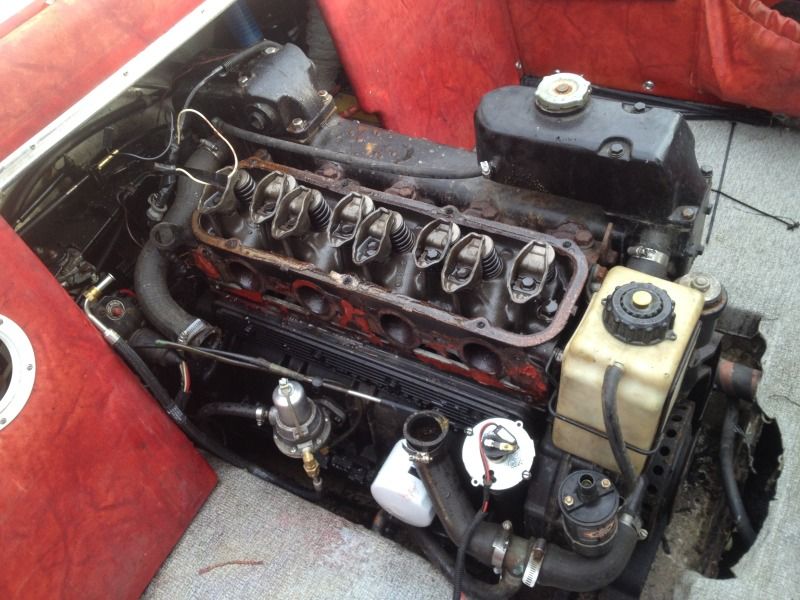

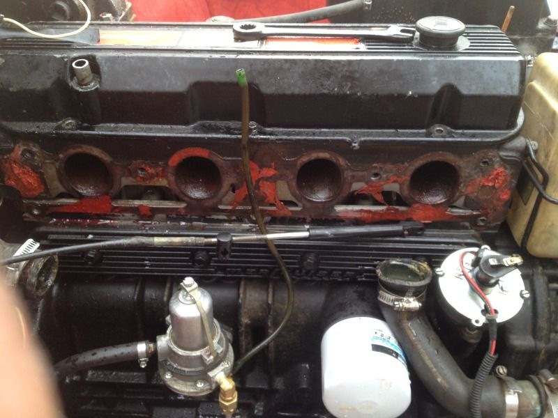

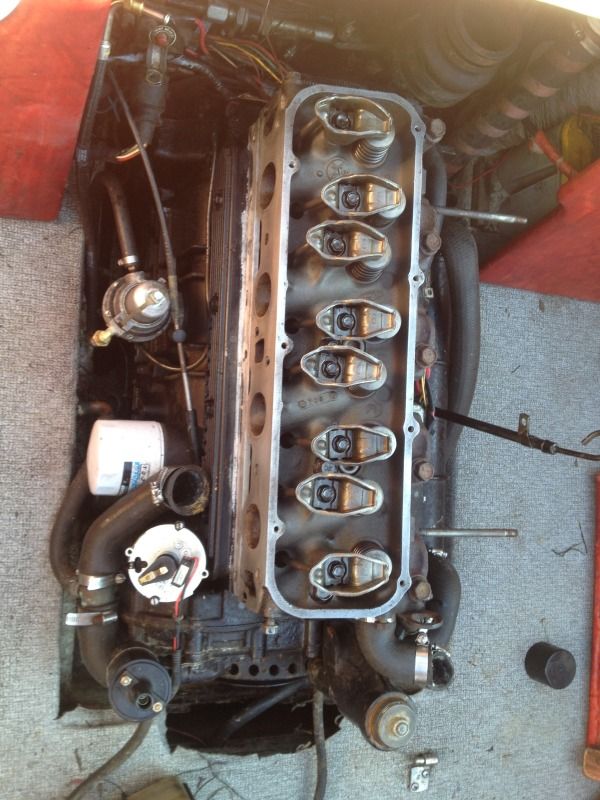

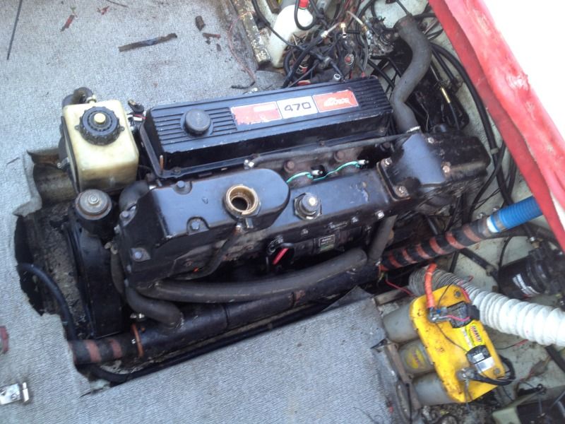

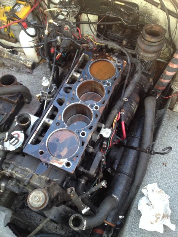

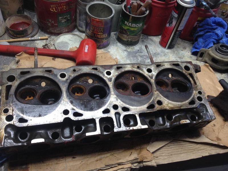

Intake off
Have to pull exhaust manifold as well to get the head off.

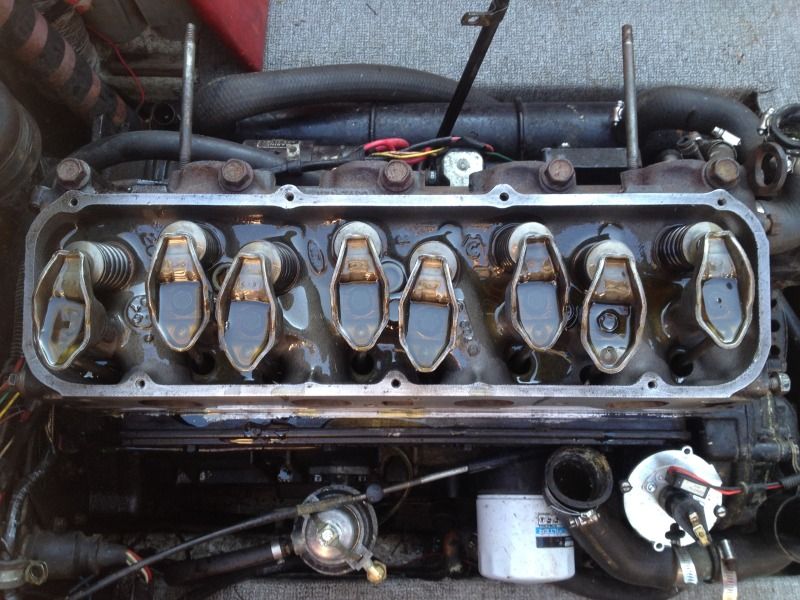

And a row of head bolts are under the rocker arms. So off come the rocker and push rods.

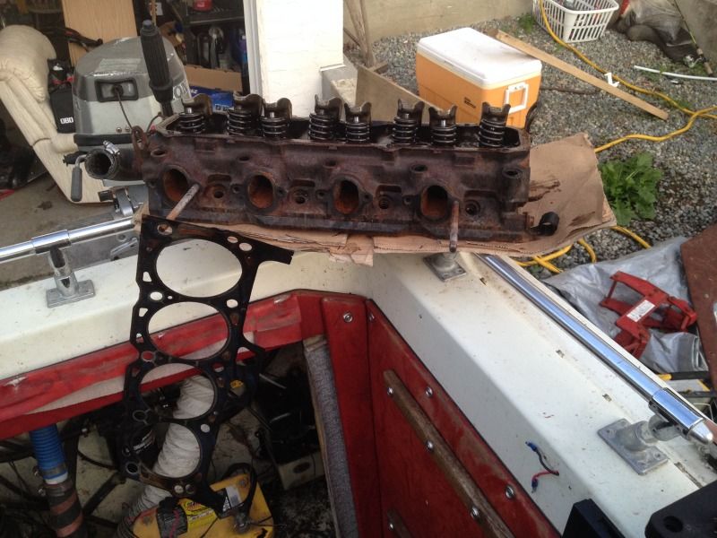

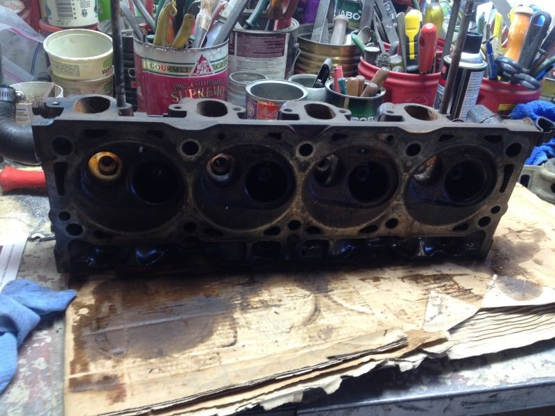

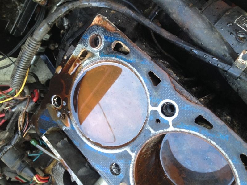

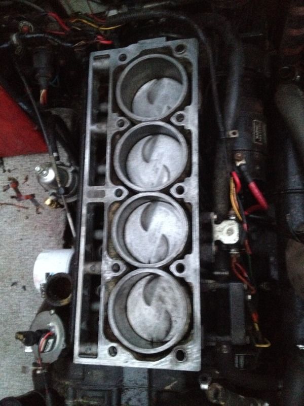

Off comes the head

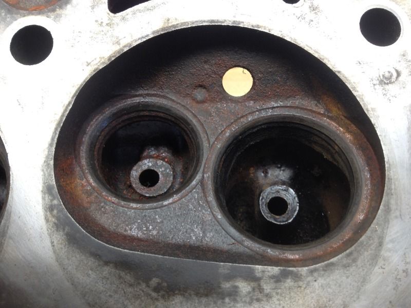

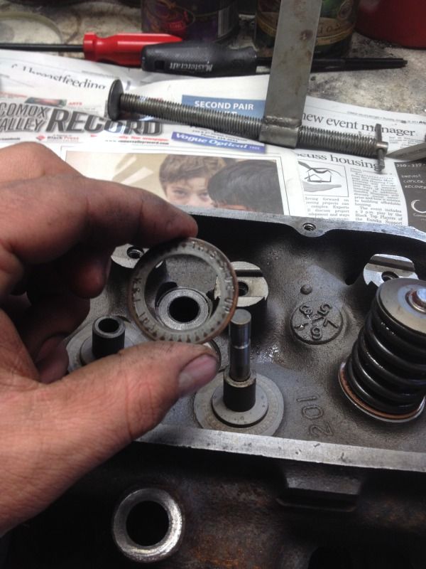

Oh ya. There's your problem right there!
So I'll order some new gaskets. But still not sure why I was loosing coolant at first. If the two were related? Or is it still leaking else where? But ya. This also sealed the deal for a re power. Found a 351 Windsor on used victoria. So if all the parts are complete and in good shape ill have a new engine to go in. We did this on my brother boat and with the purchase of a core engine, Full rebuild, convert to EFI and build a custom ecu we got it to around $2150. So I'll be sure to post up about that when it happens. This Xmas I'm assuming. But spirits up and I love the boat. Handled the open water great.

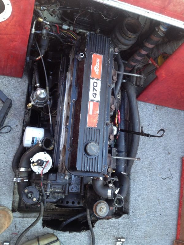

Well alright. First off happy thanksgiving to any other Canadian members. Saved some of the work for this weekend when I headed up island to my parents place. Dad has a way better shop setup than me. He has a 4 bay garage. I have a driveway. Anyways picked up head, intake, exhaust and valve cover gasket along with a new oil filter and oil. Grand total of $95 so that's awesome. As for the water pump, couldn't find a part # for the water pump so may have to go to merc directly. Was at napa and they supply marine parts. For starters I took at look at my prop and it is a 14.25 x 19. Mechanic that did my leg suggested a 14.25 x 17. When I only had $50 in gas (around 40 L) and just me and a buddy max speed was 29.5 mph (as per GPS). Fully loaded I could get on plane. So I'm looking for a smaller prop.

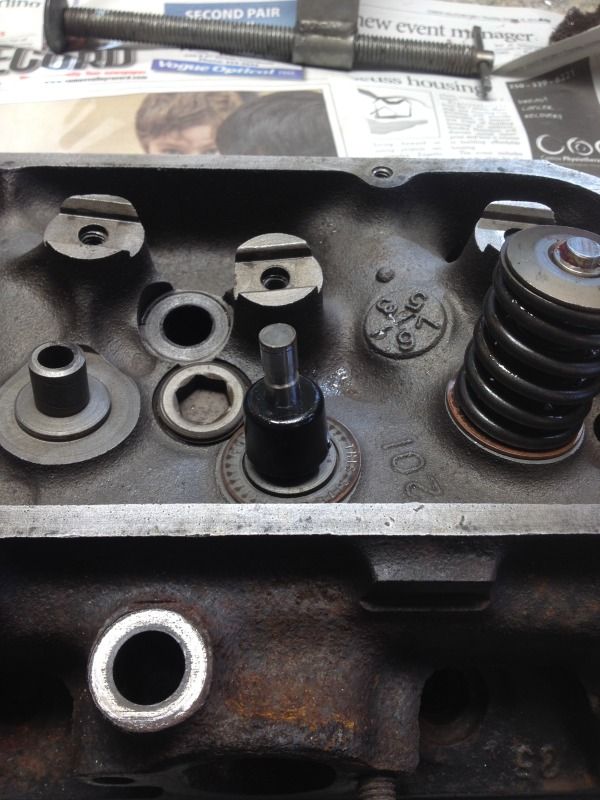

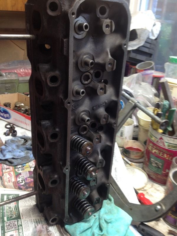

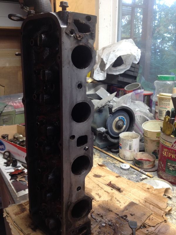

Till then I focused on getting the engine back together. So with everything torn down it was time to do so cleaning.

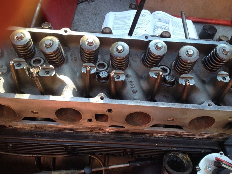

Since the head was off we figured it was best to do a full tear down and inspect. Once it was all torn down we realized it was in pretty good shape and didn't need it but we were all ready there so. Ya.

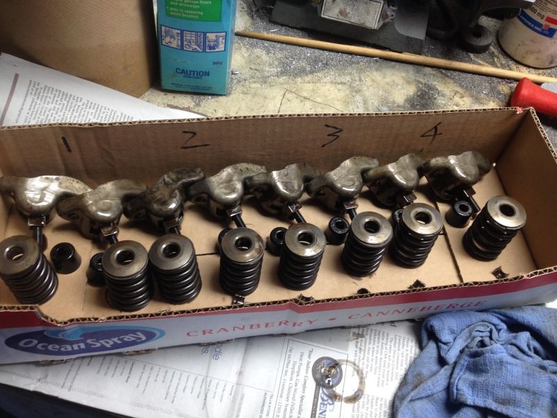

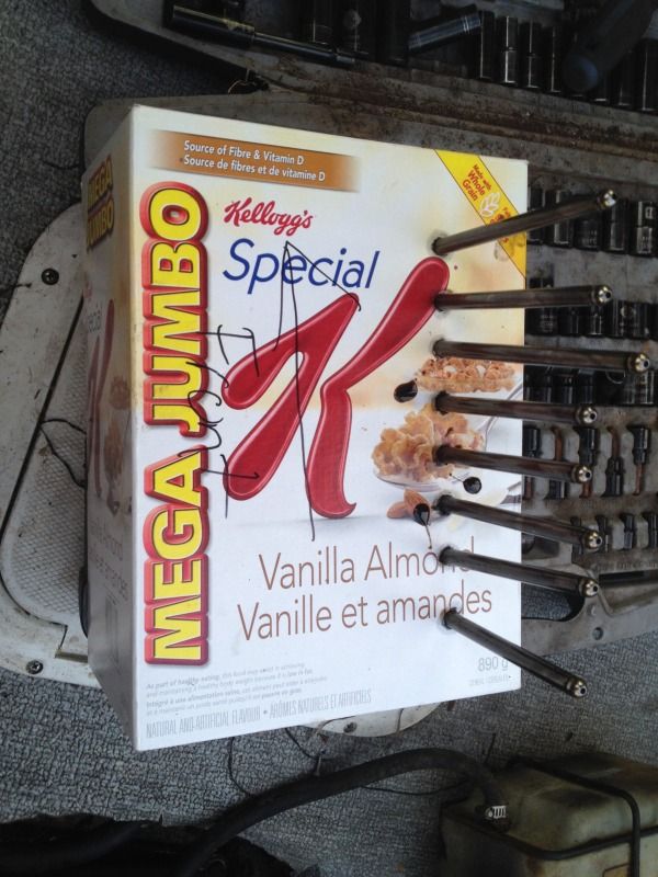

Removed rockers and pulled the valves
Keeping it organized.
Started by cleaning all the matin gasket surfaces
Surface rust from blown head gasket
Almost there

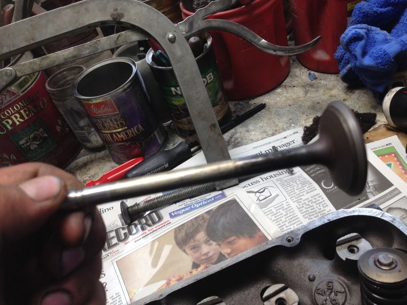

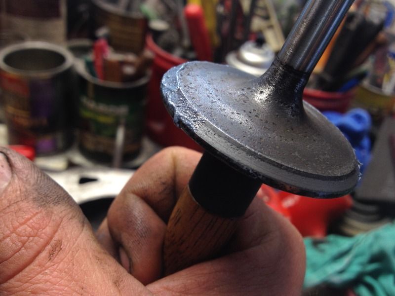

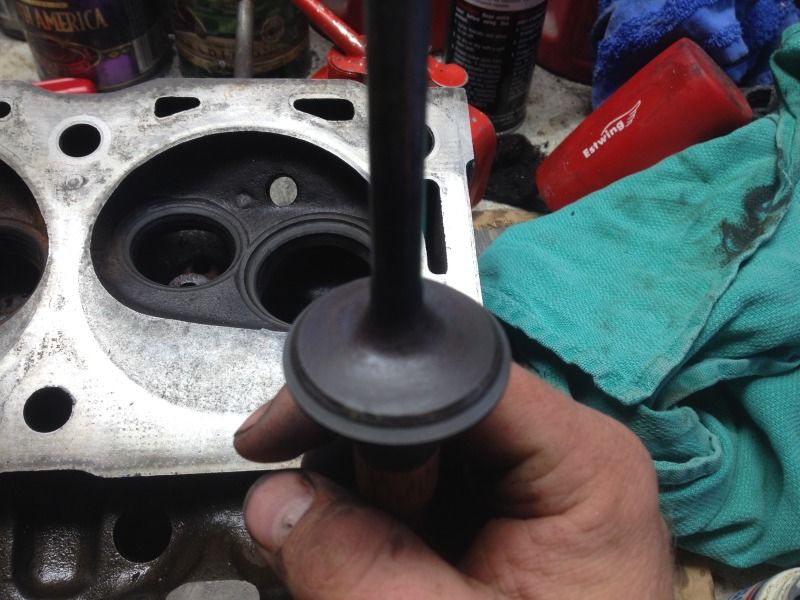

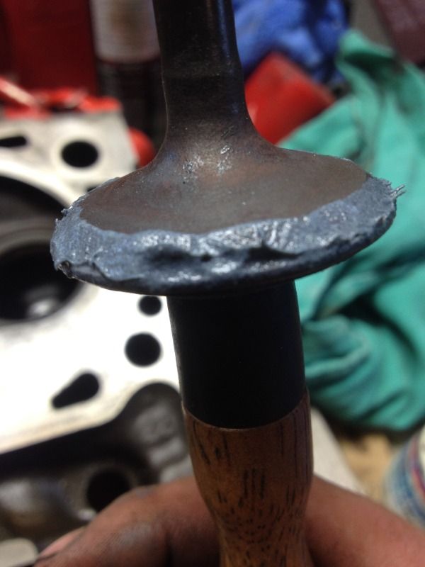

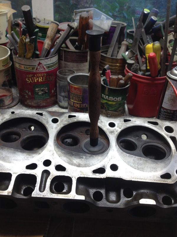

Once all the real messy parts were dealt with it was time to lap the valves. They weren't in terrible shape but had some pitting and could use a little tune up.
Some lapping compound
Jasonfast
Seaman Apprentice
Jun 21, 2015
34
Still some lite pitting on the seat surface
Perfect.
Only 7 more. Beats the last 32 valve motor rebuild. That's a lot of elbow grease!

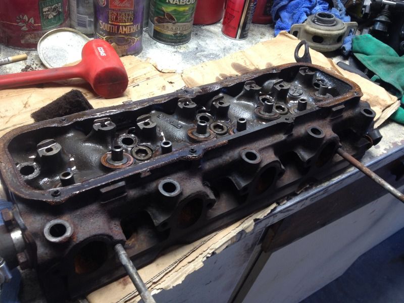

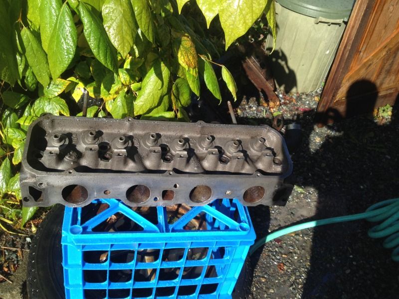

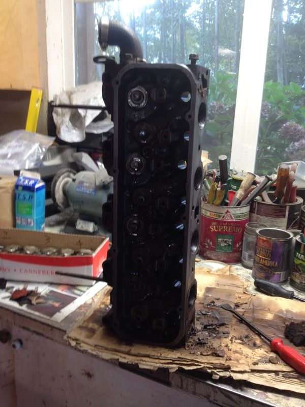

Once all the valves were lapped I took the head out side to degrease and pressure wash.
Much better
And blew out all bolt holes and cavities with compressed air.
Jasonfast
Seaman Apprentice
Jun 21, 2015
34

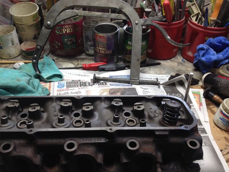

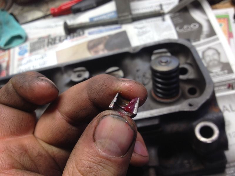

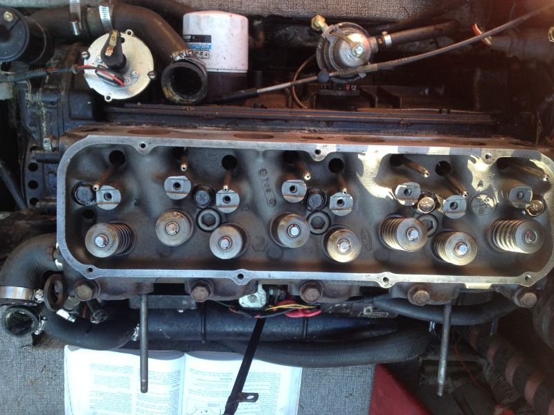

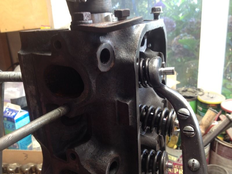

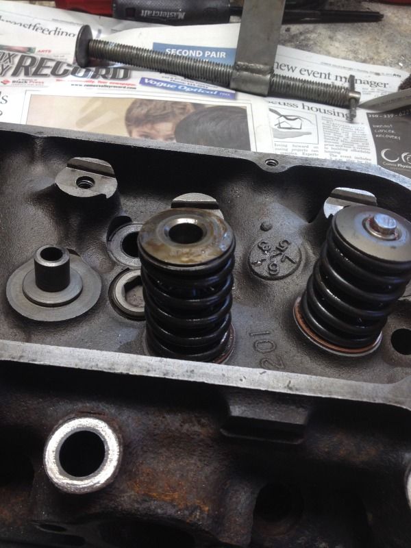

Oil valve stem
Spring seat
Oil seal
Spring and retainer
Little grease on the locks to hold them in place
Compress and repeat
Jasonfast
Seaman Apprentice
Jun 21, 2015
34
The manual spec'd that one should decarbonize prior to install.
Before
After

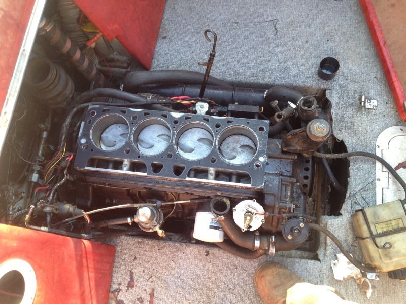

New gasket
Head
Pushrods back in
Rocker arms
Some prelube
Cover
Exhaust
Then I ran out of time. Continue on tomorrow.

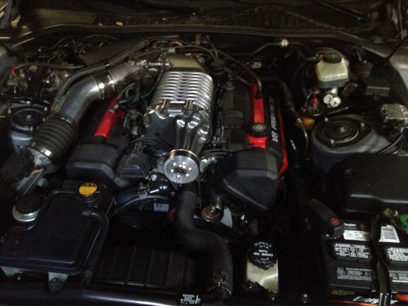

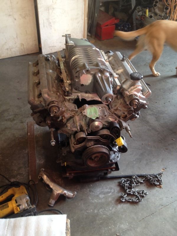

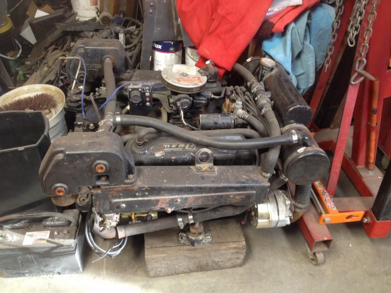

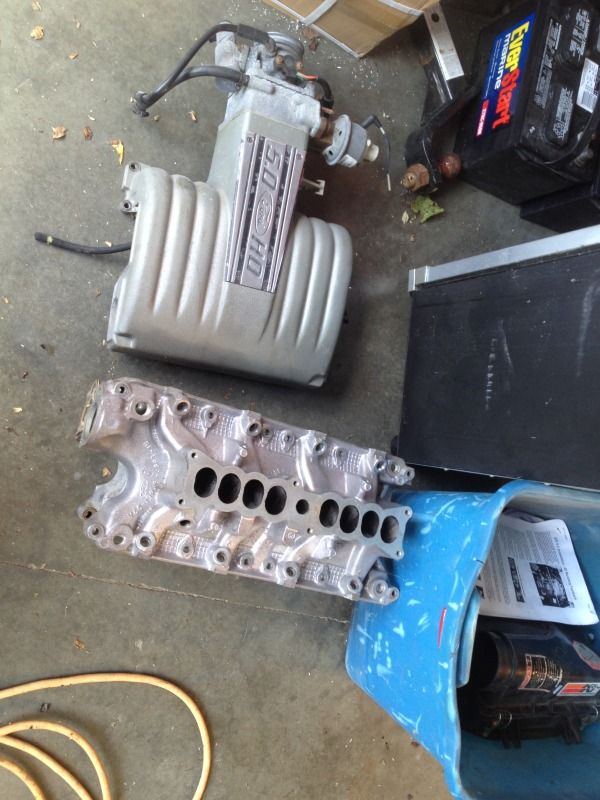

Now the part that excites me. I think we've settled on a 302 for a repower. We found a complete marainized motor for a somewhat reasonable price. We will offer what we think is fair and if it happens great. Already started collecting EFI parts to convert it over
Also my dad and brother both have Lexus sc 400 that they converted over to manuals and tossed factory ford superchargers onto.
There is no real aftermarket support for these Lexus 4L V8 and what there is is brutally expensive. So my dad made his own manifold and had a local welder weld it up. He sells these kits on a Lexus forum. Anyways long story short we have a few extra supercharges kicking around and figured. Hey. Why not charge the 302? The charger will fit the motor as they come off 302 mustang motors. You can find them cheap as guys upgrade their chargers for rouch racing stuff. The question I'd if we will have room around all the heat exchangers and such. This will also be done around Xmas time. So I'm excited. Here a motor setup we are doing for a guy out of North Carolina.

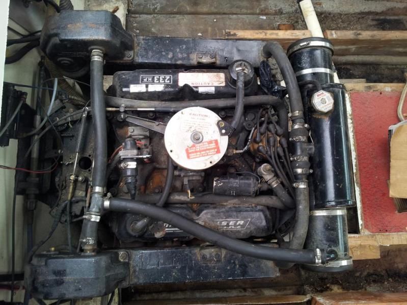

So motor has been running well. Went out on Saturday night after work and it was amazing.
Video: http://youtu.be/evBcvpqpI10
But I definately have a coolant leak. It's not going into my motor. 100%. Making me think perhaps there is a crack in the exchanger or exhaust manifold and it's going out the exhaust? I found a heat exchanger locally and may pick it up. But we will see.
More importantly found a 302. For free. Even comes with a boat.
The boat is pretty much toast and I'm not gonna do anything with it. The motor is complete but can't be seen running. Also comes with an alpha one leg. But for free who cares. Just one step closer to a better boat.!!!

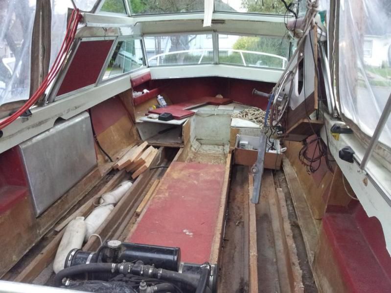

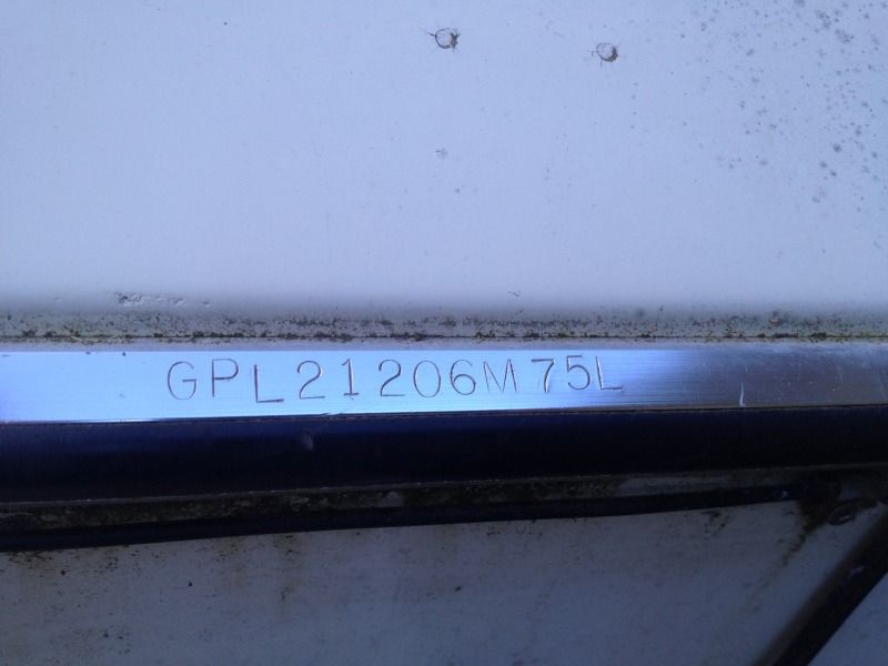

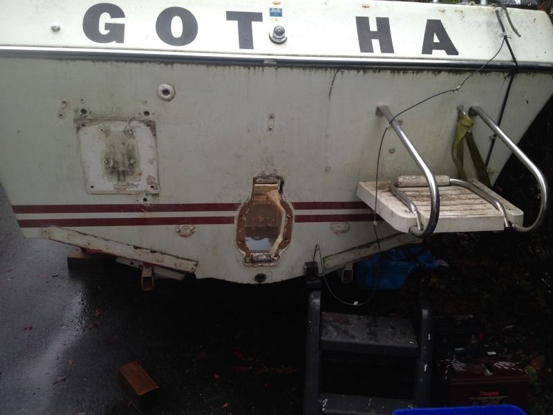

So I think I have a problem. A boat problem. A boat hoarding problem. Before I joined the site I had one boat. Like a normal person. Then I bought the glasply. And then I bought 2 more. Who owns 4 boats? Anyways. I knew you guys would understand and not judge me. But surprisingly enough the WAR is at a solid 9.5. Or in my case GFAR.
Plans have changed slightly. I ended up pulling the 302 from the Apollo. Solid it to a guy for $200. Sold all the 302 EFI parts for another $100. Which covered the dump fees of the Apollo. I then took the $200 and got this gem.
1975 21' (trailer not included- let me borrow it for a week)

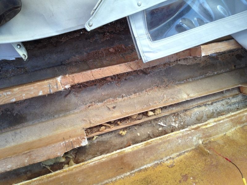

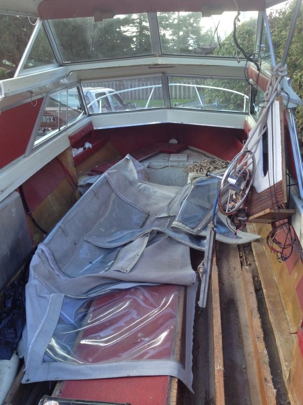

The interior is striped and the stringers are not rotten at all but have been cut in some strange places.
The canvas is in rough shape by will keep the bows and adapt them to mine and can use the existing canvas as a template.
I REALLY want to keep this one. REALLY! But have no where for it and it's more work then I'm willing to do. I am heading back to school for degree number 2 in sept. So I need to be realistic. I will take what I need from her and then unfortunatly it's a trip to the dump.
And the main reason I bought her.

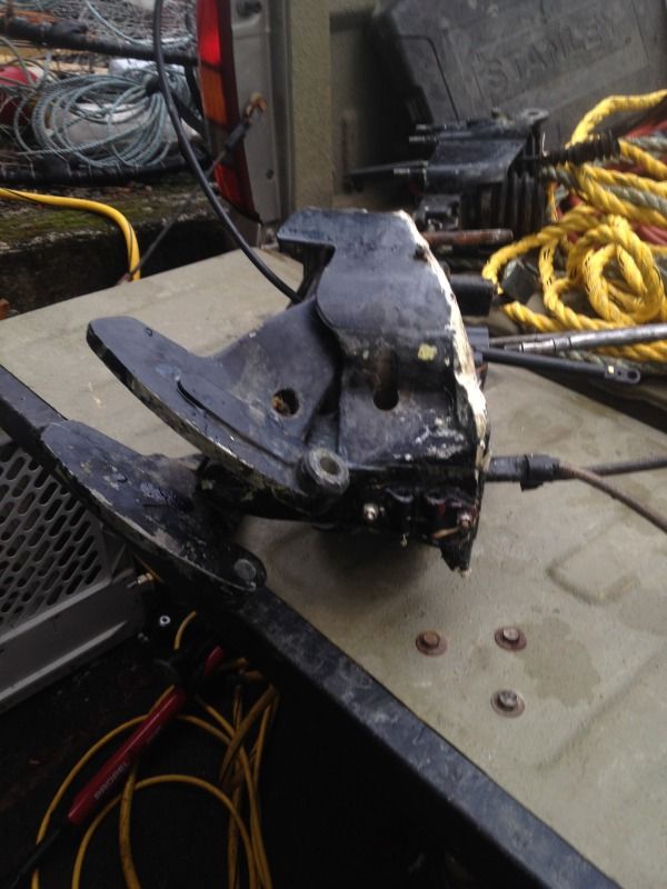

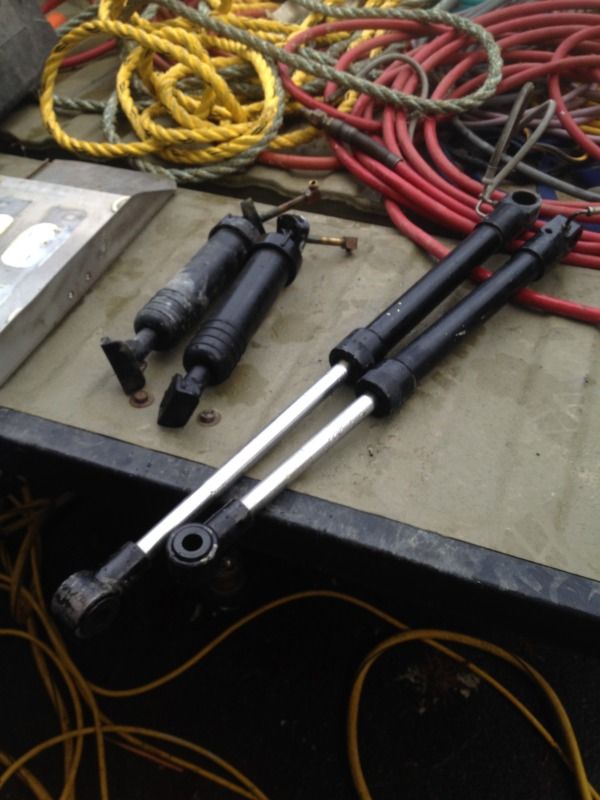

351
All the pumps, trim tabs, rams and everything are in better shape than what I already have.

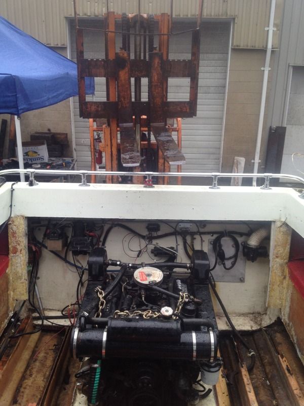

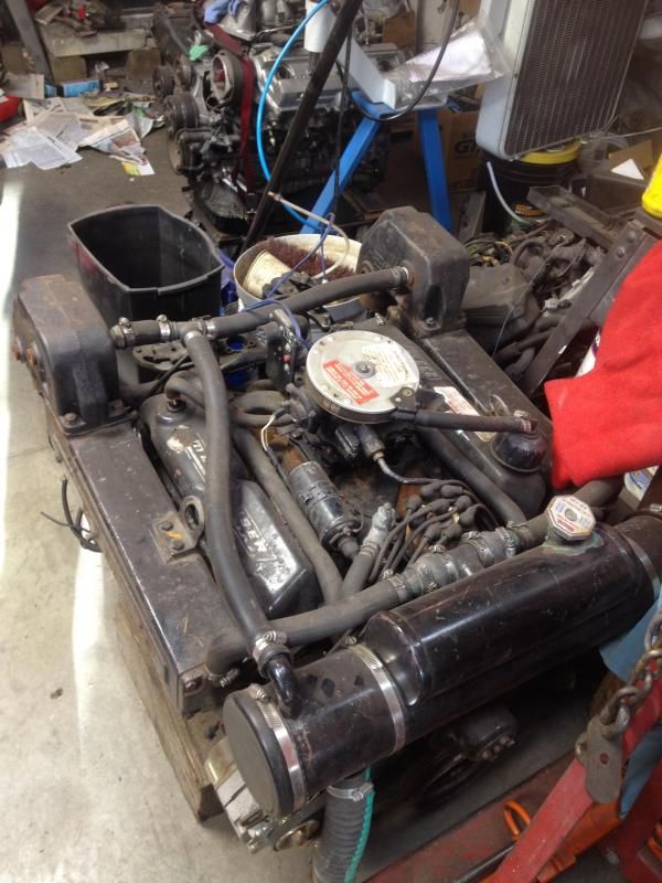

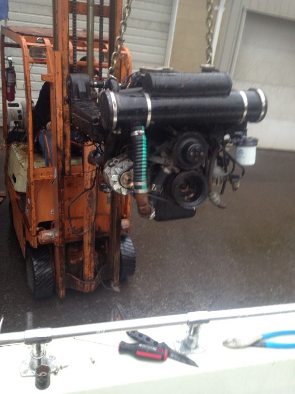

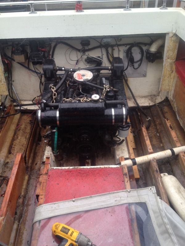

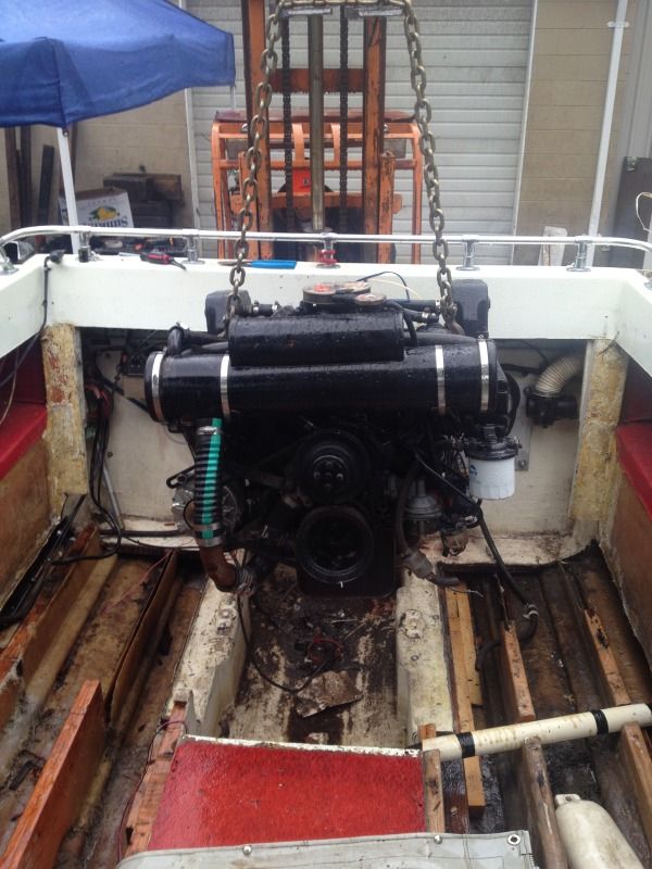

So I started stripping out the 21' GP for the motor and stern drive. Also took all the electrical pumps rams ect ect. It was raining like a mofo! Where has been amazing for the last 3-4 weeks and then the day I wanna work on the boat. BAM!
Motor came out like a dream. Done in 20 min.
I'm looking forward to this beauty! To go from the 150 ish hp of the 470 to some 300+ I'm gonna get out of this 351 I'm loving it.

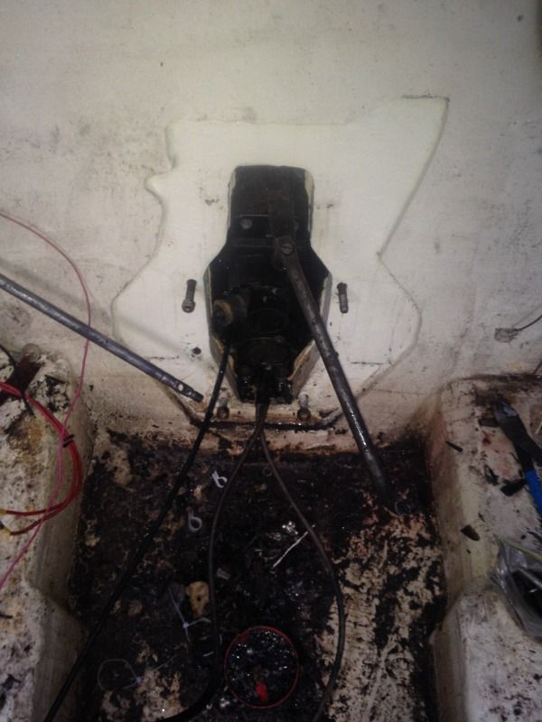

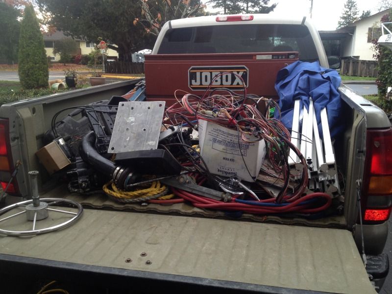

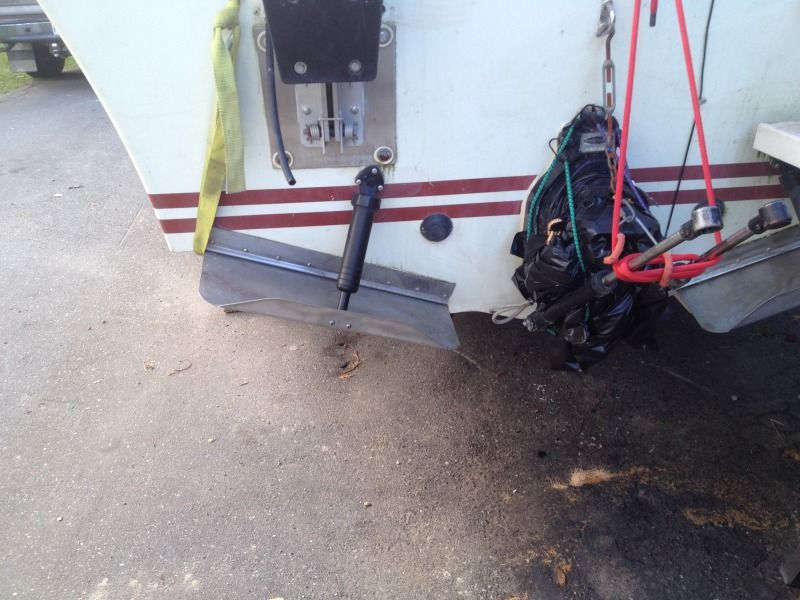

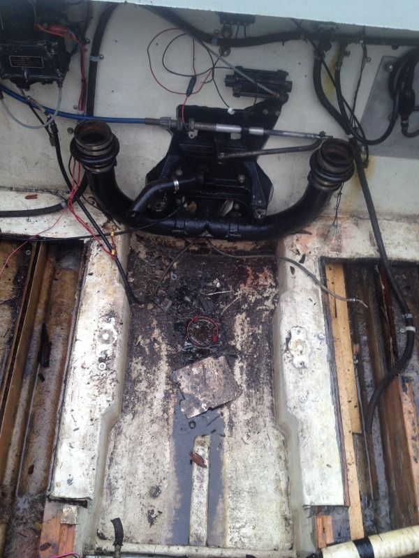

Now the rest of it. Well that took more than 3 hours!

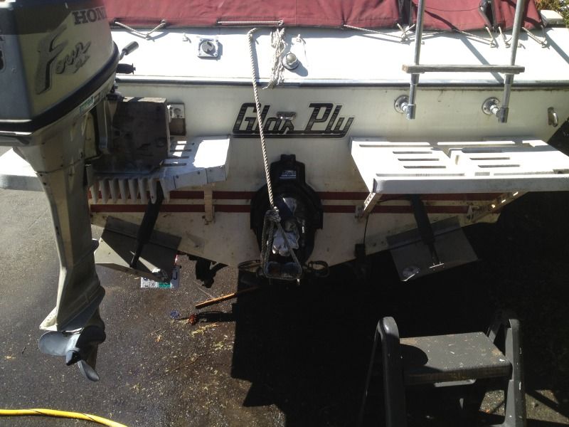

Got the transom plate off
Any body use this on their boat? I don't think the 19.5' has it?
Lucy found some entertainment
The gimble house was quite the challenge to get off. But we made it happen.
Loaded it all up and ended up with a good score. Stripped as many stainless steel fasteners as I could.

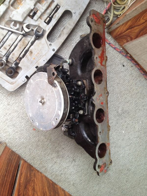

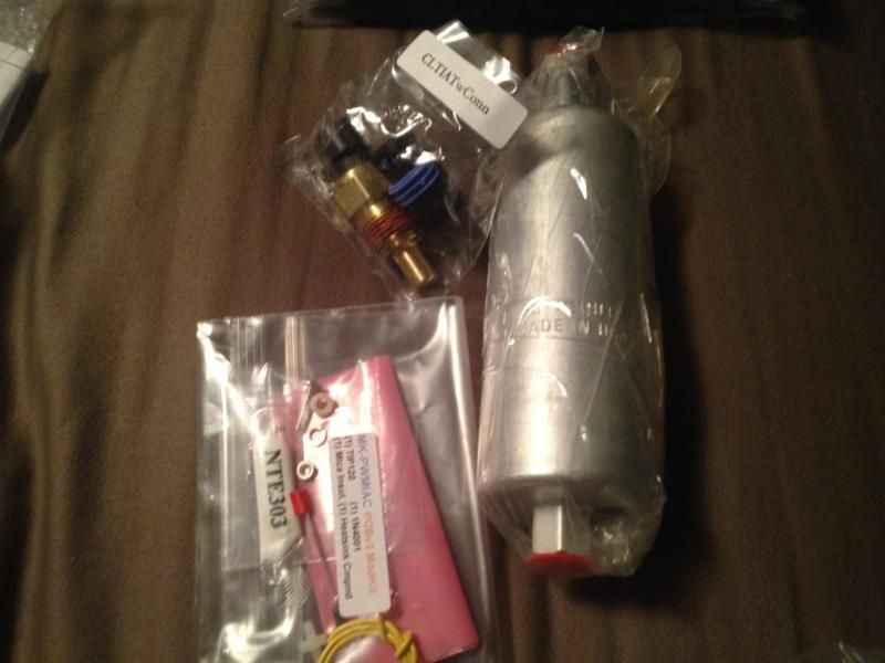

i went up island to my parents place over Xmas and took my 19.5' and the donor motor up. the motor now has a nice warn heated shop to sit in instead of under a piece of plywood in my driveway.
Some of the old 302 EFI parts we had previously collected some young guy bought as he was swapping his hi mileage 351 for a 302. we gave him all the 302 EFI and intake parts in exchange for his entire 351w EFI. so now i have all the EFI parts as well. Santa must of also heard i was working on my boat because he brought me a bunch of goodies.

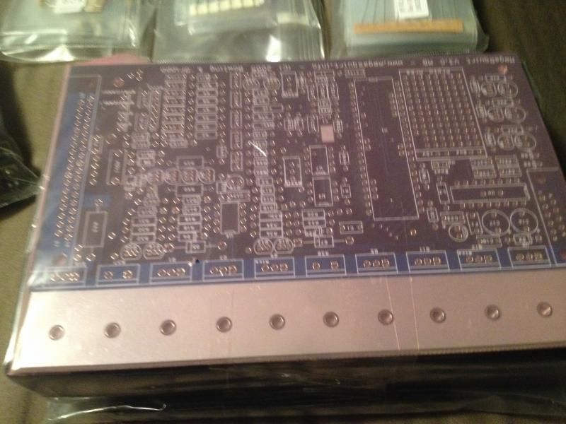

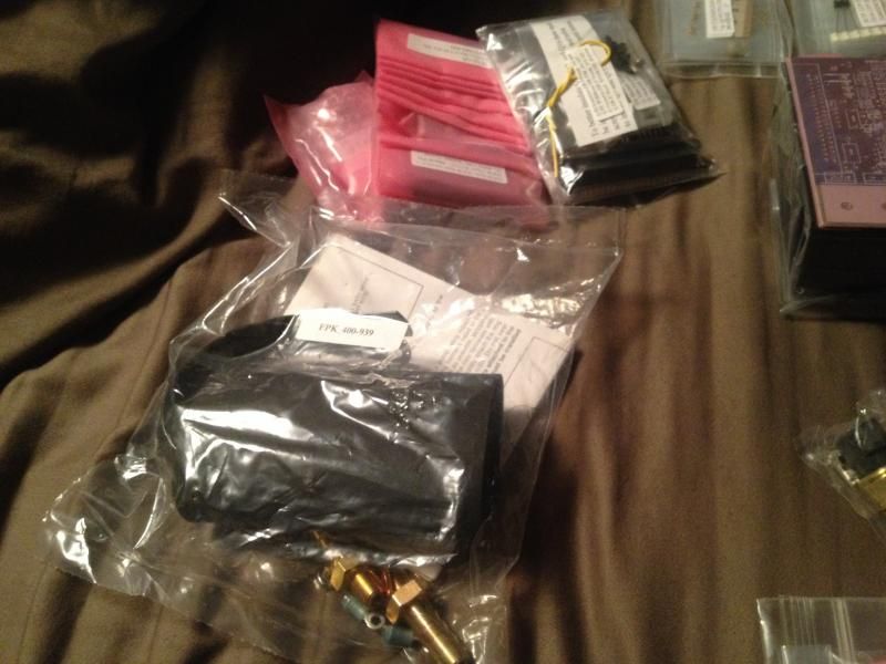

Mega squirt stand alone ECU (some assembly required) just kidding. alot of assembly required!
and a Walbro hi pressure in line fuel pump
Now i am not even going to pretend i know anything about this ecu and building it. this will be the 7th vehicle my dad has done with this system. we did my old truck. a couple of super charged lexus's, my brother old toyota, his master craft ski boat and now my boat. the tune will be extremely easy as we have the previously saved tune from my brothers boat. mega squirt has many baseline tunes available for download with their software to get pretty much any engine at least running. the tune is more or less up to you from there. can be done on the fly with a laptop in the diagnosis port of the ECU or taken to a professional engine tunner or buy a custom tune based on your parameters from a 3rd party company.
these ECU are also self learning with a wide band O2 sensor. we were able to weld in a bung into the exhaust side for tuning but due to reliability and welding to the cast exhaust we swapped it out for a normal one after the tune as for fear of the weld cracking after repeated heat cycles.
so in the next few weeks my dad will assemble the ecu. solder all the resistors and transistors and enter the matrix and what other fancy smart words on can say and get it done. ill be sure to post pics of the assembly process. after that it will be fitting a wide ass 351 in place where a narrow 470 used to live.

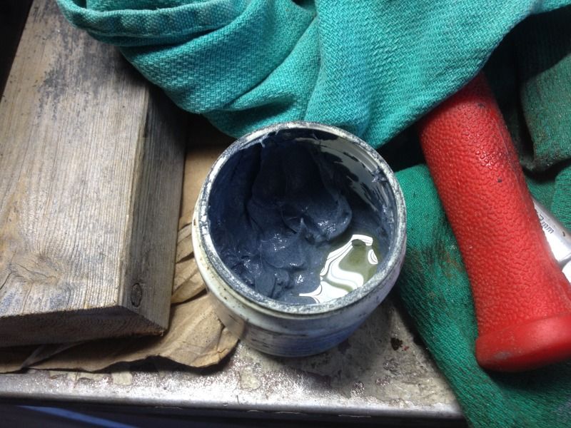

[haven't found any marine grade anti seize yet by will address the issue before she goes into the salt.

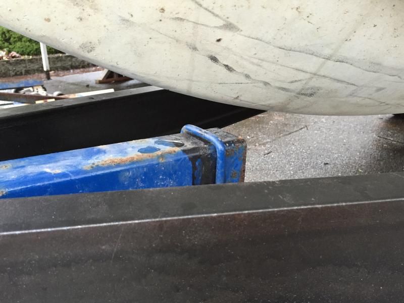

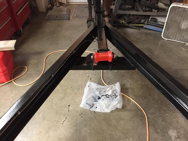

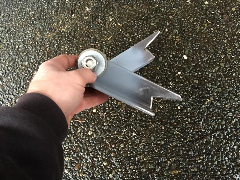

So back to the boat. The bottom of the hull it quite close to the end of the Tounge and on some launches it looks like it will make contact.
So I fabbed up a roller
And set it in place. Launched the boat again so I could faster the bunks and finish welding

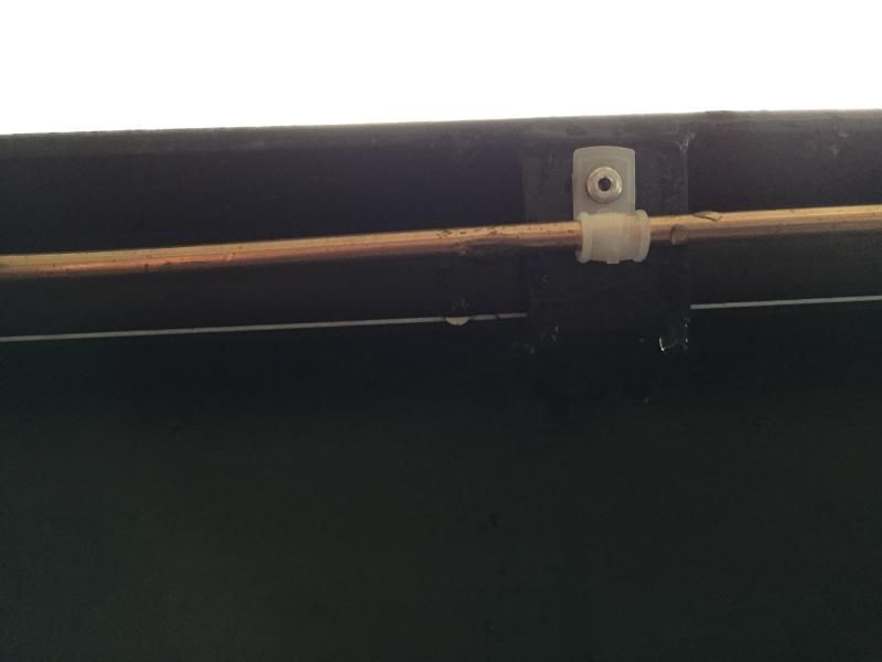

Fastened all the stainless brake lines
