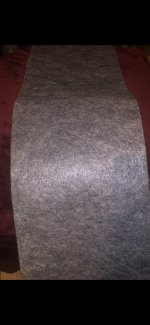

Hello, My name is Camden and I have just purchased a 1987 StarCraft. The boat is 16ft long and all aluminum. My current plans with the boat are as follows
*Strip out floor, replace with new floor
*Reinstall CC and add switch's to control everything
*Install Rod holders, Led lights, Bilge pump, Radio+Speakers, Nav lights
Most of this project is to just keep me busy for the spring, as for where I live I wont be able to start this project until the snow melts. I currently am coming on here for help and ideas. I know i need to replace the floor as for its all warped and falling apart. But my current problem is what should I do to protect the plywood flooring. Reading and doing some research leads me to believe for my saltwater adventures i should go with Marine Plywood, instead of just exterior grade. With the wood chosen i currently cant figure out how i should treat the plywood, some say marine epoxy it then coat in fiberglass. As others say just use a paint and primer, and then you can also just epoxy it and paint it. I do not mind fiber glassing the boat floor but I would like to keep a tight budget on the boat. Also would fiber glassing the floor make it to heavy for my little 16' aluminum?
Besides the flooring issue and not knowing where to go with that, I have a problem with wiring rocker switches. I would like to run everything to a fuse panel as well as a battery switch but how would i wire rocker switches to a fuse panel. I guess i could get a panel that has push breakers but would it be worth it or is a separate fuse box better. If someone could help explain how i would wire this together that would be great.

Good tips for the wiring, diagram definitely helps. I have a vinyl flooring for the boat but I'm unsure of its durability. The boat is going to be used heavily for fishing and lobster fishing. I originally planned on install snaps so i can remove it if needed. Do you know if after using the varnish you weather or not you can paint it to add texture? I was told to seal the wood then paint.

Well the spar varnish is oil and solvent based, it will soak into the wood.
I would suggest that if you paint it, to use an oil based paint for adhesion.
Not a paint expert so don't know if an acrylic or a latex would stick.
Not sure paint will add enough texture to be slip resistant. Hopefully others will chime in with their experienced advice.
Don't know of any vinyl that would hold up as a removable item.
There are several synthetic / vinyl flooring materials on the market now.
KIWIGrip is a paint on, not sure if it will stick to spar varnish.
Some will cost you $250, others will cost $1200.
SeaDek is great, cost you about $600
Some are very durable while others are not ( deco-dot )
