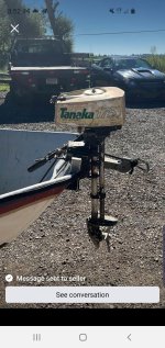

Looking at buying a Tanaka motor off facebook marketplace. First of all can anyone identify it from the picture and point me toward a manual? Secondly the seller wants $50 for it. They were originally asking $100. The description states "Pulls over but hasn't been started in years. Ran good when put in storage." The seller said I can do a compression test on it. Is this worth messing around with? If so what else should I check besides compression? This would be the perfect motor for my canoe if I can get it to run.

Yes for $50 they are decent. Not all the parts are available but you’ll be able to make it run

I’ve been running Tanaka 3.0 since 1983 on my canoe…they are dead simple motors to operate and repair if needed….IF you can find parts.
For $50 go ahead and buy it….it’ll most likely run for years.

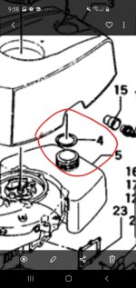

Tried to start it after sitting overnight with a full tank. It started for about a second then shut off and wouldn't start again. Looks like the fuel line from the gas tank is pinched off. I just noticed the circles ring in the exploded view I'm posting is missing so the tank is sagging down possibly causing the fuel line to be pinched. Do you know where I can get a replacement ring or something else that will hold the tank in place. Also do you know where I can get an air filter as it appears to be missing?

Replace all old fuel lines with some clear/ green colored lines from the chain saw store….also replace that pet- **** with a plastic, chain saw type.
robert graham
Apr 16, 2009
6,908
Also, use some very small zip- ties/ tie-wraps to secure ends of fuel line in place of those little clip rings that are prone to corrosion….another item, a small in- line chain saw type fuel filter will keep junk out of your carb…

Also, no air filter on these motors….just that little plastic elbow type air intake to keep rain out of carb…
