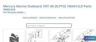

it’s not looking like it has one just connected to block no head or am I wrong ?
