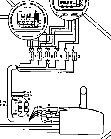

Tachometer connection for power, ground and tachometer signal will look something like this.

Ok, so if I just use the 10 pin wire harness I will have a warning horn for the low oil and over heating. I would still like to use the gauge for a tach so I know what my RPMs' are. I guess I will just hook up what is obvious and see what I have working on the gauge and go from there.

The black wire, the green wire and the yellow wire will give you RPM information on the tachometer.
Other wires are used to for the oil status lights. I don't think that vintage tachometer has an over temperature light.
