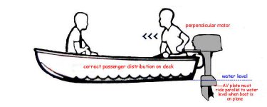

Playing with different manual trim hole settings won't dial any improvement,
when the combo runs on plane the motor needs to work trimed at 90 deg on transom along a correct deck load distribution for a nice water performance. But if the motor is powering way high on transom will cancel any trim setting...
