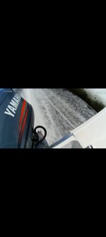

Tried it 1 hole up (2nd hole down from top). Big improvements but still didn't see cav plate in video. Wound up moving it up another hole ( 3rd hole down from top). Cav plate visible in video. No prop blowout on turns. Only thing is I noticed a v spray of water out to each side of the motor when on plane. This v spray was actually bigger on the higher positioning of the motor. Was less when I was 1 hole lower but no cav plate to be seen. My boat has about 7 inch setback for the motor to mount. Looks like the ribs above the cav plate line up more with the bottom of the setback maybe that's what's making a bigger v pattern? I guess I'll leave it in the 3rd hole ( higher position) and not worry about the v spray?
1st pic is 3 holes from the top. 2nd pic is 2 holes

So I'm thinking the v spray ( v like spray coming from each side of motor) is coming from that ribbed section above the cav plate seen in the front of the outboard. With the motor mounted in hole number 3 during testing the v spray was worse then when mounted in hole number 2.
For this discussion mounting holes are 1 through 4 with 1 being at the top.
Couldn't see cav plate when on plane when mounted in hole # 2 but less v spray. Mounted in hole 3 cav plate now visible on plane but v spray worse. So live with the spray and leave it in the higher position where cav plate is visible or lower it down for less spray but cav plate not visible? For testing it was me by myself and about 25 gal fuel.

when the cavitation plate is above the water, I do not see how anything above it would be causing water spray.
if you really want to know for sure take that sacrificial anode off and run it to see if that makes it go away.
might check on props that have more stern lift,
I would think taking off the foil might cause even more problems with proposing.
have you even run the boat without it?

Hole 2 when the cav plate/foil was not visible is definitely too low. The hole 3 position looked pretty good and if the prop did not wash out when you turned, then I would say definitely do not move it lower than 3.
I tried it without it and it was worse. Lot more bow rise and more sensitive to porpoising.
Thanks. Yeah no prop wash out. I took tight turns without an issue.

Seems strange that the anode would cause a bigger v spray at the higher engine mounting position? Do you think maybe the water coming off the bottom of the hull is deflecting off that ribbed section of the motor?
99yam40
Sep 7, 2008
9,295
how does the water get to that if it is not getting to and going over the Cav Plate
take it off to see for your self
