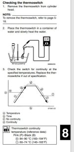

Check first posted pic, shows where the Temp Sensor is located, when a different temp is detected triggers a signal to slow the motor down as not to overheat it, Don't know if that operation could be called a Safe Mode or not, will check with the Service Manual how it works and what it's called for a better tech understanding. Saturday plan going for a 100 Km water raid, hope all goes well, fingers crossed well in advance LOL!!

That motor does not have a limiter or safe mode. The temp sensor when it reaches about 190° turn on the overheat lamp.

I don't think that Yamaha has installed such an extremely primitive system on ithis nice 85 HP Enduro B model which is a Commercial work horse, a loud buzzer would have been much better to hear than to see in plain daylight. Have seen none of the tiller or remote versions to have been factory delivered with such overheat lamp nowhere on the cowling or motor's front and guess what, fishermen don't use central consoles.
Although the Service Manual does mentions at which temp the TS acts doesn't mentions a thing if triggers an overheat lamp or the CDI whatsoever. Could not get a E85B Service Manual to check that out, the only one that could download from the net corresponds to the older 50G, 60F, 70B,75C, 90A versions which has nothing to do with the newer Yam E commercial versions.
Can you explain why after removing the temp sensor and cleaning it along its internal housing the motor is running great again at wot ?

Post the engine plate as don't see a 85B engine listed. And yes, I have the 85A manual. The pink wire connects to the CDI and triggers the buzzer or lamp for a overheat.

Don't know what have been smoking lately, the motor is a Yam 85 ATR. The motor does have an overheat warning device which activates if he temp is too high. The Temp Sensor plays with the CDI and lowers the max wot rpm the motor was revving at to around 2K revs/mim. In this particular case cleaning the TS and its housing curered the rpm reduction issue, the remote control box buzzer was found shot that's why never chimed in.
