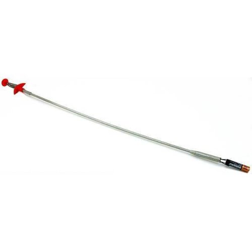

I don't see you being able to remove the Y pipe without removing the engine. If the drive is removed you might be able to see the piece and grab it with something like this
