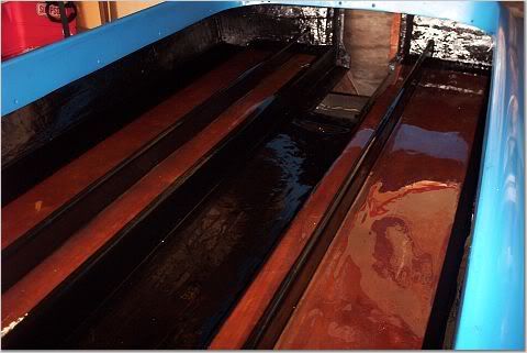

Ok ... termanology aside :rolleyes:. Maybe some pics will help.
What I have . It does look better when its wet or with a fresh coat of resin on it , but you can still see the fibers in there :( .
What I want.
How do I make mine look like the second one ? Do I need to strip all the old glass off the wood and start over ?

Propless,No,No,No...don't be stripping off any of that glass,now,here?.If you want the look of the 2nd pic,you have to go over the existing floor with your desired floor,you start stripping off glass,and the whole thing becomes a major water sponge.leave the floor as is,choose the wood for the new floor,pre-cut to fit,on the perimeter off the old floor, glass in some brackets to hold new floor(so your not penetrating original floor) varnish the heck out of it,install,and buy yourself a good pair of deck shoe's,as it will be VERY slippery when wet.Thats about the only way to accomplish your task without causing potential wood rot down the line.Good Luck Amigo.

Prop....By trade im'a General Contractor and have done extensive home renovations,So i'm very familiar with wood veneer's.....Not gonna work! surface is way to uneven,to use veneer surface has to be Smoooooth, the thinest wood i would try is Lauan, mahogany,its only 1/4 thick and will still show subsurface imperfections,or even 7/16 hardwood plywood, thicker = better.

the glassed in sole of the boat ........IS STRUCTURAL.....dont fuss with it......esp with a jet boat......that purty deck on the other guys boat may be nice but yours is strong.....
what could be done is a series of wood slats (over top as suggested....make sure the water can drain) giving you a "deck" look...but beware......i dont care how much thompsons water seal on it......in three years youll be ripping it out......(stained , discolored, rot started.....generally ugly)....not to mention slippery
