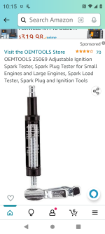

Well you now know you at least have a bad plug wire. You will need a multi meter and one of these inexpensive spark jump testers.

i was using a spark jump tester. and i have a multi meter. i am researching what to check next. i am thinking stator is problem because i had a problem with the motor not charging the battery a couple of years ago. I changed the battery cables. have new plugs. guess i will need to look for cables. I'm about to start checking with multimeter after lunch. just trying to find procedures.
