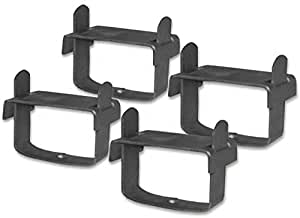

I now know what those metal straps do in a leaf pack.
I found some online. But they look a bit flimsy like for a small utility trailer.
I will keep searching.

Maybe some 2 inch by 4 inch steel bars, bent in a vice with some heat to form the "C" shape required....
