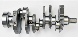

the 4.3 also has a really bad firing imbalance (look at the crank throws and you get the picture. this is tied to the cam comment above
while you can get more RPM out of a 4.3 with a fat wallet, by the time you are done, you spent more than a SBC that will spin 11,000 rpm or big block that will spin 10,000 RPM
case in point:
a forged crank for a SBC or BBC is about $400
a forged crank for a 4.3 is $4000 https://www.crower.com/crankshafts/crankshaft-4340-billet-chevy-v6-specify-stroke.html

Ayuh,..... Kinda a fragile crank,.....
The boss hit a shoal in '06, 'n broke the crank in two,.....

That was the solution GM came up with for the shaky Buick 231V6 with the 90* angle between the cyl banks in about 1975/6 when they bought back the tooling from AMC. They used it for a few years sold it to AMC who used it in the CJs then bought it back after the 1st oil embargo. So when Chevrolet created their 4.3 V6 from the 5.7 they did the same thing. My wife had a ‘78 Pontiac LeMans with that 231 V6.
53,151
I have broken buick cranks in a few motors I built over the years...... if you dont break parts racing, your not trying
